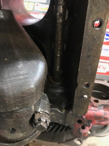

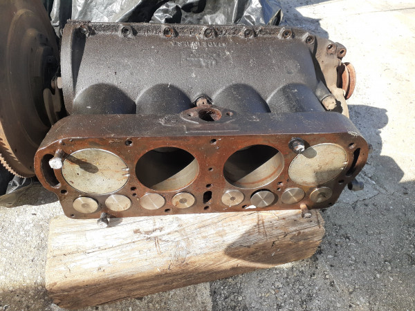

There was a recent thread about putting a Model A crank in a T. I am particularly interested in this thread because I recently acquired a 1913 Touring that is an incomplete project. Someone abandoned it many, many years ago. I don't have much info about its history. The block is a 1920. It is an assembled short block with a Model A crank. It appears to be a quality job. There is no carburetor or ignition, but a DU 4 mag came with the purchase.
I would like to stay with the original Ford coils and mag system. I am interested in feedback and suggestions from anyone who has knowledge and experience in this area. My goal is to end up with a good, headache-free engine that has more power than a stock engine. As this thread progresses I can go into more detail.

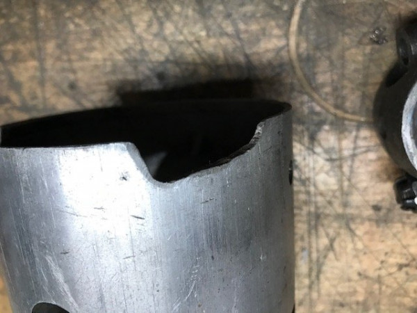

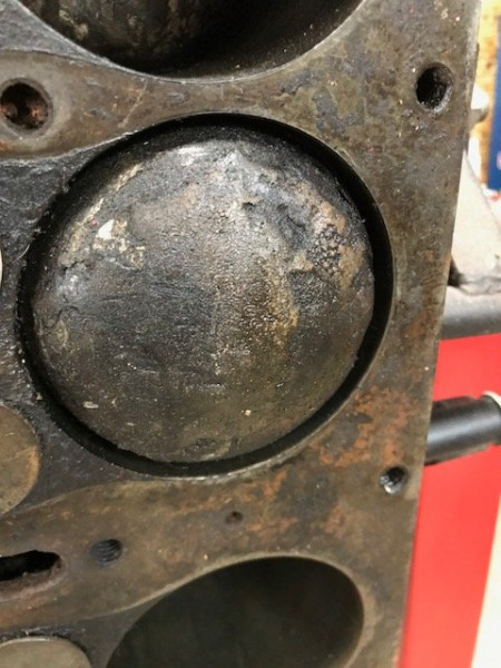

It looks like a great start for a strong motor. The extra 1/4” of stroke will add to the compression, but those flat top pistons have got to go! The loss of the dome will reduce compression unless you are prepared to take drastic action with a cylinder head.
The crank is shortened, so should drop right in a pan. But I would recommend taking the flywheel off and looking for a weld on the end of the crankshaft. Many cranks that were cut down many years ago were only welded in the journal radius, and are prone to breakage. If you can see where the flange registers in the crank, I would groove it out and lay in a really hot TIG weld with stainless steel filler rod. Have done this before on a crank that broke, and it’s still running today!

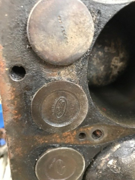

Most likely those are 292 Cu In Ford pistons. If so, you will probably find that the rods have been cut and welded to shorten them. Not ideal in my mind, as welded rods make me nervous.

That engine is going to cause you nothing but trouble. I suggest that you ship it to me so that I can properly dispose of it.

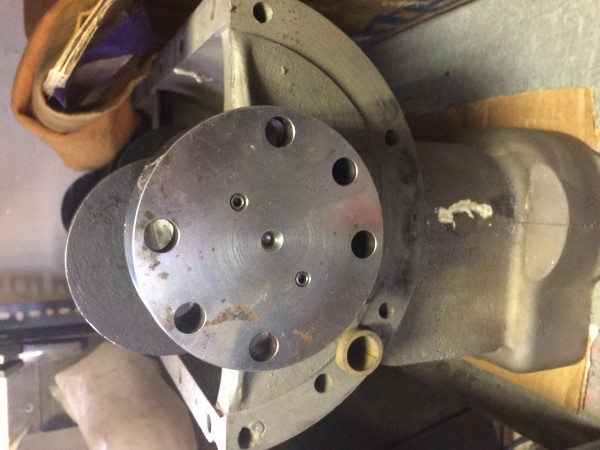

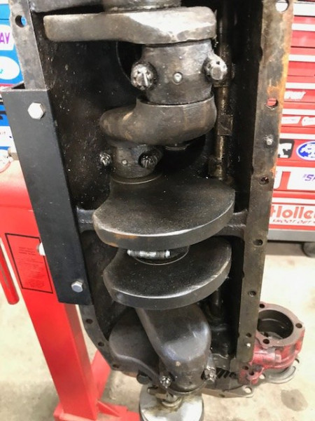

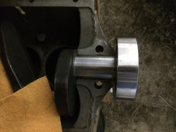

Here is another option for the crank conversion. I’ve used this method to fix a couple of broken weld jobs. It involves shortening the rear main.
The flange is 1” thick and taper bored and shrunk onto the end of the crank. After it is pressed/shrunk in place, it is machined all over.
So far totally successful and the babbit job was saved as well. Just required cutting of and refacing the back of the 3rd main.
Anyway just another option to consider.

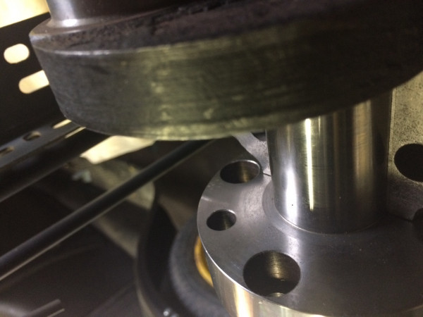

One more picture of the crank conversion

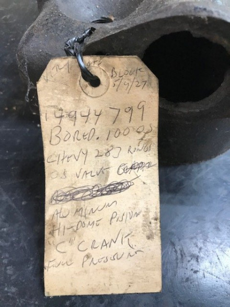

Joe
The tag says “C” crank. And I agree with the tag. You will see that I have posted the identical crank and install on another thread.
I acquired a very rusty C crank and it cleaned up nicely to standard A size. And considering that 1-5/8” main bearings is all that the T bolt spacing will handle!!

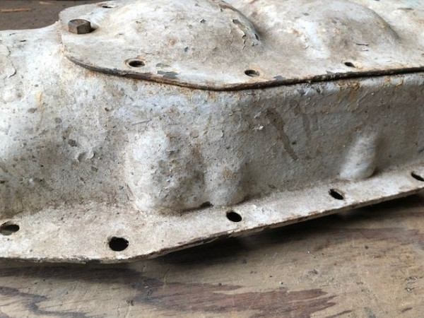

Is it possible to grind the "C" crank on an offset to gain a little more stroke as done with Model "A"?Les Schubert wrote: ↑Sun Nov 29, 2020 2:26 pmJoe

Chris

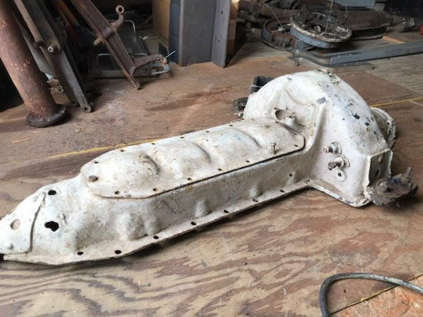

Certainly it is possible to grind the crank for more stroke. BUT consider that the A crank and rods just barely clear the block and require pan dents!!

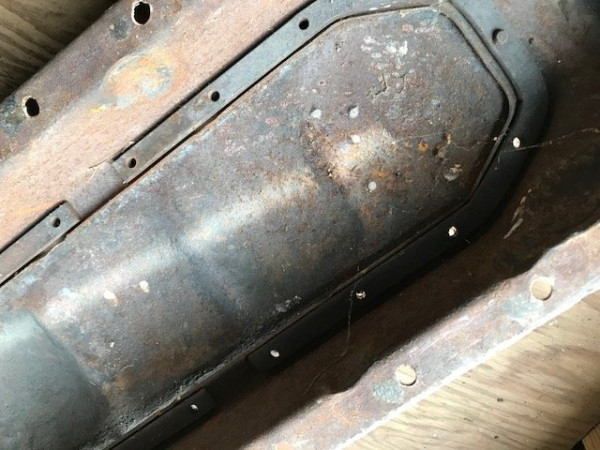

Pan modification shown. If you look closely at the previous picture you can see where the block is ground to clear the counterweights. Same with the pistons. Enjoy.
