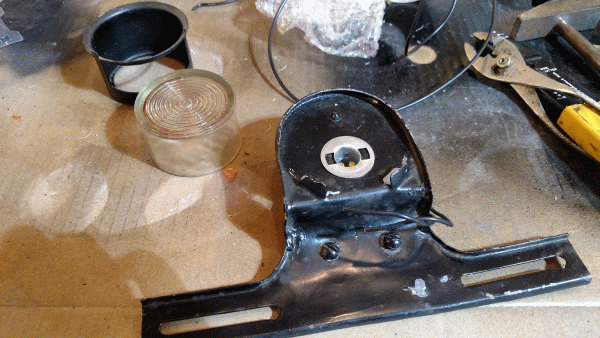

I restored the newly acquired light and license plate bracket and plan to put that on the left side. I'm going to cut the license plate bracket off the old unit and install it on the right side. I have what I need to mount the light but I need ideas on how to cut off the license plate portion without looking like a hack job. Can anyone share a photo of what they have done?
This is my new unit during it's restoration.

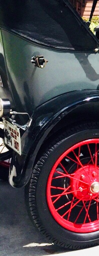

Can’t help on how to trim off the license arms, I left it in place and added a vanity plate to Dixie! Reads ‘I may be old...But still get hot’

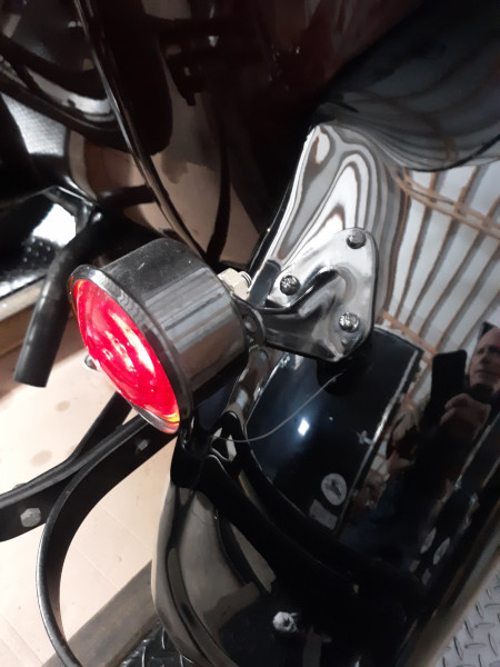

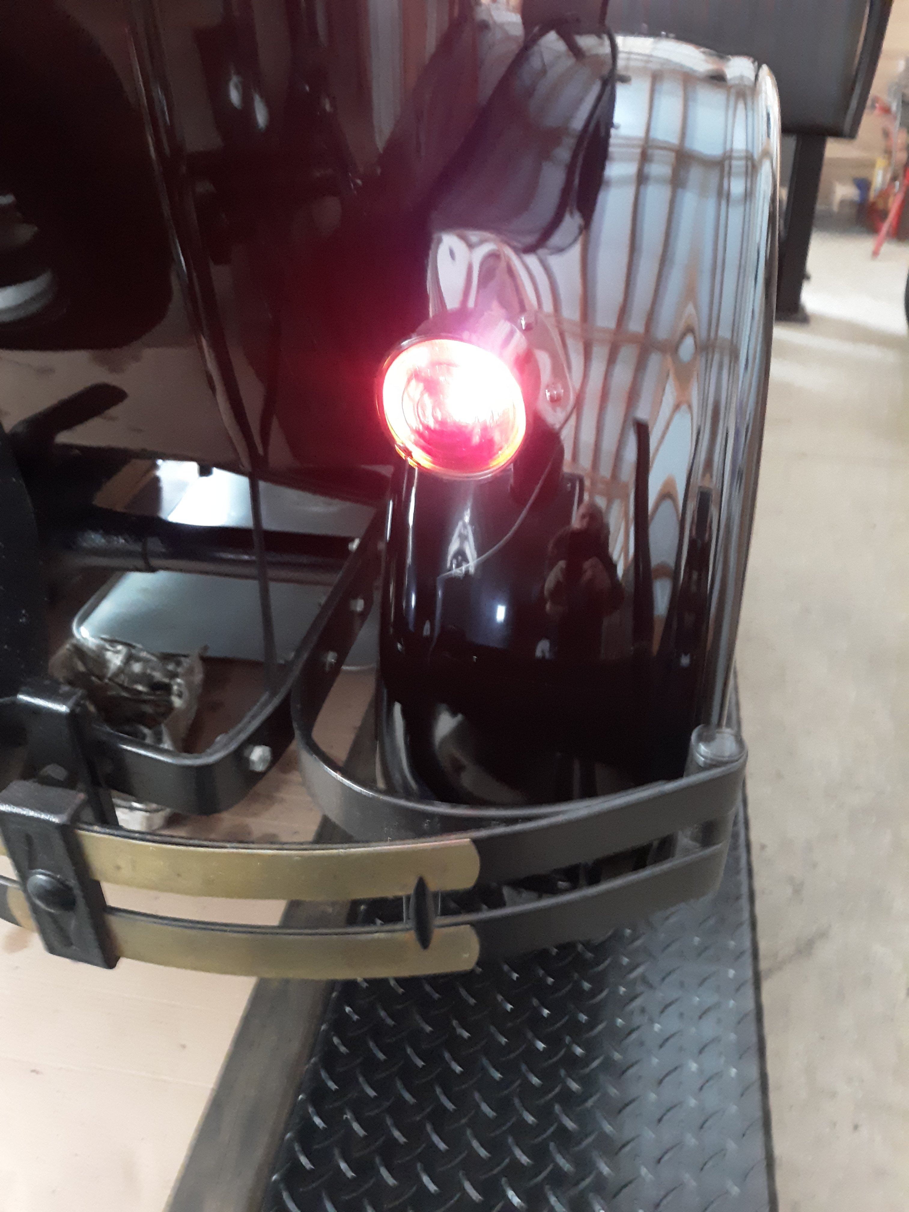

Re: How did you modify an Improved car tail light bracket to work on the righ hand side?
Good advice John, altho I elected to use smallish fender washers instead. Finally had to head out to the barn, so heres a pic of said right side lamp with the tail light on. You wouldn't believe how bright the brake light is!
