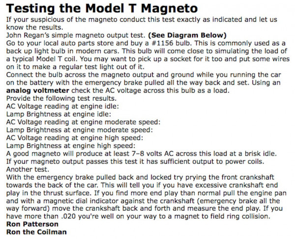

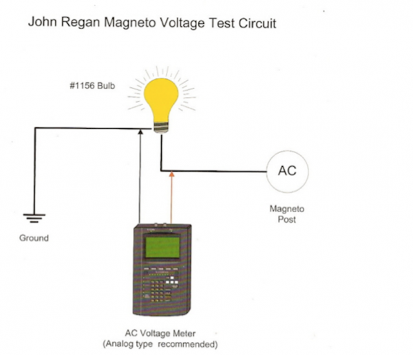

Yes, as long as you can run on BAT you can test the magneto.
As the car is already running on twelve volts I assume it has 12 volt bulbs and has the generator properly adjusted. If you're installing the stock ignition switch the stock wiring should work.
