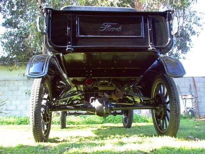

The spacing for the taillight bracket in 8 1/4", and halfway down on the crosspiece. That cross piece probably isn't on your bed if it's been converted to a trailer. If it is, the two top holes for the taillight bracket are already in it. There are two rivets holding it on, on each side. The holes should be in your bed now.
I had to have mine made from an original, as it had been removed. All the bends for this piece face the rear. This piece will automatically line up the bed to the back of the body which is only 1/4". I know I have photos of a bunch of my friends helping me install the bed. I'll see if I can locate them.

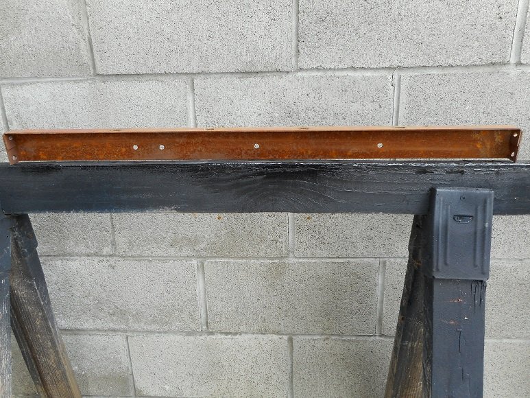

Re: '23-5 top irons question
I just found some photos of that brace or L bracket. I just had my computer switched from windows 8 to windows 10, so I'm not too familiar with what's going on now. As you can see the two left holes are for the taillight bracket. You can use your taillight bracket to locate the others. The two holes to the right of the taillight bracket are for holding the bed to the rear sill of the body. As I recall those bolts are all 2 1/4" carriage bolts, and aren't easy to find these days. If I can be of more help, just let me know.
I didn't read my post carefully enough. The 8 1/4" measurement I gave is from the left edge of the brace to the the center of the left upper hole for the taillight bracket.
I know Blue Lake is a long ways from Los Angeles, but I'm here to help with pictures and data. I built my p/u from original parts, so I was able to become knowledgeable on just about everything. The project took seven years, and no two parts came from the same car. My pickup box was a rust free original too, but had been converted into a trailer at some point, therefore, I had to have the cross piece duplicated that is pictured above. The wood for the bed is Southern Yellow pine. Gator Gould got me mine, but I discovered recently a commercial lumber yard downtown has it, and is used for scaffolding. You have to buy 4/4 stock, as the correct thickness is 13/16"
