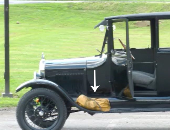

Quickly, let me say that last Wednesday, my wife and I, plus 2 adult passengers went for a rather long, rough, backroad ride in my '27 Tudor. Needless to say, 4 modern adults in a Tudor doesn't leave much room for extras, such as life saving essentials like tools, tow strap, first aid kit, etc.
So, to save space, I put my tool bag on the running board, held in place with bungees. It's been riding there for years. Somewhere along the rough ride, the bungees lost their grip and the bag unknowingly hit the road. So, its tool replacement time.
