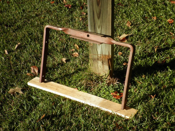

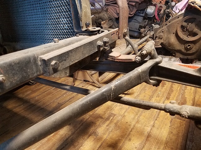

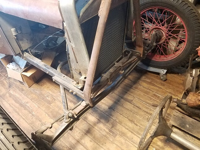

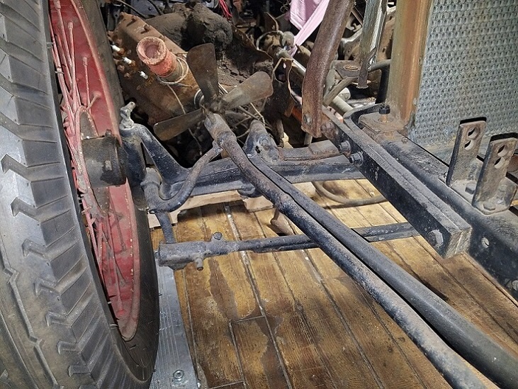

This Model T front spring perch is being offered on a hot rod site I belong to, he says it was sold through Lang's. Does this bolt to the outside of the frame or is the front crossmember removed and this fits inside of the frame? Tim in Omaha

Post by George House » Mon Dec 07, 2020 3:33 pm
I, ....er, ah,....don’t see a Front spring perch🤪

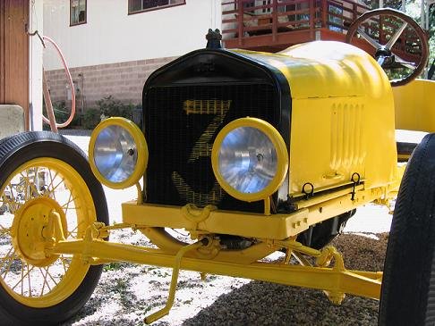

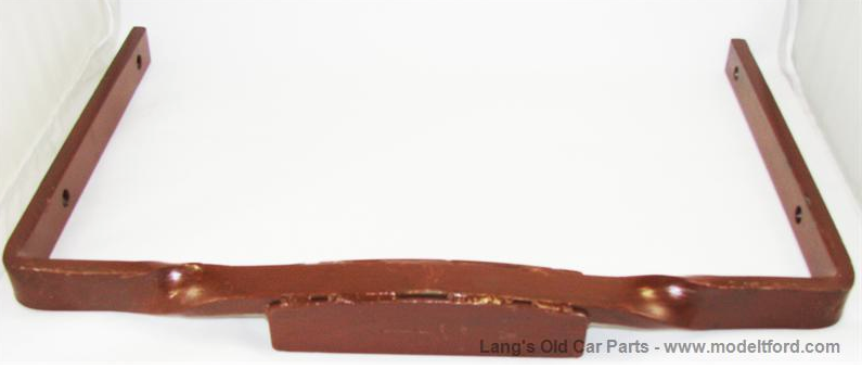

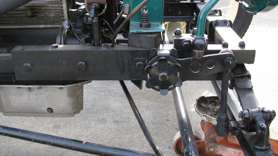

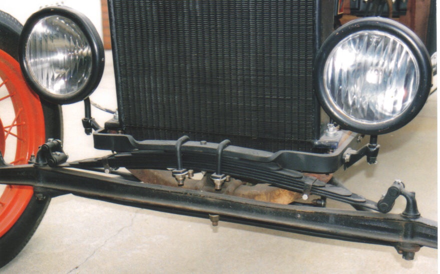

It bolts to the frame to lower the front axle (perhaps to much).

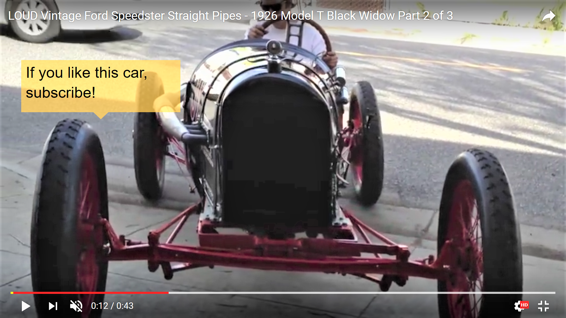

video https://www.youtube.com/watch?v=V7dni5Z-k2E

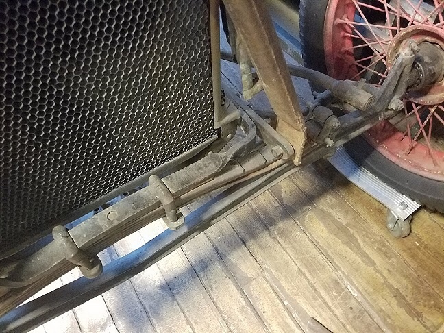

Some similar methods but not the only
Jnverted spring.jpg (62.85 KiB) Viewed 2366 times

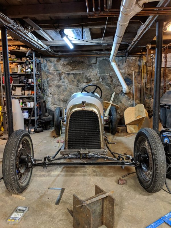

Super way to lower the front. The completely original Aldrich roadster is one of the oldest known surviving hotrods. Also happens to be at Lang’s! Wish they would get moving on it, they’ve had it a decade and it still isn’t running 🥺

Thanks guys, I knew it bolted to the frame, I just needed to know if it was to the outside or the inside and now I know. Pictures worked great. Tim in Omaha
