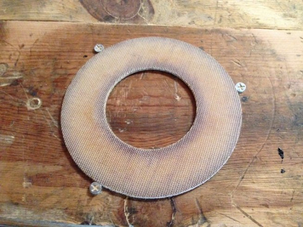

As Steven pointed out, a new Ruckstell fiber thrust washer is inexpensive and can easily be sanded to the needed thickness where the differential neither wiggles side to side nor locks up when the casing bolts are drawn down. I secured my fiber washer on a workbench, as shown, making sure the screws were below the washer surface. Then hand sanded using a block backing. The important thing to remember is to frequently turn the washer a bit to make sure it gets evenly sanded. Making the turns in random amounts insures you are not introducing a pattern. It’s a trial and error process checking the fit as you decrease the thickness.
