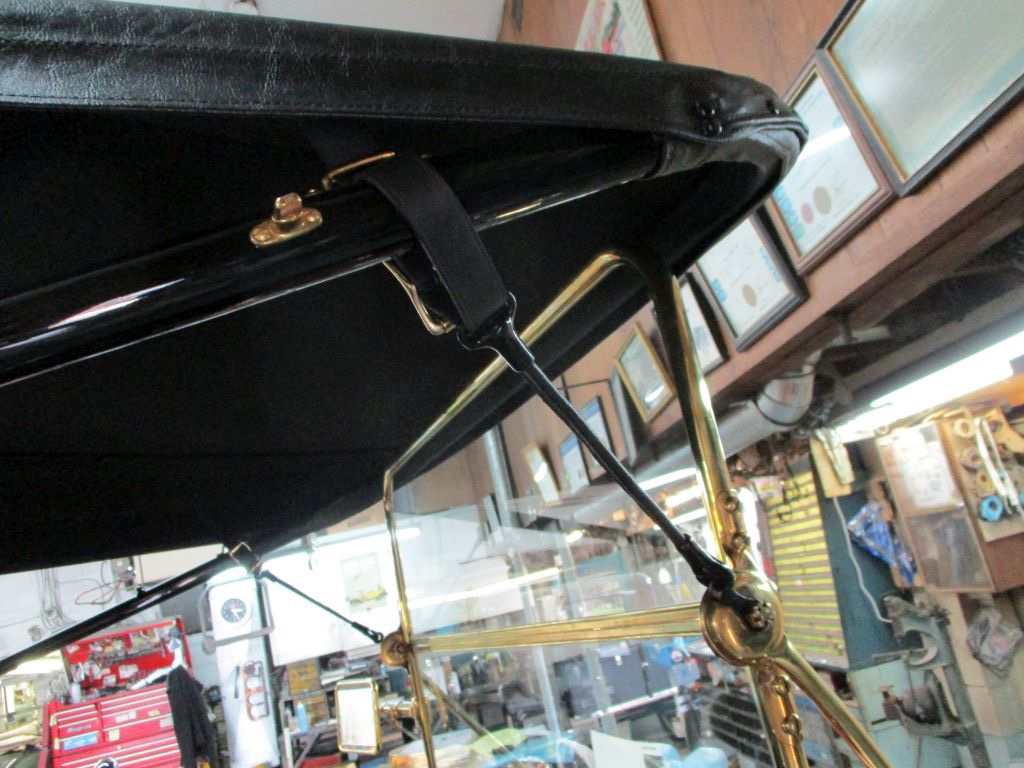

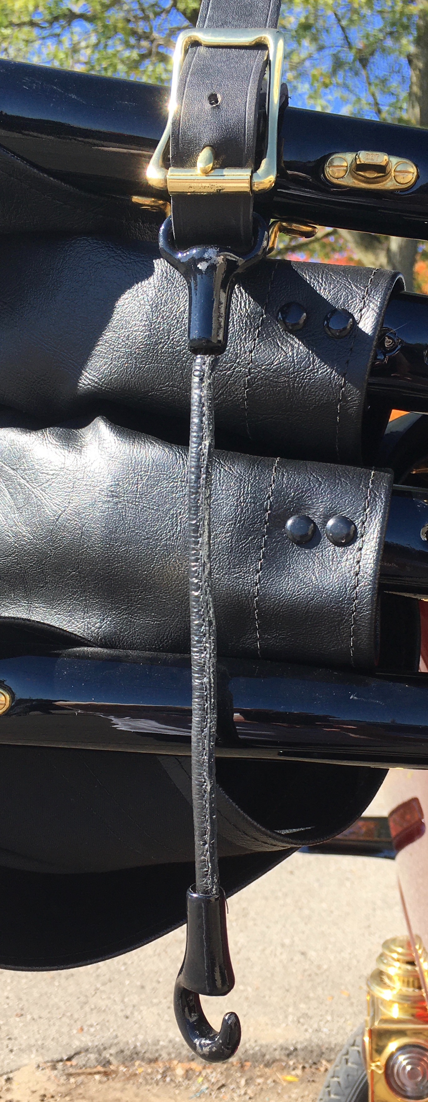

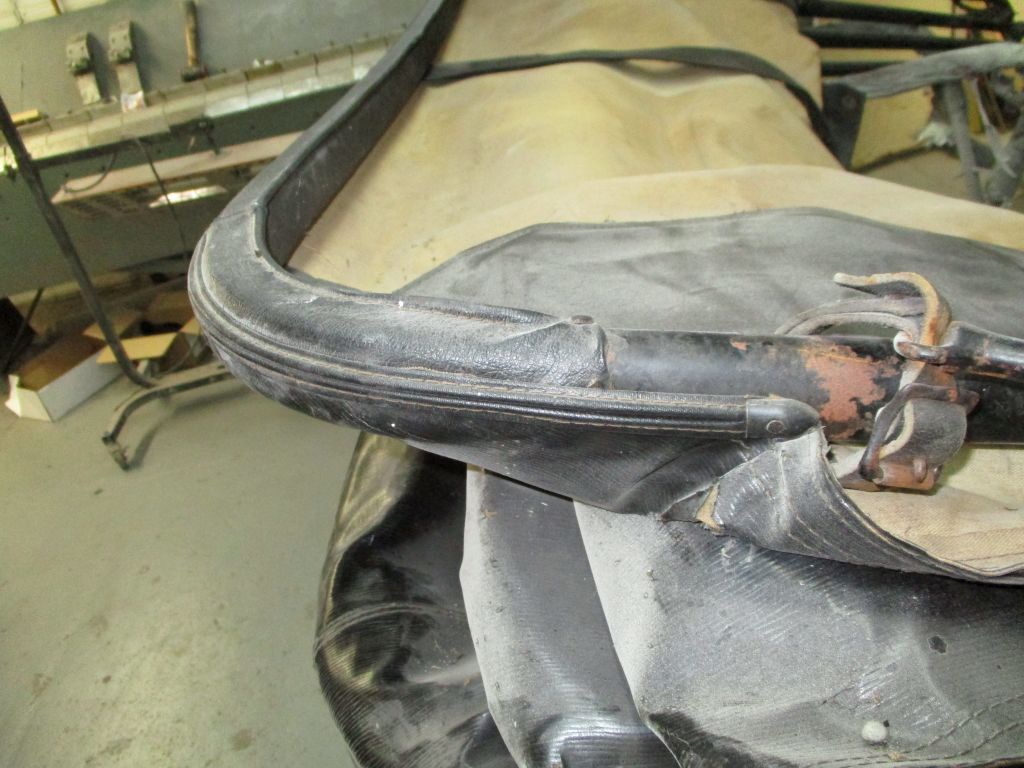

My question is has anyone ever seen this style of top strap before? They were original to my Canadian 1912 touring.
Even the restorer didn't think they were an original style until I came up with proof. Surely someone else must
have them on an open car from the 1912 era. Rather than being the usual short leather straps, they are a leather
covered braided cable with a cast hook on one end (that attaches to the windshield hinge top buckle loop) and a cast
loop on the other end that a short adjustable leather strap goes through. That strap goes over the front top iron and
is held in place with a footman loop.

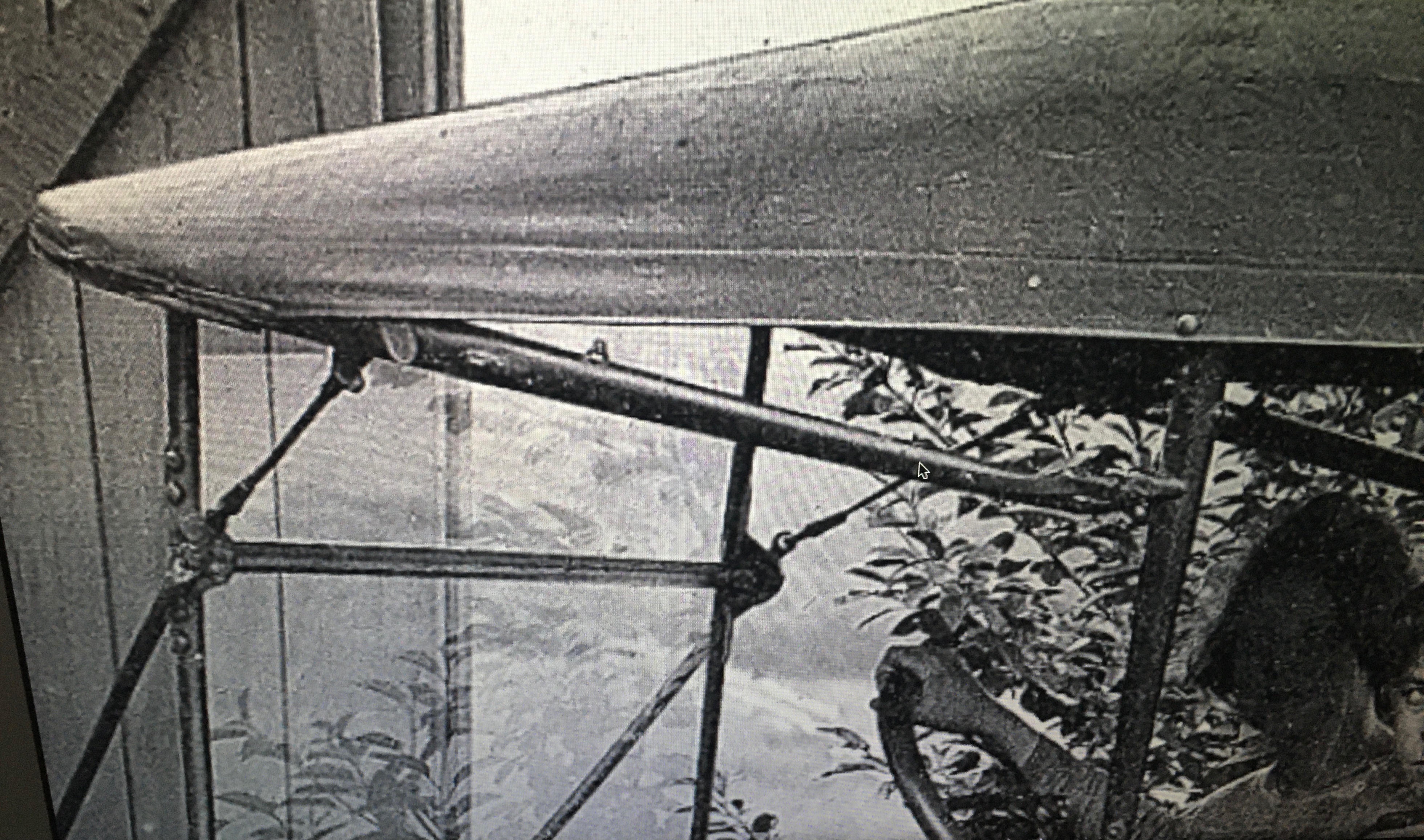

Here's my proof....and it's a great proof. This is a picture I'm certain most of you are familiar with.
This is a blow up of top strap on the car that Henry Ford is behind the wheel in.

Here's another picture showing the unique top straps.
Again a blowup of the straps.

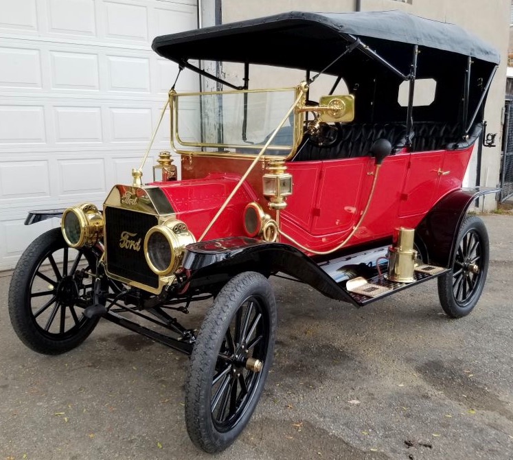

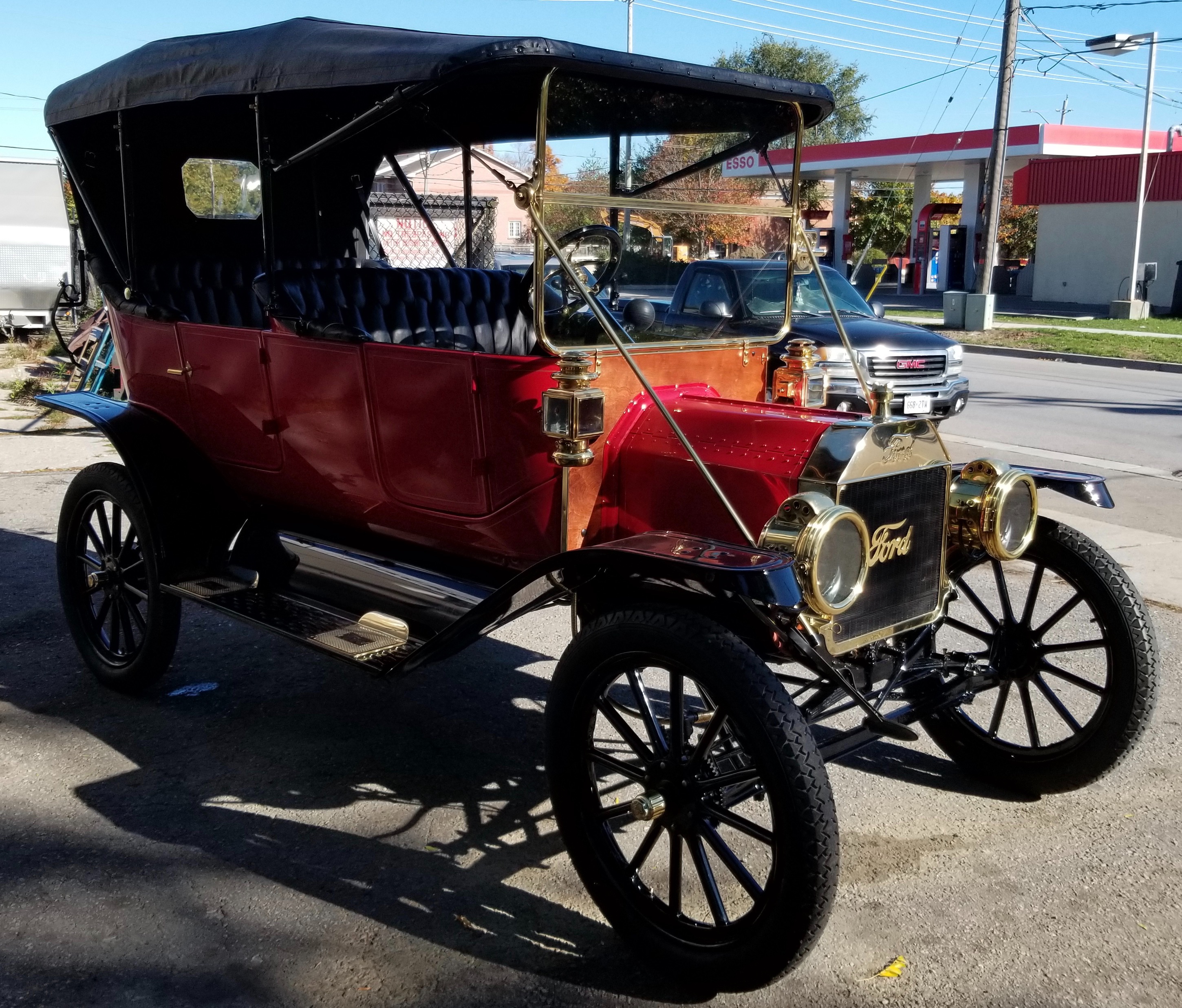

This is my '12 showing the straps. Note: the door handles have been properly put vertical after
this picture was taken.

Those were unique to to 1912. The late Ken Jones had the factory drawing for them and was over the moon when he found an original pair at Bakersfield.

I'm wondering about the buckle. Aside from not being brass plated, it appears to be the same one used on the '13 rear bow straps?

Post by John Heaman » Wed Dec 09, 2020 12:31 pm
The original buckles (which I have) are smaller and steel painted black as are
the original footman loops. I'm guilty of liking brass! :o. The leather straps
were in too bad of condition to reuse. Did I mention I like brass?? :lol:

Post by Original Smith » Thu Dec 10, 2020 11:32 am
It sure is nice to see a 1912 with doors! Most everyone in this area have removed them for some reason.

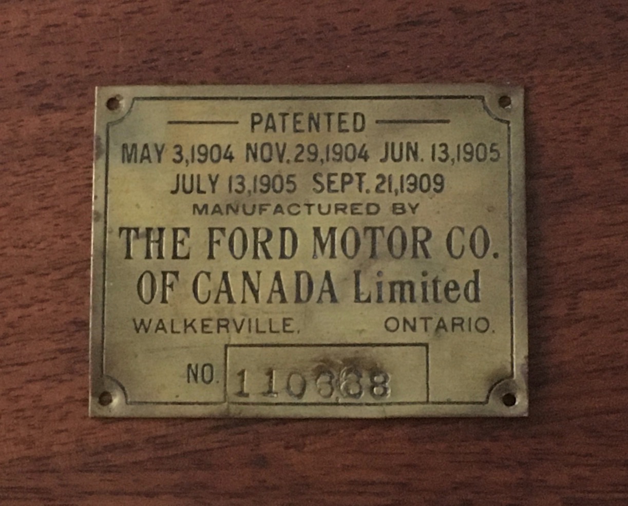

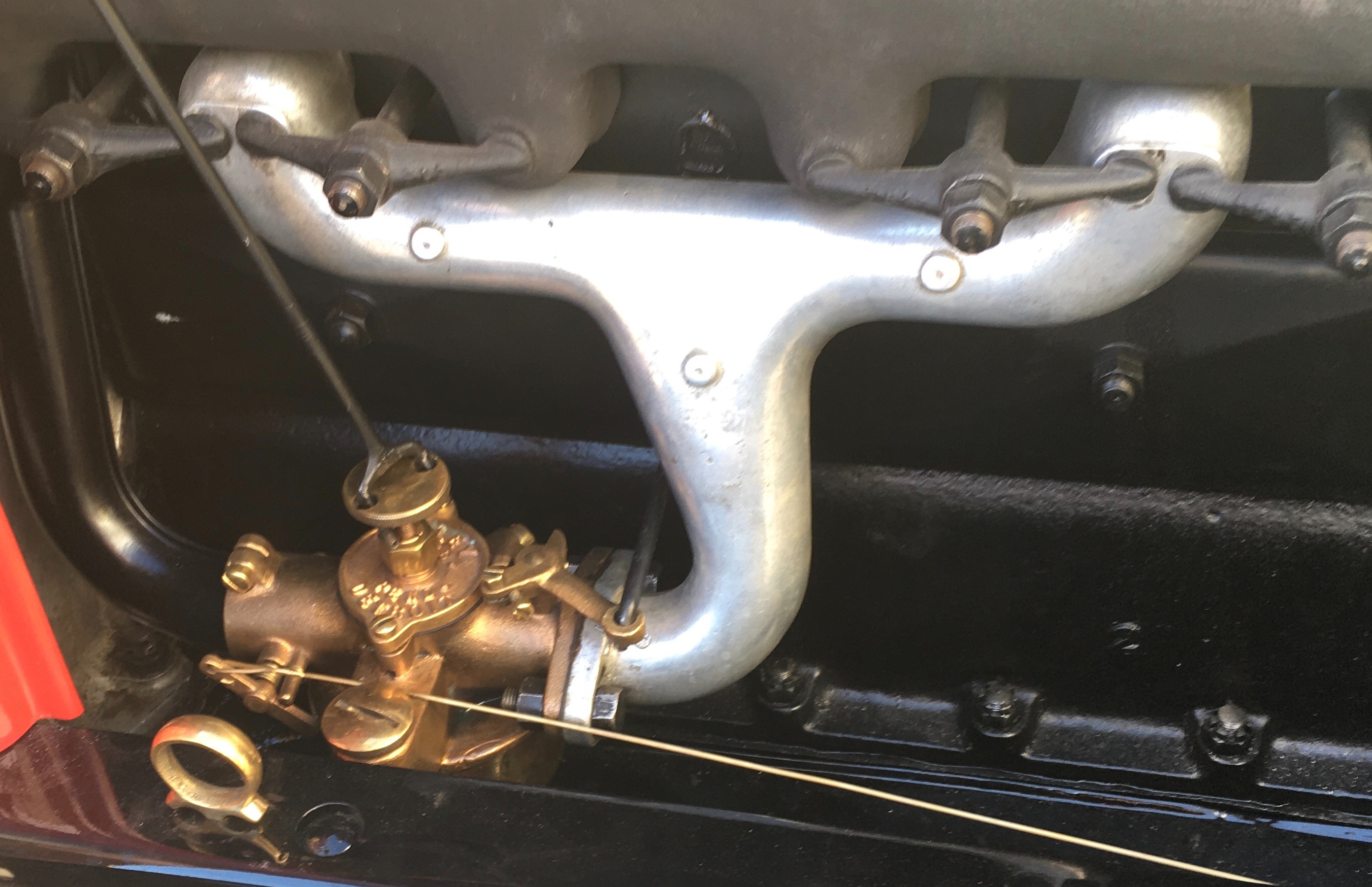

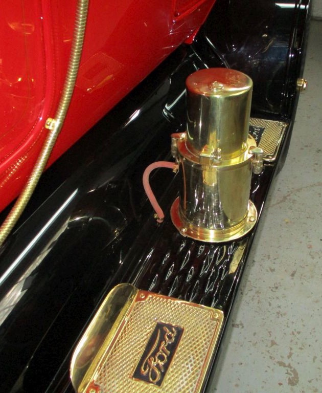

Post by John Heaman » Thu Dec 10, 2020 5:47 pm

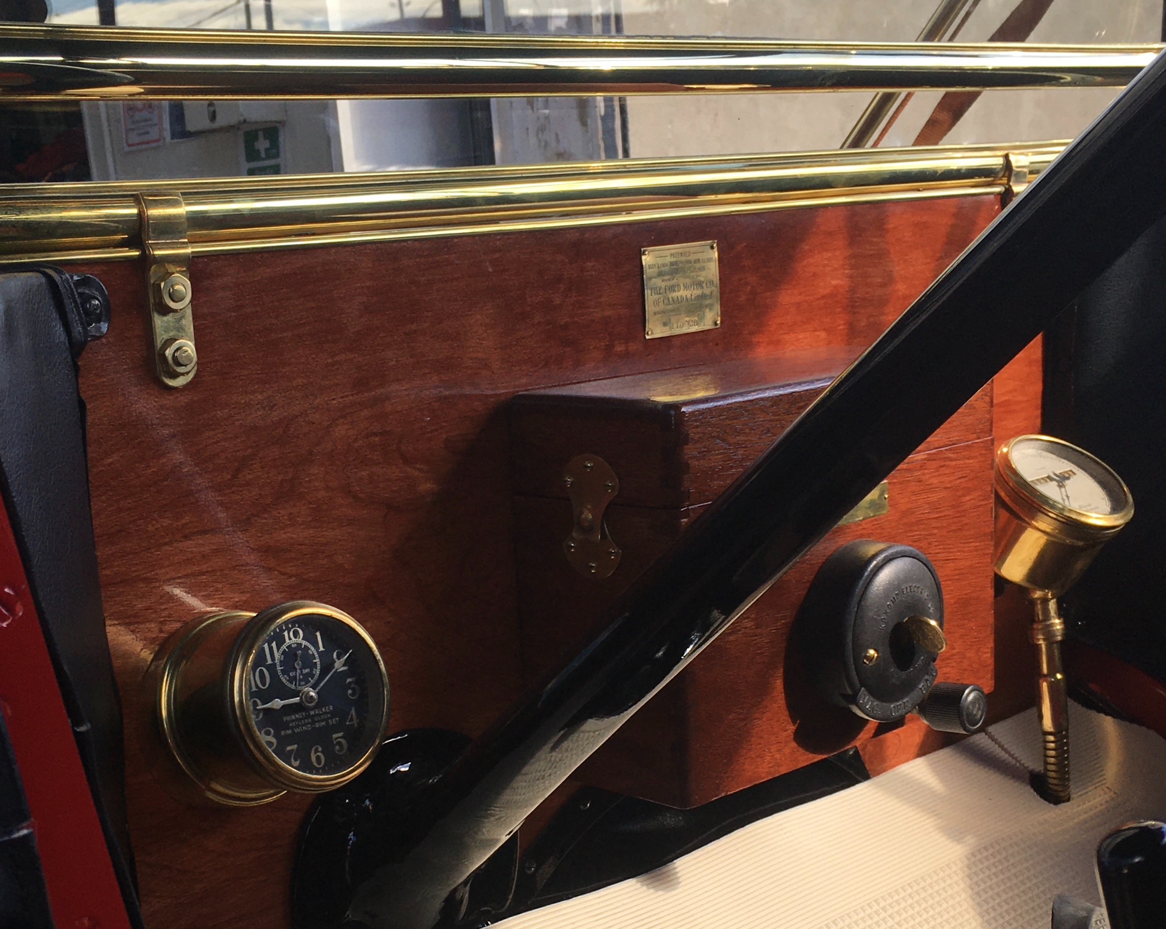

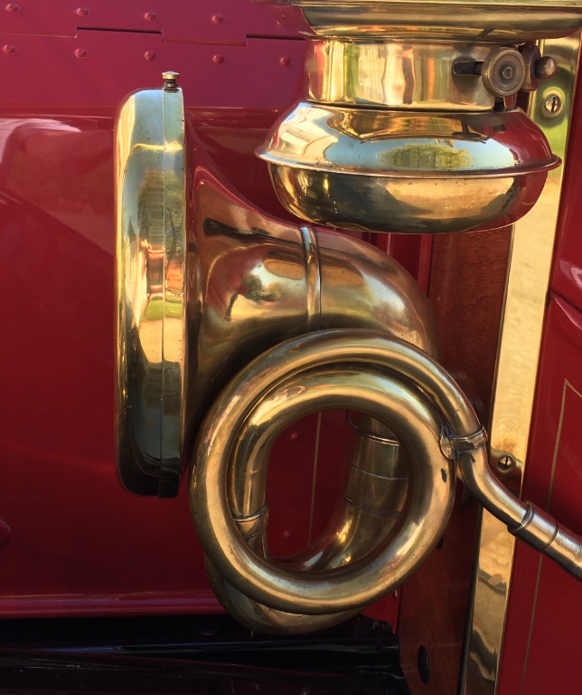

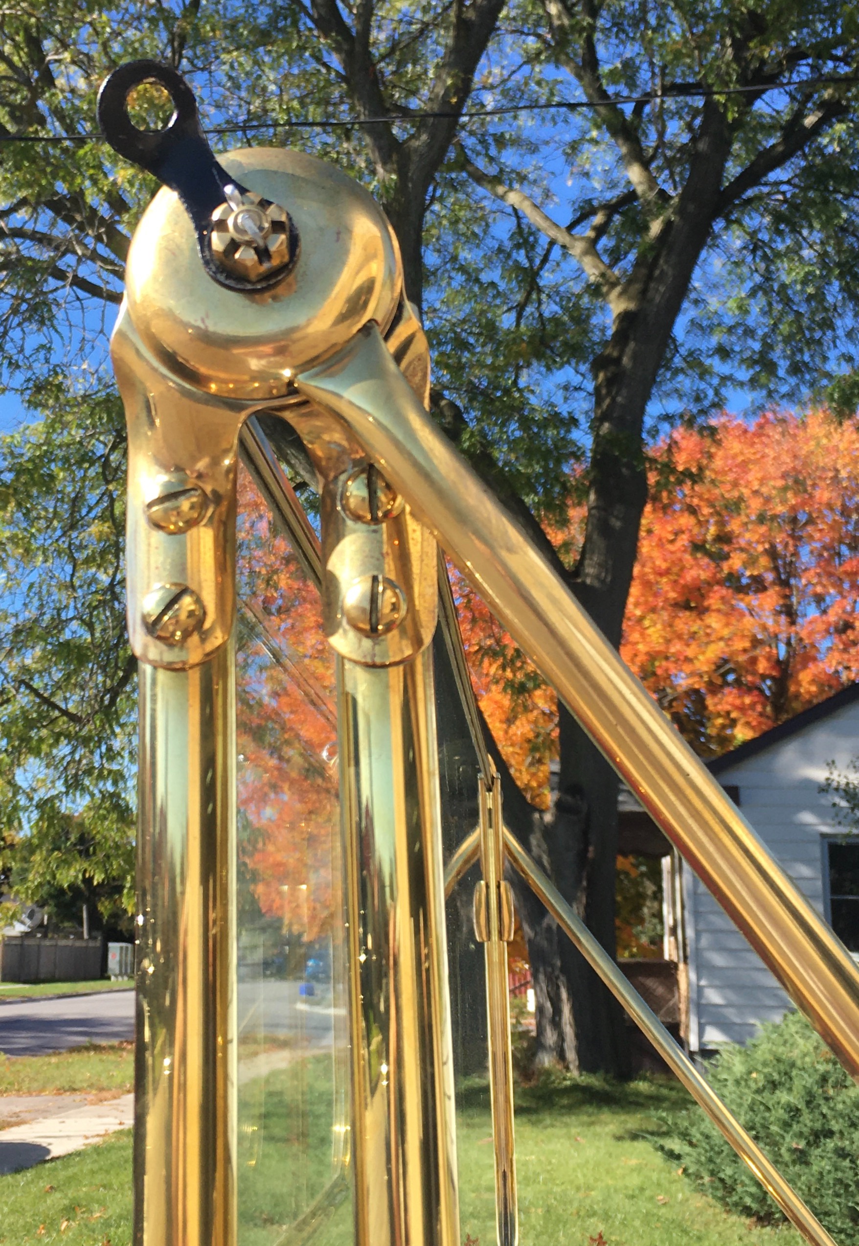

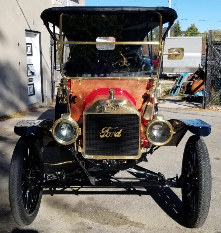

Call me Original Heaman...lol! I like the look of a slab side better with the fore-doors on (if you have them of course). I believe the thought is with the fore-doors removed the touring looks more 'old fashioned', especially if you use the long style top straps. And of course they are easier to get in and out of. 1912 was truly a transition year still having full brass in early production. I have tried to keep my '12 very original except for the body color. Being a Canadian production car it has the differences from US production such as the operating driver's door, double beaded fenders, 30" x 3 1/2" tires all around, carbide generator being centred over the running board 'Ford' script, the windshield hinges and the small brass clip that holds the horn tubing from getting caught on the driver's door. Feel free to correct me if something isn't right in my description. I'll post a few more detail pictures of the Canadian production T below.

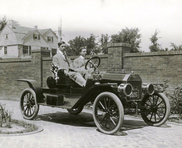

Here's another picture you may or may not have seen.
