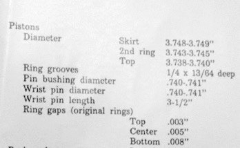

- Posts: 4090
Re: Piston size
Specifications from Ford Service School data, for motors made after 1913. Original std. size cast iron piston.

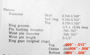

Re: Piston size
Dan, I've always considered those ring gap specs to be a misprint, they need to be reversed, the heat and hottest ring is always the top one and needs the larger clearance in any engine, even a compressor. And Joe, don't confuse your self with those specs, they are for the cast iron pistons, aluminium differ. you need about .012" on all ring gaps.
Adam
- Posts: 1608
- First Name: Adam
- Last Name: Doleshal
- Location: Wisconsin
Re: Piston size
Actually, the gap of each ring should be a bit larger than the one above it in order to properly relive pressure.
I do agree that the gaps in that chart are too tight.
- Posts: 4090
Re: Piston size
Frank
Thanks for clarification. Didn't read that detail, just cropped the specs and posted. So I added the ring gaps as noted in Ford Service book.remembered using those gaps when doing my first ring job in 1965.
The T smoked some and lacked a bit of power, so ordered a set of new std. size rings for cast pistons from J. C. Whitney! Pulled each and replaced the rings only. Followed the book and check the gaps to this spec. And ground the valves for good measure. T ran pretty good for a well used T!
So...changed that Ford Service Course date to use the specs in the Ford Service book.
