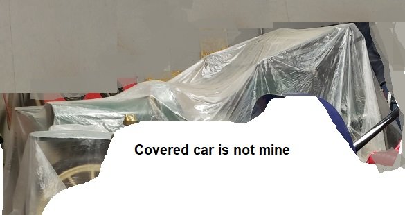

I like the sheets idea, they breathe. another option just light weight plastic drop cloth (easy on off- get a new one when dirty). But I wouldn't have either touch the new paint. Car covers are nice but if its inside a garage why the expense.
