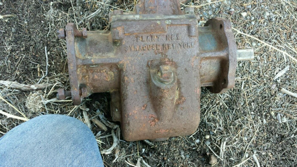

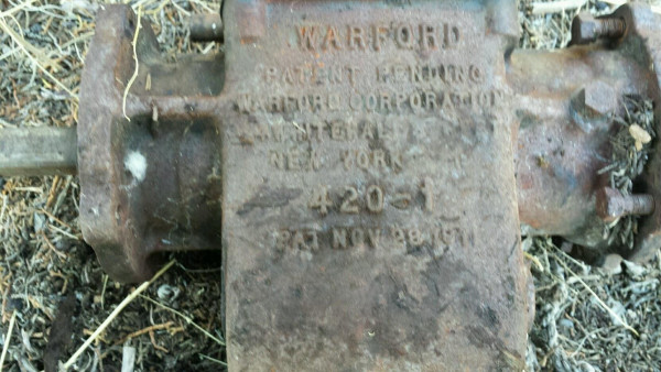

I ran across this in some T stuff I purchased. What is it? Warford 420-1

It's a common aftermarket add-on transmission for the Model T. Gives you under & over drive.

2 speed aftermarket transmission made by Warford for Ford Model T and TT's. More then likely direct and underdrive but could be direct and overdrive. Different gearing but like a Ruckstell if the underdrive unit, would give a gear ratio lower then Ford low and a gear ratio in between Ford low and high.

That particular Warford transmission will give you: Underdrive - Neutral - Direct drive. It isn’t as desirable as the larger “Three speed” which would also give you an overdrive, but still has some value. I’ve seen several sell over the years in the range of $75 - $300. They are popular for use in some T snowmobile setups.
The big “what if” is what it looks like inside. Remove the top cover with the shifter on it and see what it looks like inside. If there is no rust or water damage inside and the teeth look decent, then it’s probably easily restorable and usable. If it looks good inside, and you are just getting into T’s, it might be best to hang onto it for a while in case you might want to install it someday.

Meassure the front square drive if it is 13/16" it needs a adapter & U/joint to hook to the T transmission making it longer. If the square is 7/8" then it will bolt direct to the T transmission. You will probably need to turn the shifter around to clear the seat.

Your Warford is a 2 speed most likely under drive. Warford called these the Warford T in some advertising that I have seen. I have one in my 1916 Model T Express. My Warford is, 2:1 under drive, natural, direct drive. The bearings are available except the tapered pocket bearing that is obsolete. The gear change lever on yours has been modified, it should be straight. Because these are shorter thain the 3 speed Warford, about 8 inches virs 12 inches, the stock streaght shifter clears the seat and cross sill. If you use a Warford make sure to add rear brakes to your Model T for safety. They are well made and strong and work well plus give you the natural for rolling the car around the shop. They bolt to the T engine directly and take the shortened driveline directly with the T Ujoint.

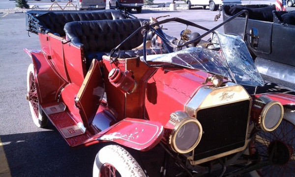

This is the result of an auxiliary transmissio going into neutral going up a hill. This car had no rear (auxiliary) brakes and rolled down the hill backward until it overturned in the ditch on the left side of the road. I was about 3 cars behind him. It was a beautiful car!

How did the driver and passengers do? The car looks like it can be fixed. I like to have lining on the parking brakes for just that reason.

Norm, I heard the lady (I think wife) had a broken pelvis but I never heard anything beyond that.

I believe I know this car, the owners and about the accident. If I remember correctly this accident happened close to fifteen years ago.
First the husband, wife and their dog all survived. If I remember correctly the husband was thrown from the car with steering wheel still in his hands and I believe suffered shoulder injuries. The wife stayed in the car with it upside down on her and I do believe the wife suffered the mentioned broken pelvis. The dog sitting on her lap suffered no injuries. The car was re-restored and they all participated in many more events.
NOW! The car DID HAVE accessory Rocky Mountain Brakes at the time of the accident. They just did not hold and he could not stop the car from rolling backwards down the hill.
