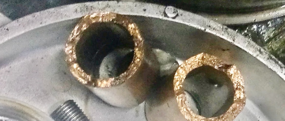

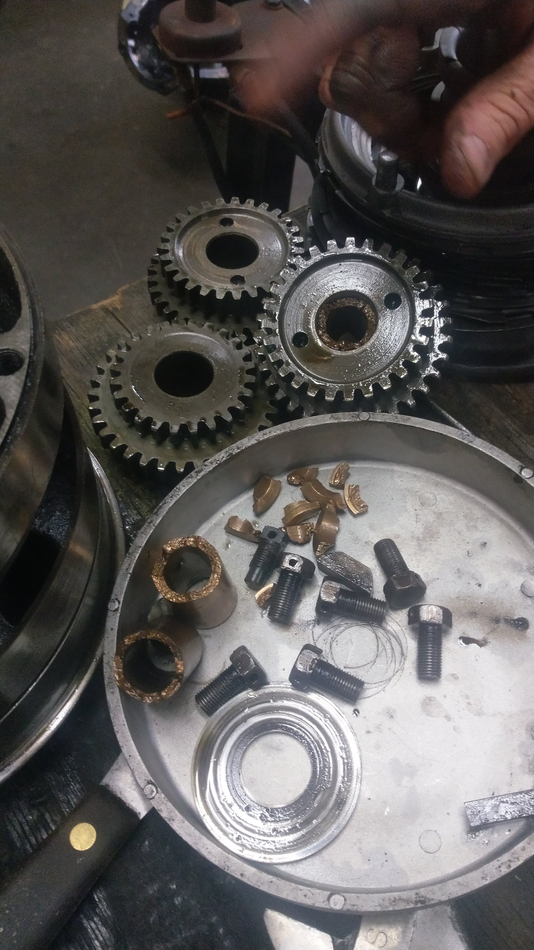

As I was changing the oil, brass pieces fell out of the drain.
After calling an mechanic, it turns out I had a loose triple gear. Pulled the engine out, to find and fix the damages.
However it seems all 3 of the triple bushing failed in a similar fashion
:?: Why the bushings failed in such a way? :?:

Those bushes look to be bronze, no give in that stuff, it's as brittle as cast iron.
PS, just went out to the work shop and grabbed a original Ford triple gear bush out of the scrap bin, beat the crap out of it and bent it every which way, no way it shattered like a biscuit.

Could be material, but triple gear bushes are made of z-bronze, get mine from Bob's.

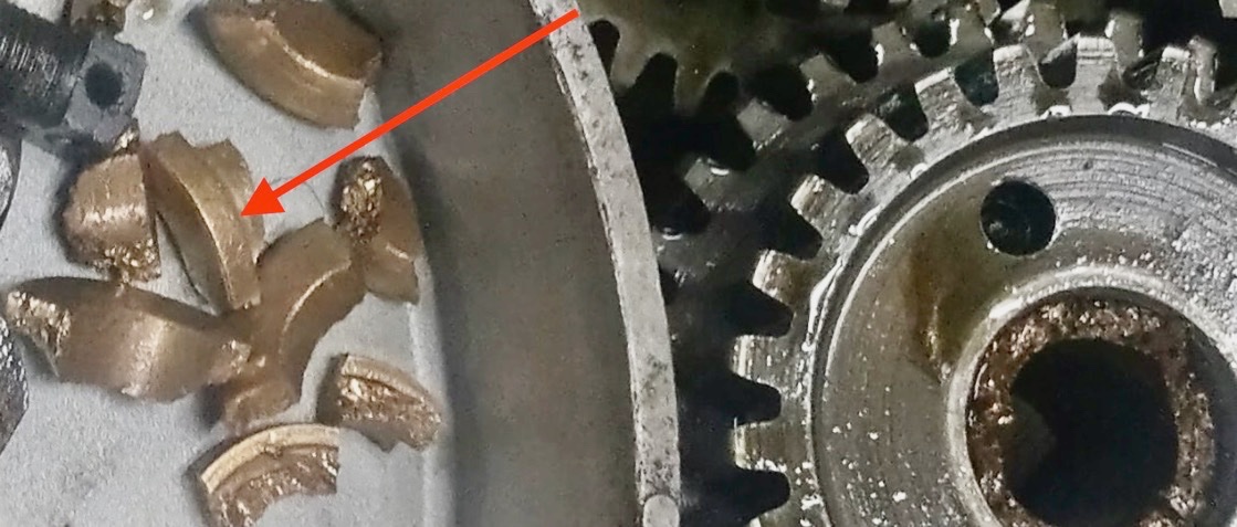

Maybe the clearance was too tight, the bush on the right is stuck and top flange busted off.
Or the face of the bush wasn't fitted, sure looks like full thickness (see arrow) as made, the flange of the bush should project only 006" - .010" over the side of the triple gear, they need to be machined to that fit.

Might just be the angle of the photo of those twisted off bushings, but seems to me they are missing the very important oil grooves to allow oil to the bearing surface.

Appear to be Oilite - sintered bronze
sintered bronze, an engineered material, is not ductile and will fracture easily under the right conditions and is not engineered to take a severe load
cast bronze is ductile and will not fracture easily and is well suited to a pounding or severe load duty

By the way the broken pieces look, and the way they apparently failed... Something really doesn’t add up here. I’m thinking there may have been some sort of an installation error. But it is really impossible to tell from pictures. Anyone would really need to see the whole assembly in person to make a diagnosis.

Would agree, and that's why likely the oil groove wasn't placed when these non-Ford type bushings were made.
Those bushings have to run on a surface of oil.

Agreed. They may also have been pressed in, in a manner that further exacerbated a poor choice of material. If the bushings were pressed in using a tool with a fairly small step with which to engage the face of the flange, after the bushing was seated against the gear face, any additional "push" would have had the effect of trying to push the flange off of the bushing. At the very least, there would have been residual tension between the flange and the bushing body that, over time & use, caused the flange to separate from a brittle Oilite bushing. The proper way to press the bushing in would have been to use a tool that covers the whole face of the bushing flange. Naturally, all of this is speculation, but it seems to support the situation now at hand.
