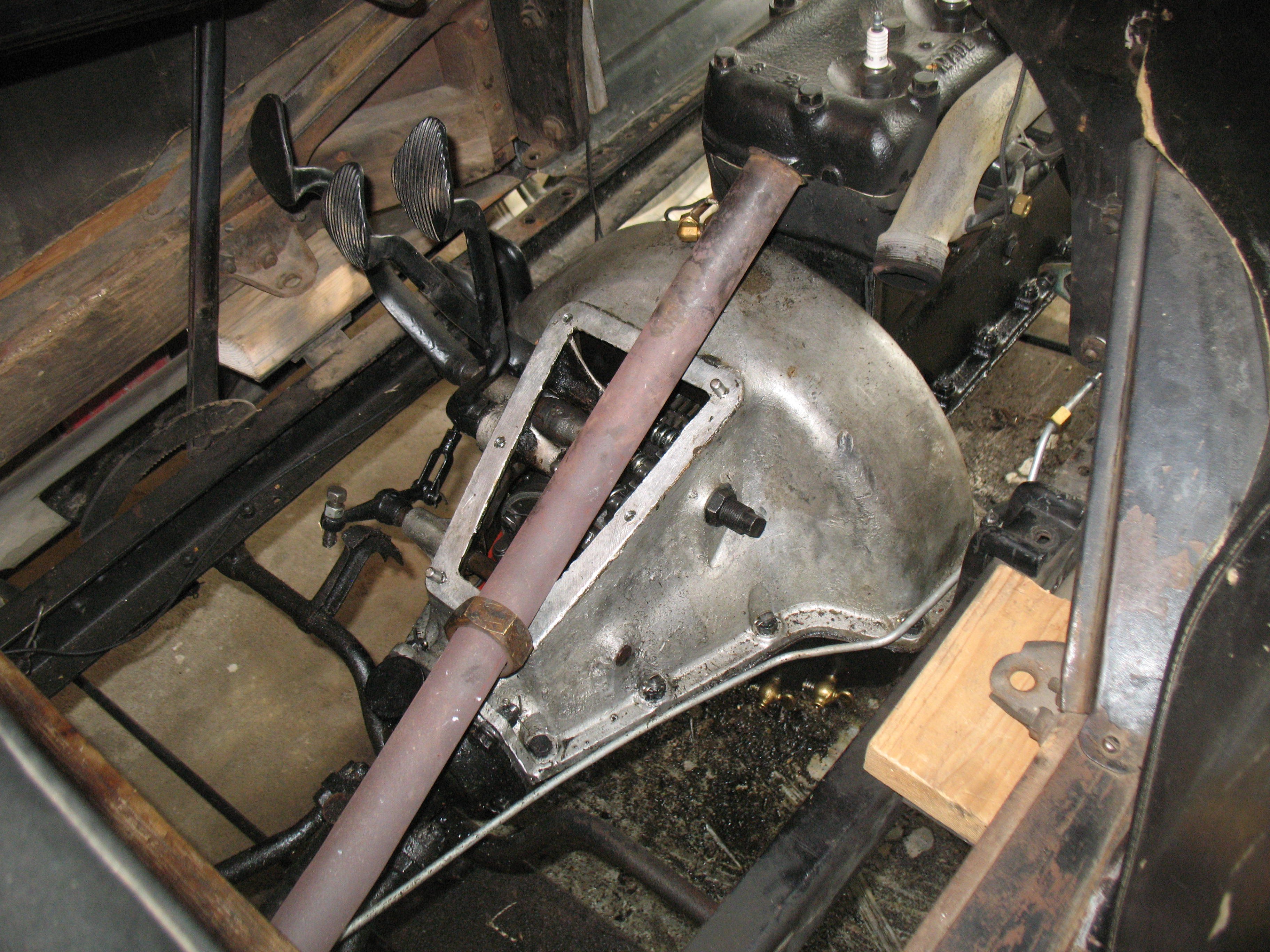

14 Use the hoist to raise the front of the engine enough to slide it forward. As you move the engine forward raise its front more and more until the pedals are low enough to move under the firewall. There's no need to remove the firewall or remove the pedals or hogshead in the car.

Leave the firewall and hood former on the body. The hardest part is unbolting the firewall brackets from the frame and you apparently have already done that. After the firewall brackets, there are a whole six main body bolts holding the body onto the chassis. Three on each side. One each side near the front, about a foot back from the firewall brackets, one near the door in the center of each side, and one each side near the back of the body directly over the rear axle.
The four (two each side) towards the front, behind the firewall and under the door, need to be unbolted completely. A couple of your favorite wrenches of appropriate size and a few minutes under the car. Easy task. The rear two, over the rear axle, need to be loosened, about two turns is enough. Also not difficult.
Disconnect the drag link/tie rod from the steering column, and unbolt the bracket from the frame. Loosening the steering column from the firewall may also help, however I and others have often managed to leave it tight, and work it out from the frame rail.
Lift just the front of the body. Only about two inches (often a bit less) is all it takes. I have done this by myself a few times, and helped others a few times as well. A few small wooden blocks, a tire iron or two, and lifting the front of the body that much is easy for one person.
The lifting of the front of the body that small amount shouldn't cause any real problems with the fenders or other attachments (do check for adequate slack in the timer wiring).
One caution (beyond always working safely!). If your body and doors were in good alignment and working really well? Be sure that you get any and all shims, washers and/or etceteras back just as they were.
Most model T people, when working on 1910s era Ts, once they bite the bullet and lift the front of the body to move engines in or out? Never want to fiddle-fart around trying to avoid it again.
This has been my experience with this task.

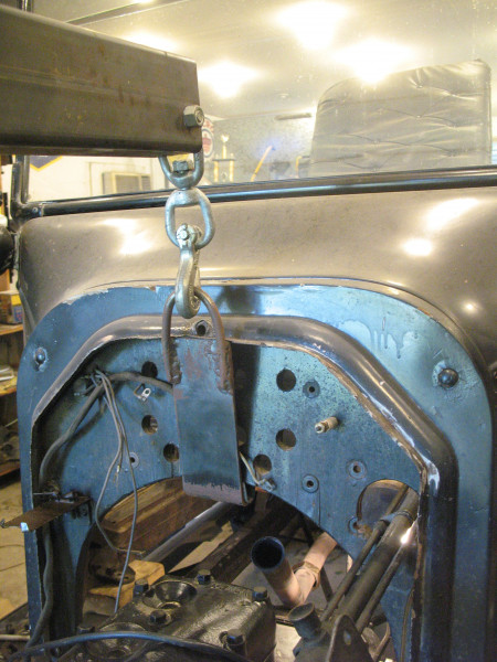

- Posts: 7411
Re: 1915 Center Door, pulling the engine
I made this lifter for raising the front of the body. Makes it easy.

Steve, that is a fantastic body lifter that you made. It may not be a bad idea to put a rag or something on the wood firewall before lifting to keep that 100 year old wood from shattering. I always removed the firewall on my 18 when I removed the motor but I was not concerned with damaging paint of the hoodformer bolts. Frank
- Posts: 7411
Frank, it has inner tube padding. I think the firewall is only 45-50 years old, so it is solid.
