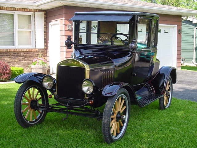

When I purchased my 24 Coupe they were installed by previous owner.
Have left them on as I'm not ready to do body work on pillars.
Not factory but looks ok along with brass radiator shell.

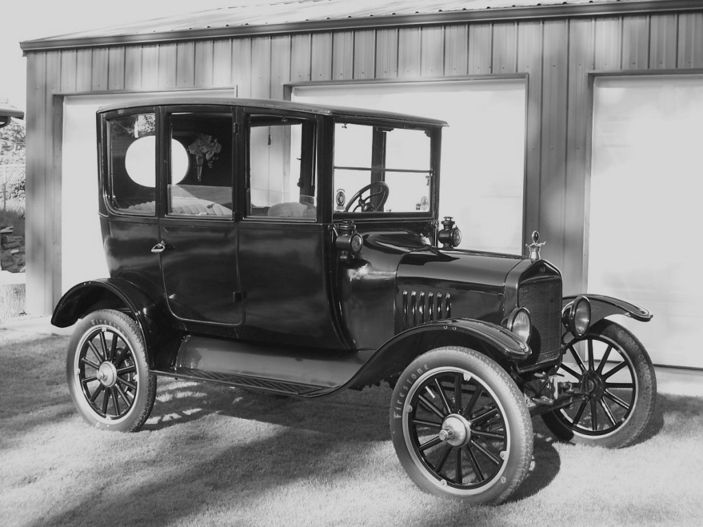

The '17 and '18 Sedans had side lamps, looks good on them too!
