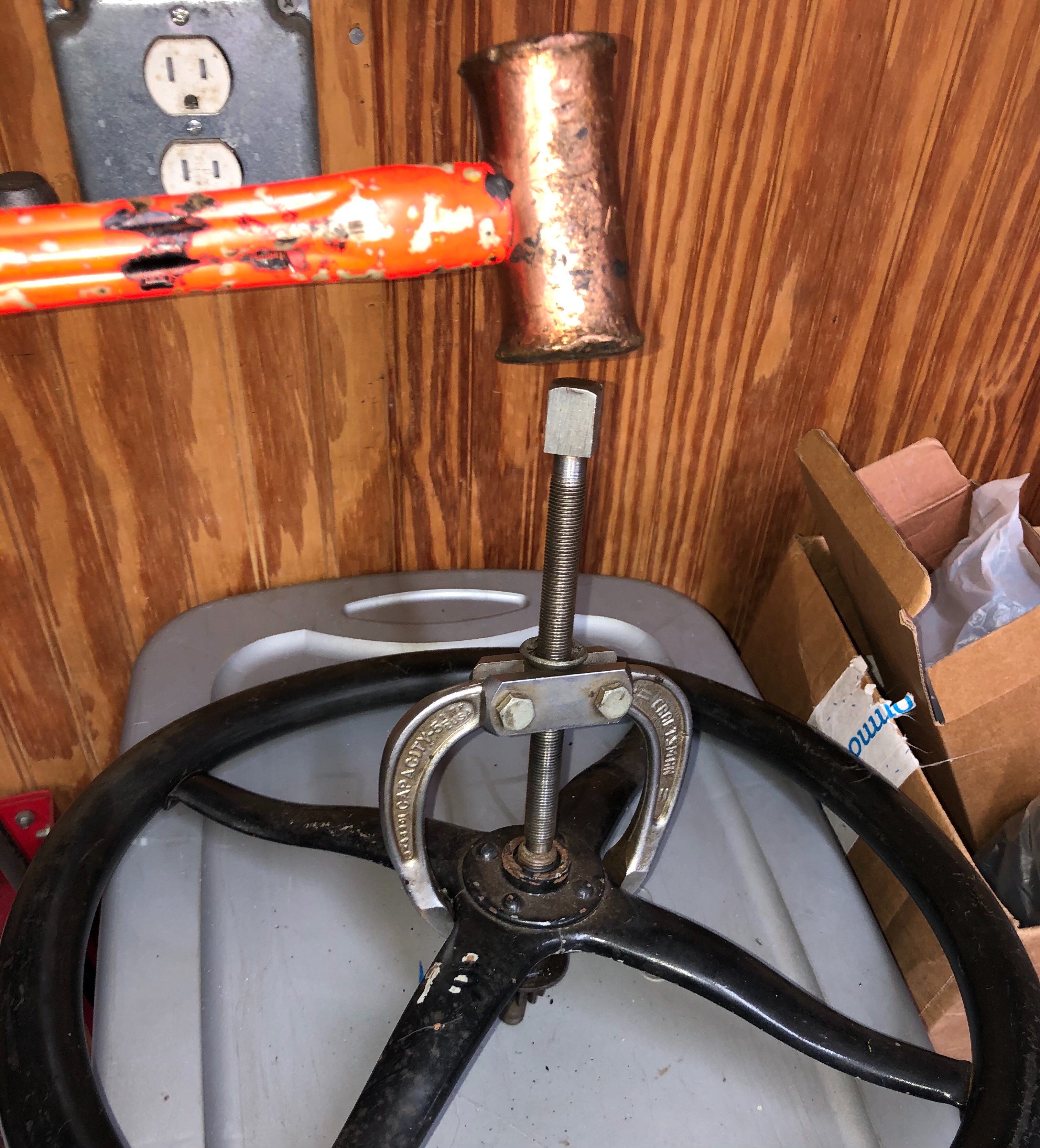

Good 2 jaw or better yet a 3 jaw puller.
Remove the nut, and then apply lots of penetrating oil, Kroil or P B Blaster to the threaded areas, if the threads are rusted, wire brush away the heavy rust to let the fluid sink in, let is sit awhile, but soak it!
Then apply puller, use a mallet and tap on the puller shaft, then tighten and the wheel spider will pop off.

JonahJonah D'Avella wrote: ↑Thu Dec 17, 2020 8:50 amwhat is a 3 jaw puller? i have soaked it in pb blaster and used a tool identical to what you're showing and still couldn't get it off.
A 3 -jaw give a bit more grip, using 3 points of pulling power. But a strong 2 jaw should work. Check to see how rusted the spider is underside, really soak the center of that steering post pinion, and tap on it to get the fluid to soak down deep between the spider and the post, keep soaking and tapping as the vibrations allow the fluid to do its thing to lubricate and cut thru the rust holding the spider.
But be sure the center point of the puller shaft isn't resting on the spider, it has to rest on the pinion post to effect a solid pull
When using a puller tighten with the center shaft, then hit hard 3 strikes, and then tightened the shaft again with a large wrench on the hex of the shaft, apply lots of pressure, and knock hard with a 5 lb mallet. The shock is what you need to 'pull' that spider off the post.
Your locking wheel accessory cover isn't holding the spider, that spider is held to the post with a key, and a tight fit of the spider and the post.

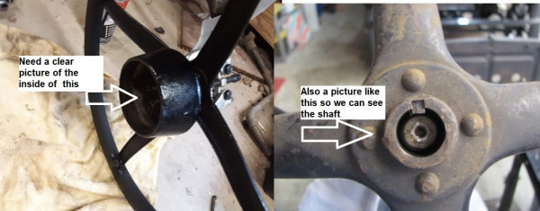

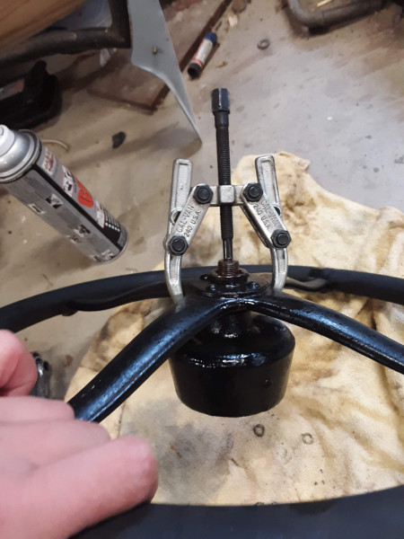

Jonah, suggest you post some pictures of the wheel so others can see what you have.

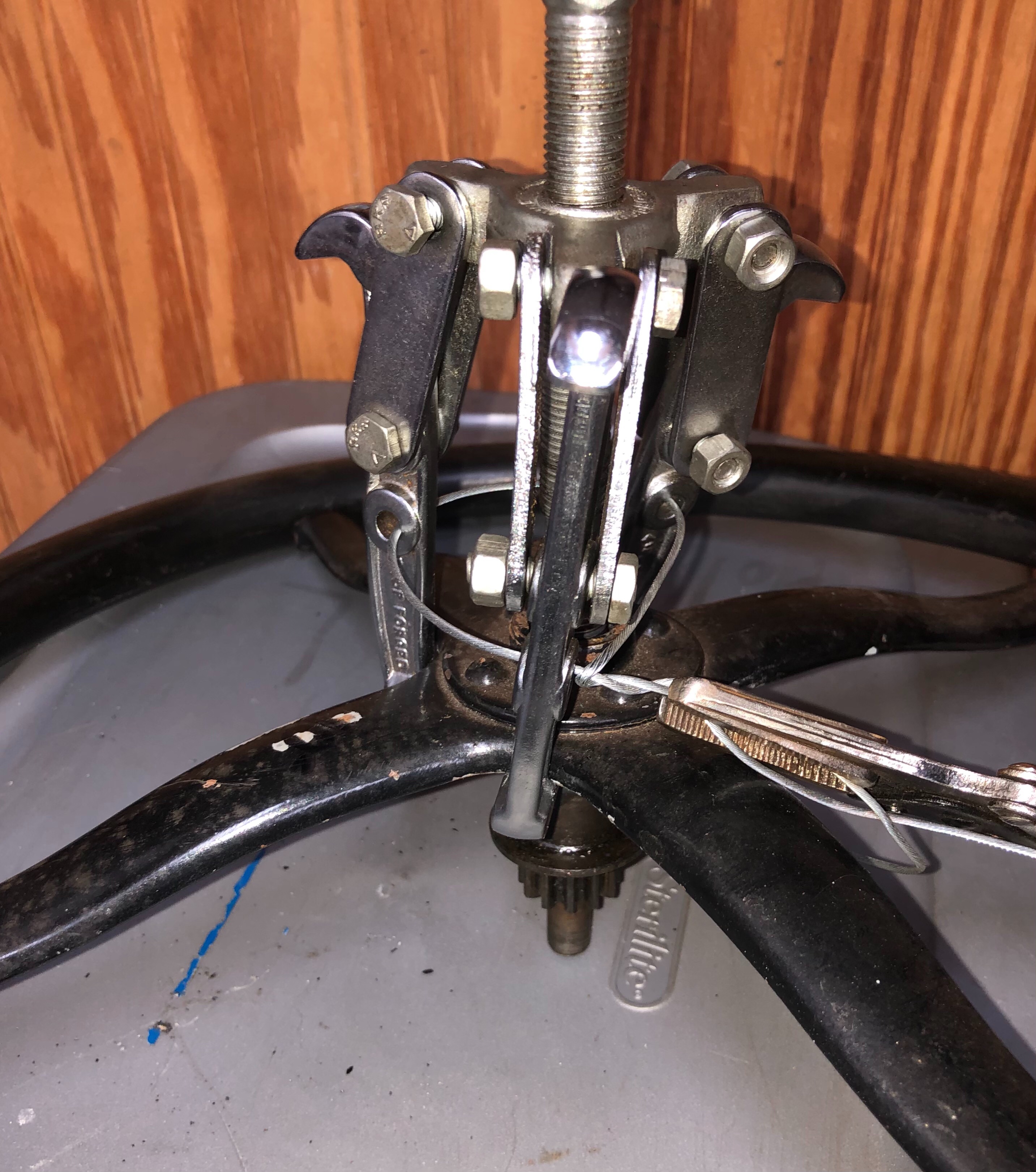

Right you guys are. Two jaw for the job,Steve Jelf wrote: ↑Thu Dec 17, 2020 11:43 amHow does a 3 jaw puller work on a four spoke steering wheel?
My question too. None of my three-jaw pullers are adjustable to fit a four spoke steering wheel as well as a two-jaw.
A 3 jaw can work but that dangling third jaw needs some help!

There is enough play in a three jaw puller to work well. All good advice above. Especially penetrating oil, and patience.

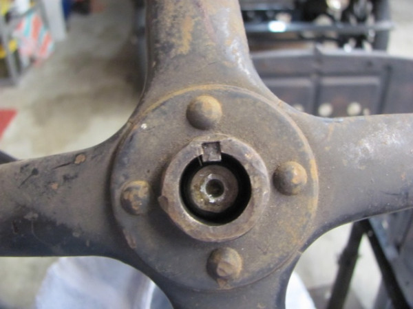

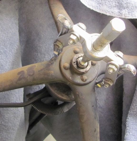

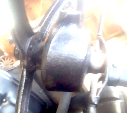

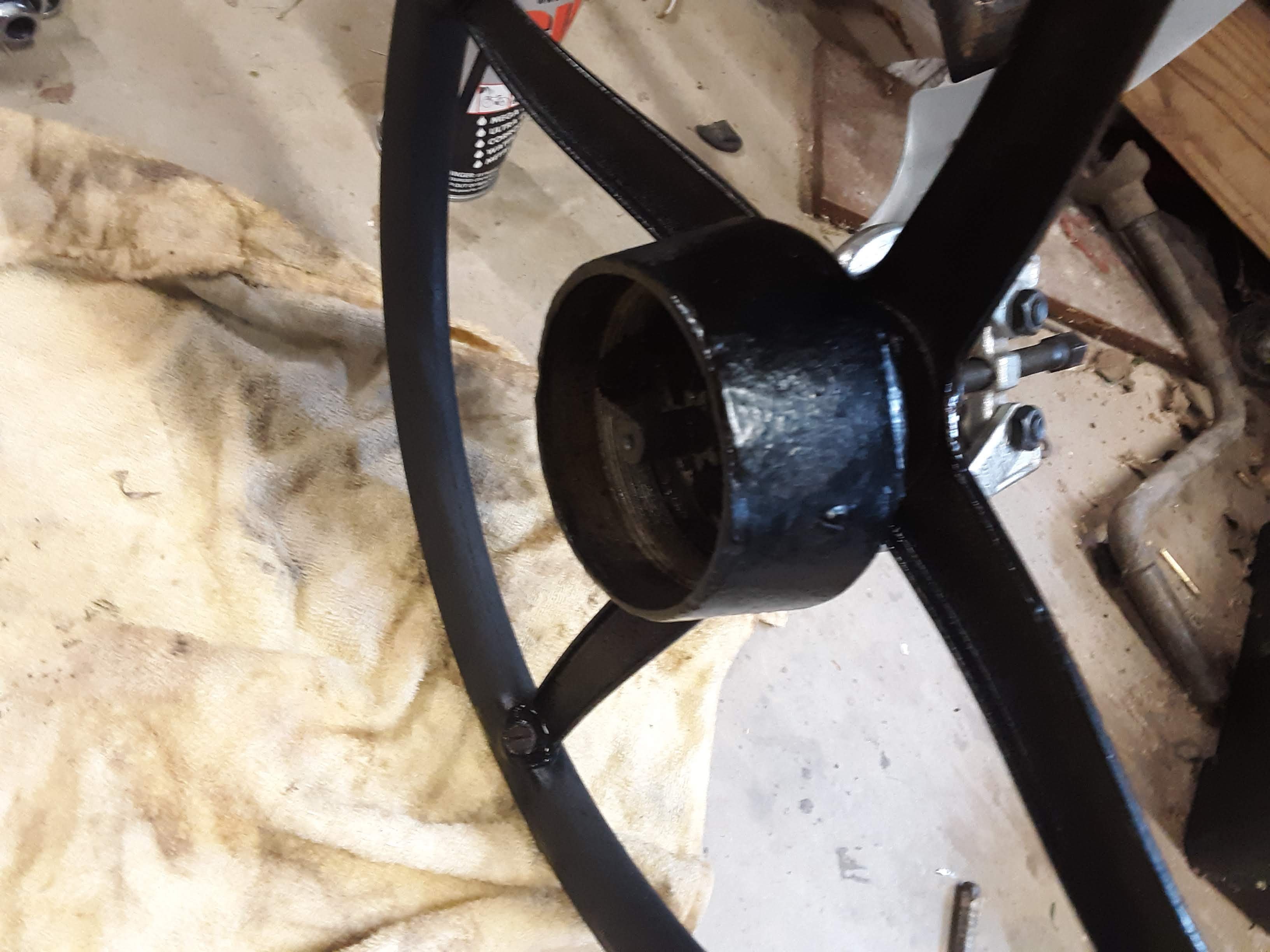

Re: STUCK!!!!!
here are some pics
- Posts: 4089
Re: STUCK!!!!!
Your small gear puller is a bit undersized but might work.
A larger puller and strikes with a 2lb mallet will get it off. Tighten the puller shaft fully by cranking on the hex head with a big wrench.
If all else fails take a torch to the stuck pinion and heat it , that can help separate the spider from the pinion.

If you are going to hammer on the puller, put some wood under the spider as close as possible to the center so you won’t break the steering wheel rim. That would make it all garbage and you would have to buy a new steering wheel and shaft. That would be one solution to your problem, new everything. My .02 cents. Frank
- Posts: 6587
Re: STUCK!!!!!
Need two more pictures, like I have shown, to make sure we understand what is holding the wheel from coming off. Since you have a wheel lock there may be something unnoticed. Question: The housing of the wheel lock is still attached - is it fixed to the wheel or can it turn freely?

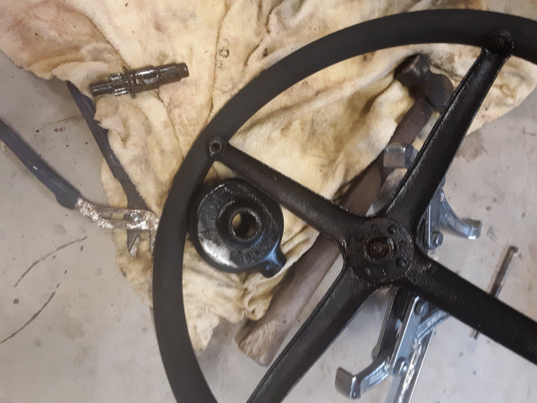

Re: STUCK!!!!!
Thank you all so much for your tips! Using your advice, I was able to get it free!
