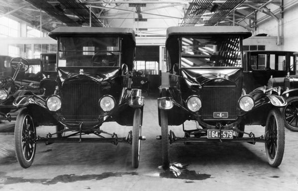

It's not a truck, but it's an interesting comparison of the prior low radiator next to the new high radiator.

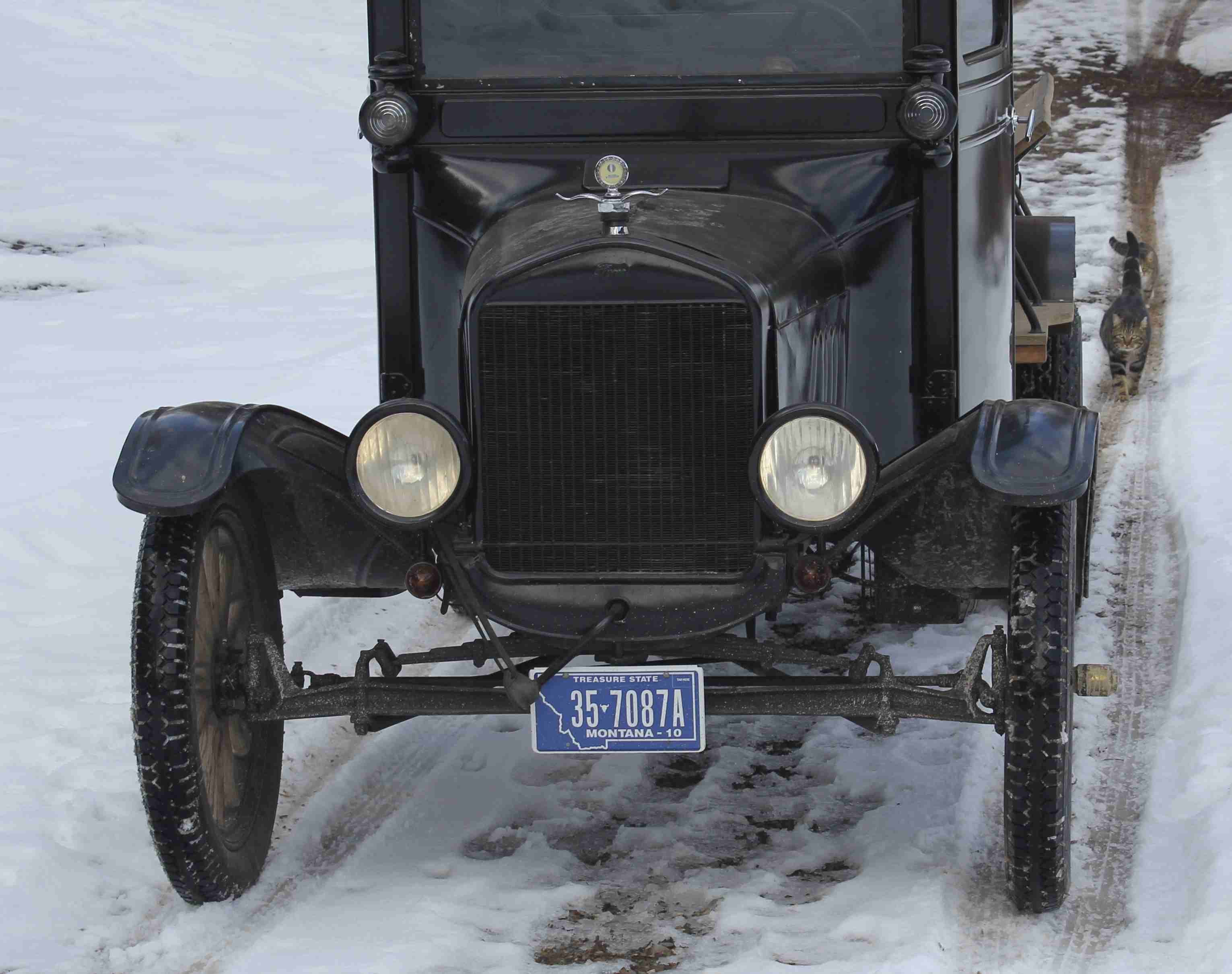

Post by kelly mt » Wed Dec 16, 2020 2:51 pm
This is my 25 TT.

Re: Front view of original 24-27 Ford TT Truck needed
Post by RustyFords » Wed Dec 16, 2020 3:24 pm
I like the two "supervisors" bringing up the rear. :)

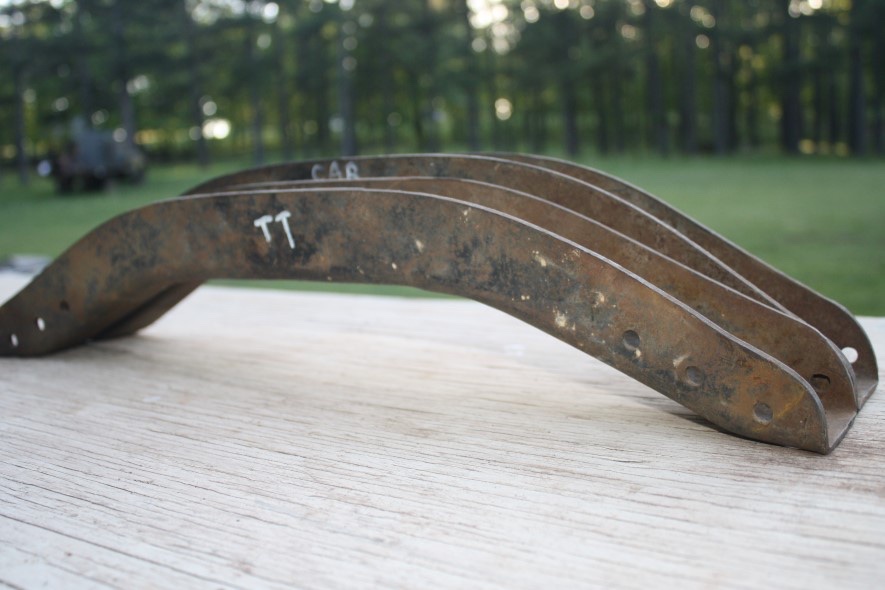

T and TT front crossmembers are different.
TT is Ford part # 1122

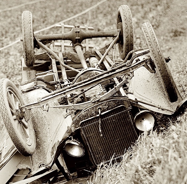

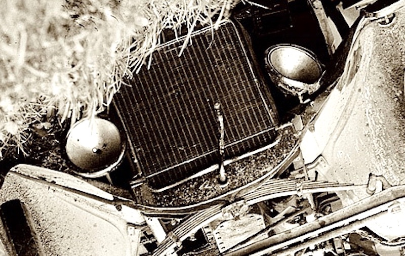

Front of late TT with radiator apron
Or, right side up!

Dan, the TT cross member looks heavier than the car one, but still the same basic shape. Is there a 9 leaf front spring Y mount with the hole for the extra mounting screw below the crank handle hole? Otherwise the standard radiator apron should still fit, as shown in the photos above.

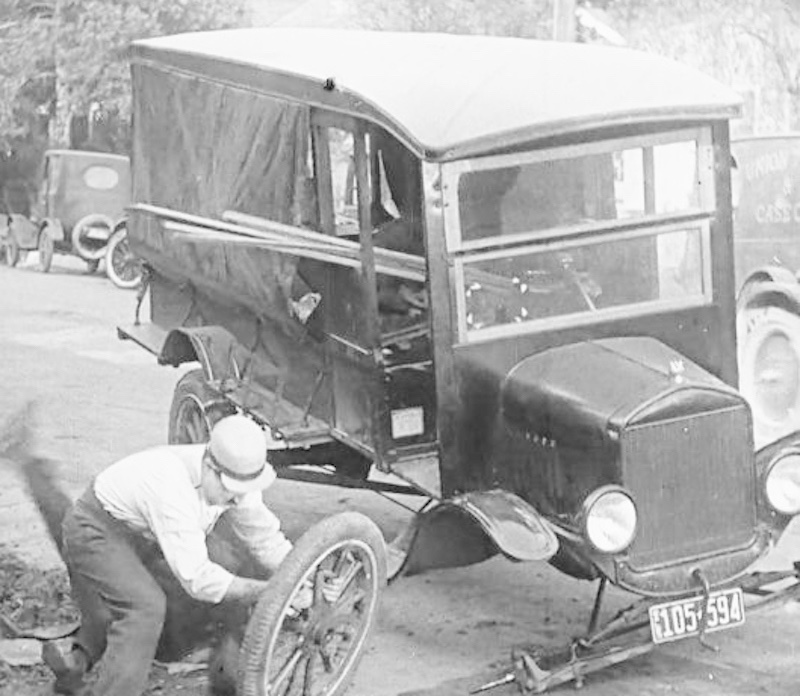

Post by Mark Nunn » Thu Dec 17, 2020 8:54 am

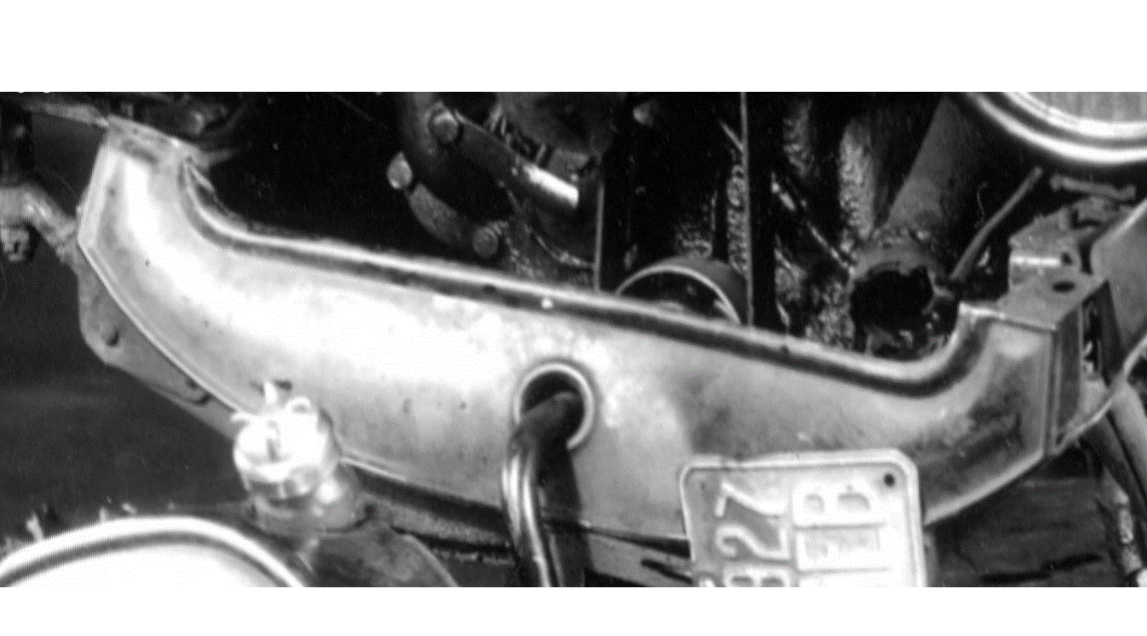

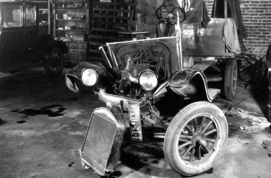

This photo was taken in '27 but I can't tell what year this TT was from.
