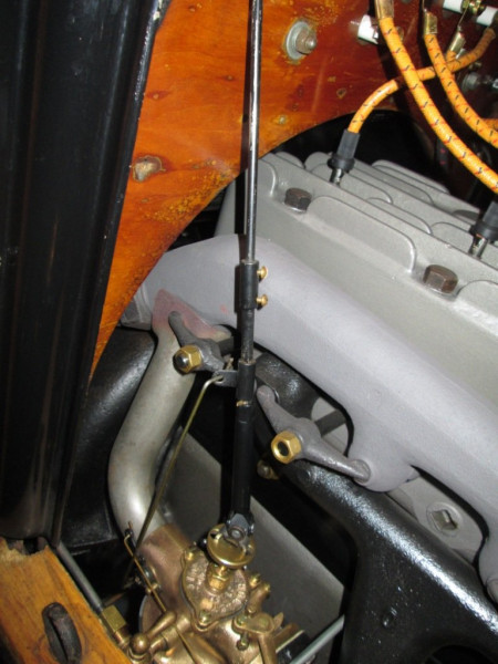

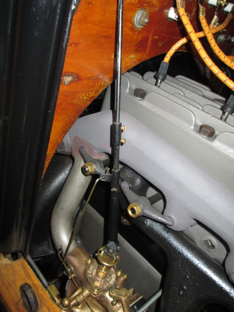

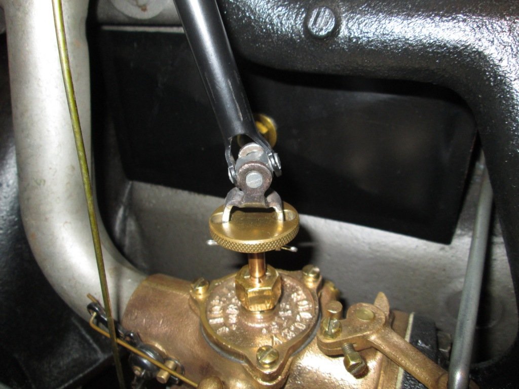

I'll get a photo later but I modified my original mixture rod with a combination choke/mixture under the hood so you can't tell it's modified from the cockpit.
Posts: 5595
Re: What choke setup you have for a Holly G from inside the cab.
Post by RajoRacer » Mon Dec 14, 2020 3:50 pm

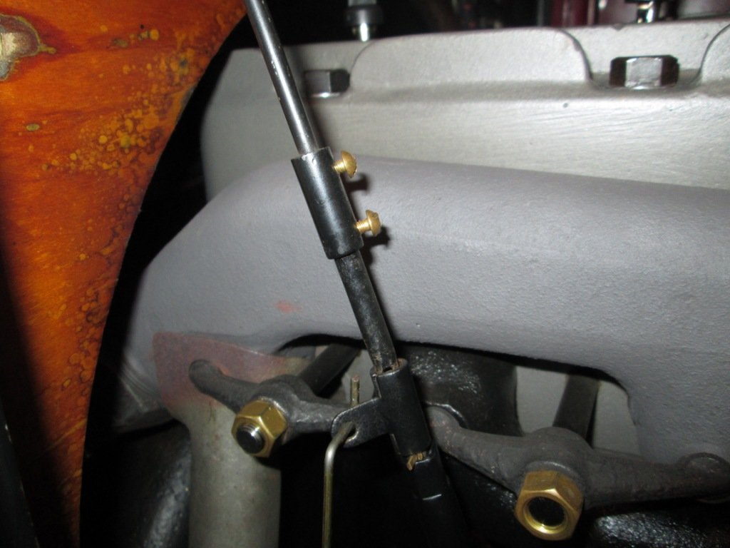

I'm back - here's how I did mine - you'll need to use an NH choke lever on your G.

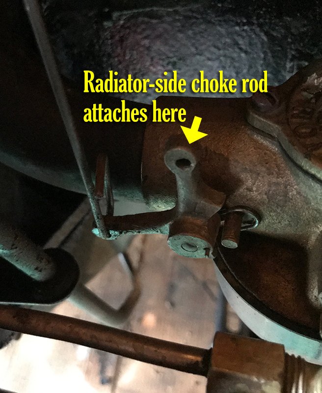

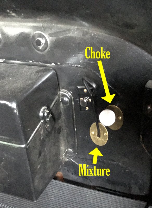

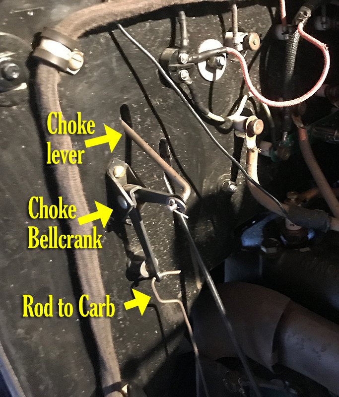

I faced the same problem when I installed a starter in my 1917. My approach was to duplicate what Ford did in later (1919-21) cars by installing a double lever on the carb (done by Russ Potter during rebuild)[photo 1], a bellcrank with a pull wire to the carb [photo 2] and a rod and knob thru the firewall [photo 3]. I had to cut the rod shorter and re-thread it to accept the knob but all in all it came out good. Since the rod moves up and down a bit I drilled a hole thru the firewall from the driver's side and used a small router to open a slot on the engine side.

Thanks - I wanted it to appear original from the inside. I did the conversion to electric start for an old timer w/Parkinson's - he couldn't hand crank anymore and we ended up with his '14 Touring after he passed.

You don't have to use an NH choke lever. Beginning in 1919 the G came with a double lever. There are a jillion of them around.
