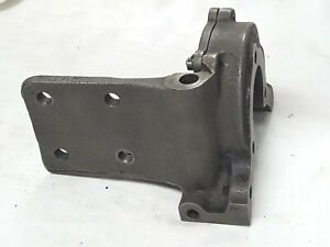

I want to install a Bosch magneto and have acquired the mounting bracket below. Are all Bosch DU4s the same or am I looking for something specific? Any help would be appreciated.
Posts: 3049
Last Name: House
Re: Bosch DU4 - Correct For A Model T?
Post by George House » Fri Dec 18, 2020 9:18 am
They’re basically the same except the base is cast brass on early DU 4s and cast aluminum on later mags. I think both will fit.

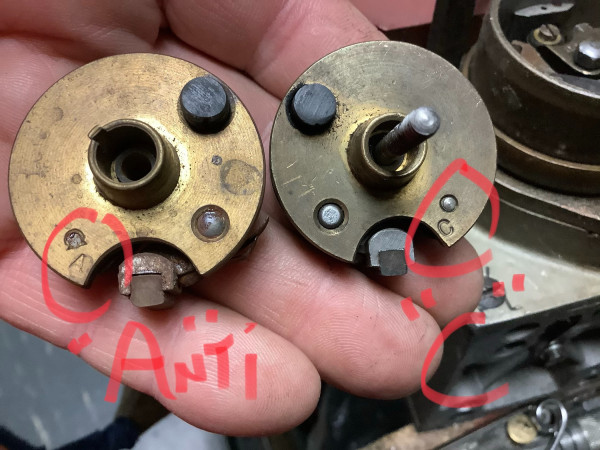

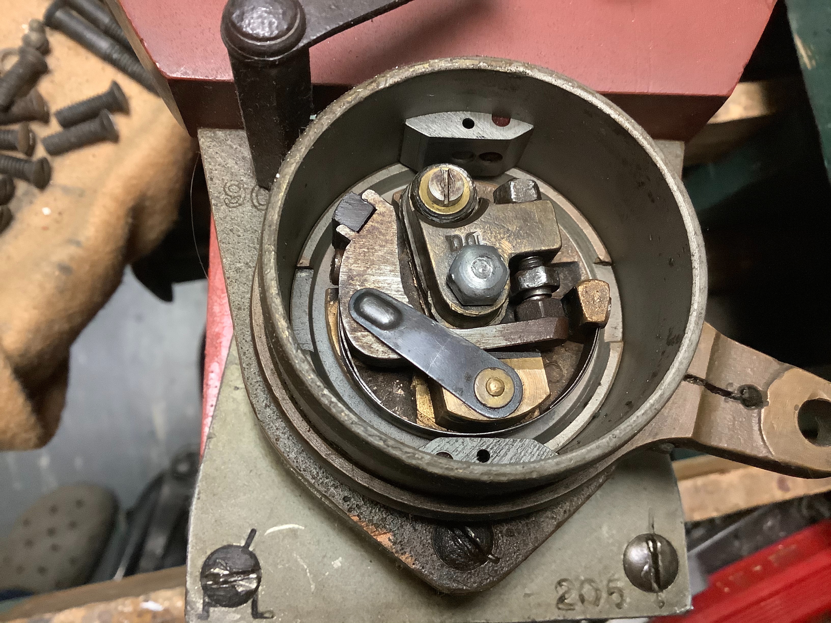

Tim, shown is the right point sets inside the mag. That set is clockwise. Shown on the backside , one is marked “C” for clockwise. The other “A” denoting Anti-clockwise. That is how Bosch referred to them. If you need a copy of the manual, let me know and I can email it to you. It answers everything you need to know to set it up correctly.
From memory, the 3 gear side drive setup uses an Anti-clockwise mag. The side drive like you show, and all the front mag drives use the Clockwise mag. If not correct, hopefully someone will shout out. If you don’t fool with these all the time, the info leaks from my brain. The recent Bosch mag shelf that I made up, I’m not sure of rotation required. Need to map it out someday.

“A” means anti-clockwise , also counterclockwise. “C” means clockwise

Tim, those pics are gold for many people! May I steal them for my magneto records? Serious question. I don't know if I've seen that before!
Which manual do you have? Very curious. PM me if you feel it more comfortable.
oldcroak has graciously provided me with many magneto manuals. A God-send.
For impulse coupler users, most times that part's cake as the parts are marked like those "jewel pics" of the points plate.
Just flip the parts (and the spring) around so you see the A or the C/AC as your needs dictate.
Replace the interrupter (points) plate, re-time the gears and set the impulse coupler.
Susanne, I sure get ya there! In the driver's seat verses standing at the front. I've struggled with that also.
Mags are viewed with the mag in your hand or on the bench and the drive end or impulse coupler facing you.

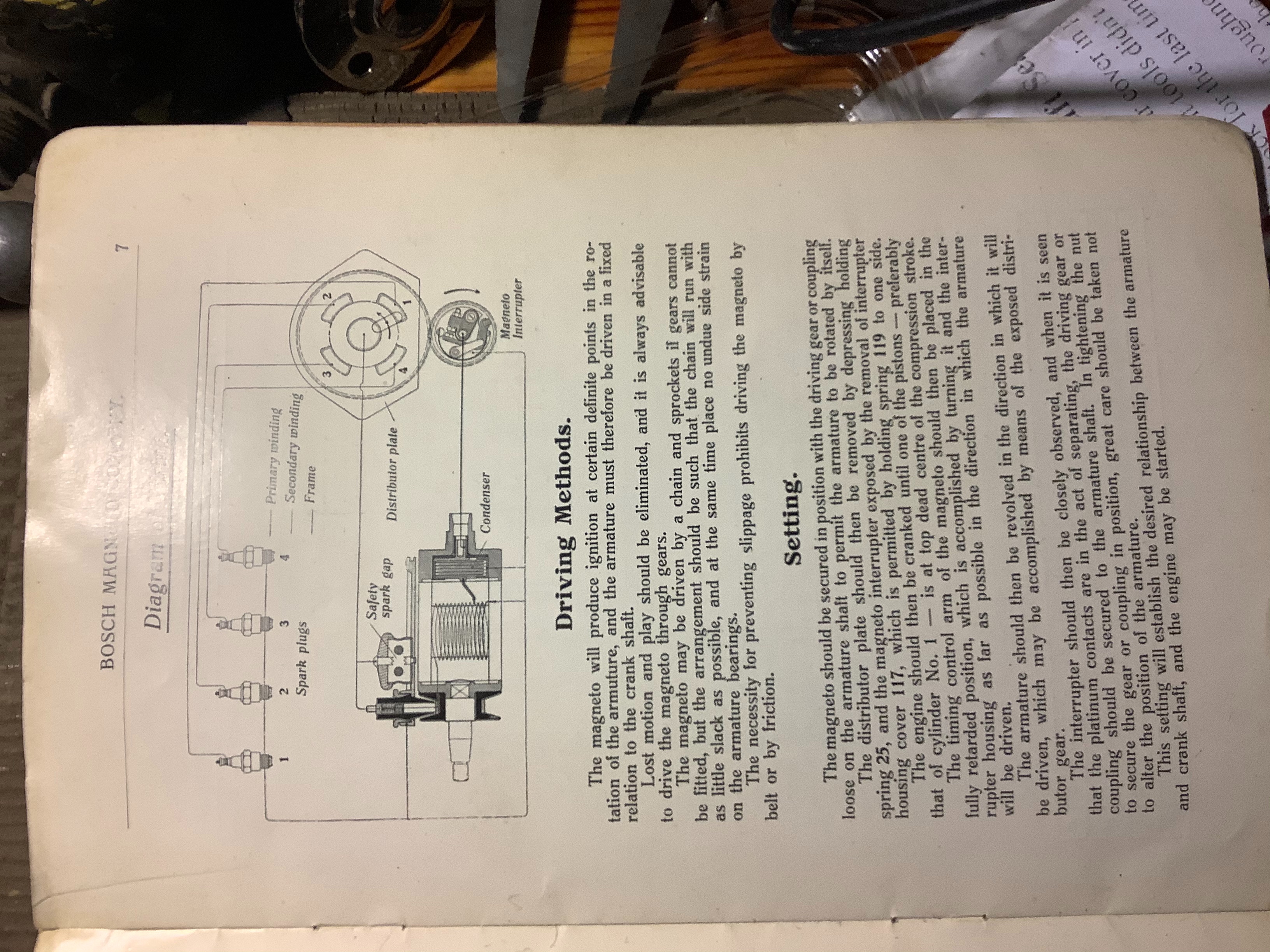

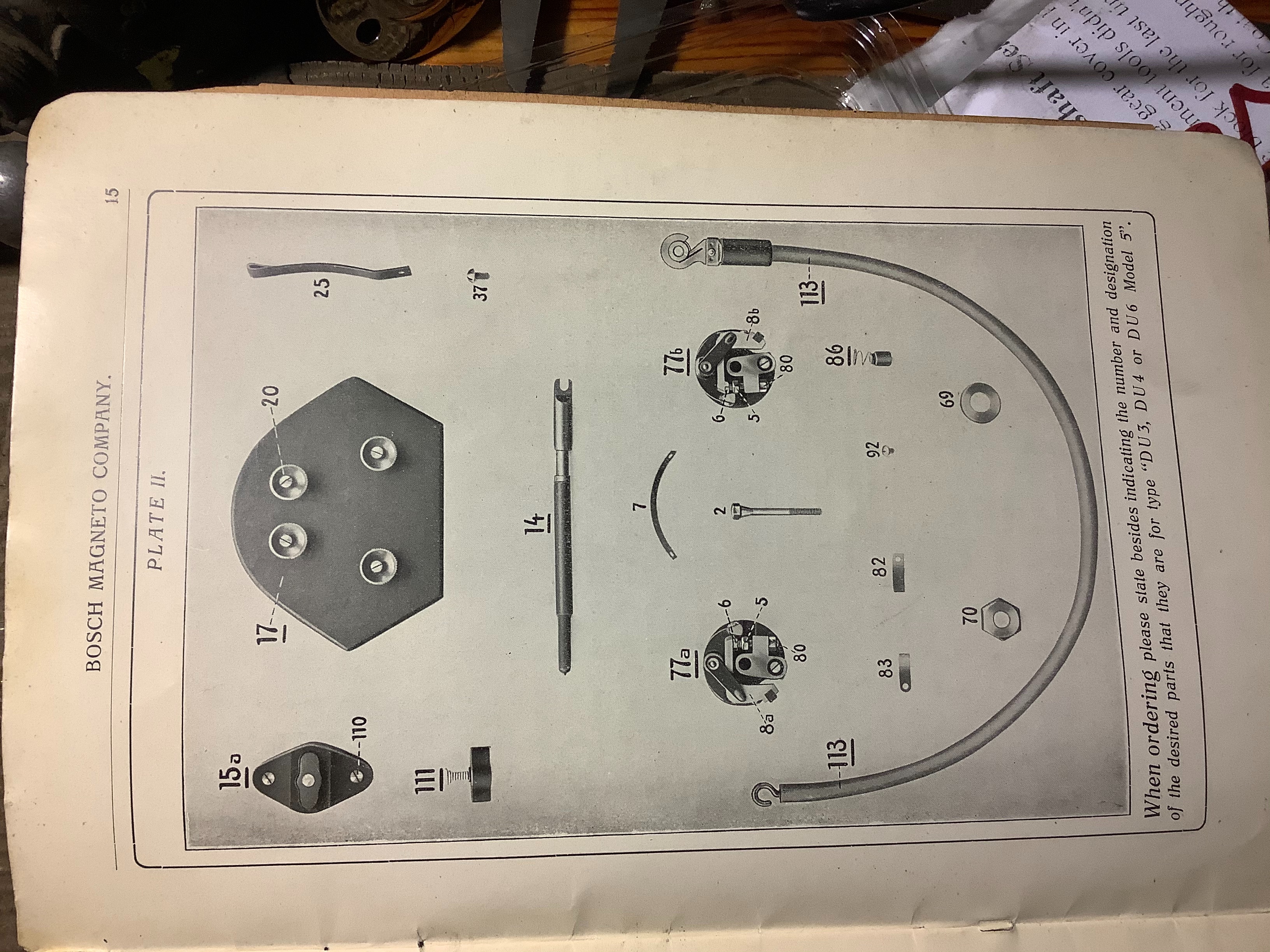

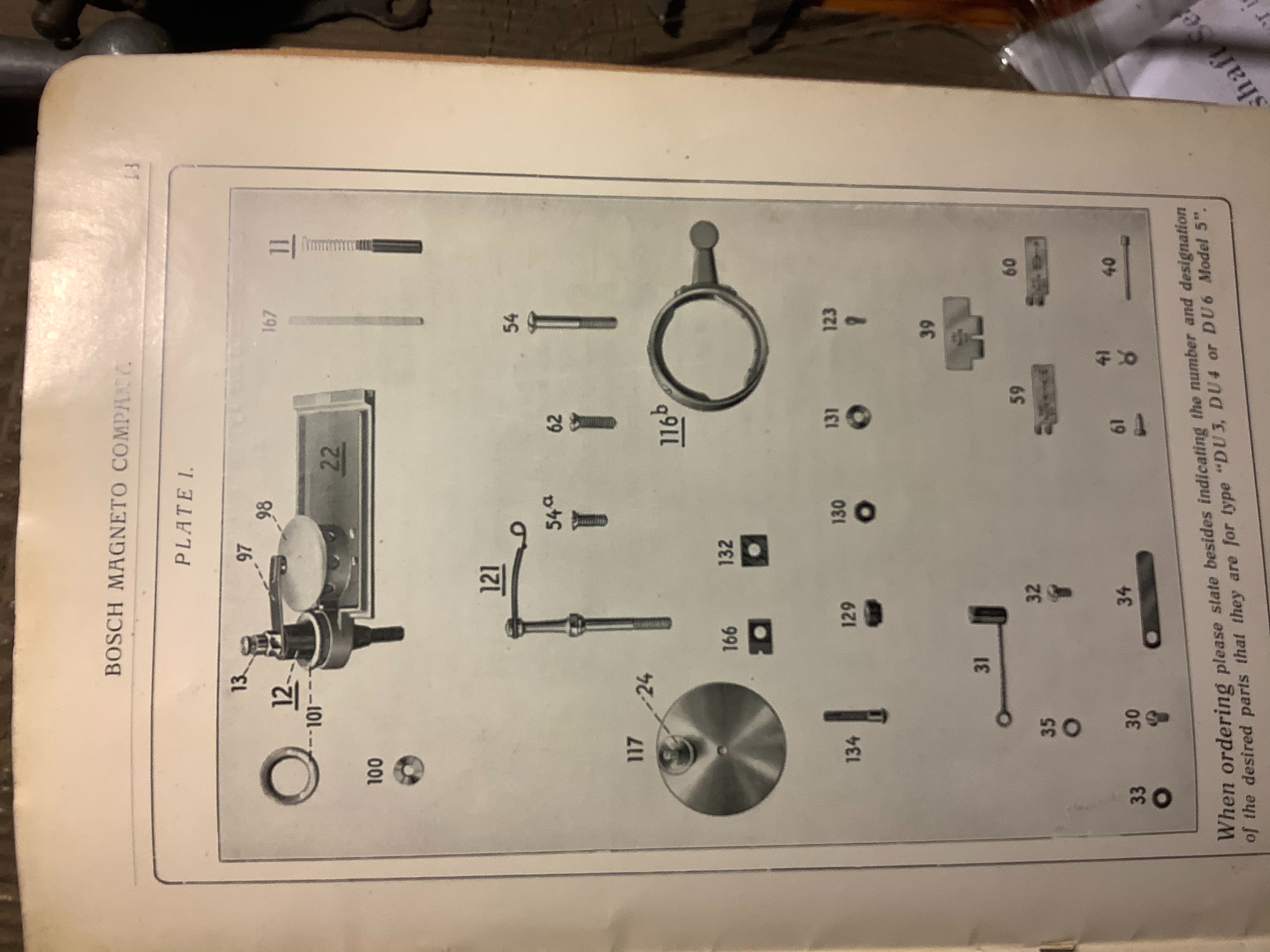

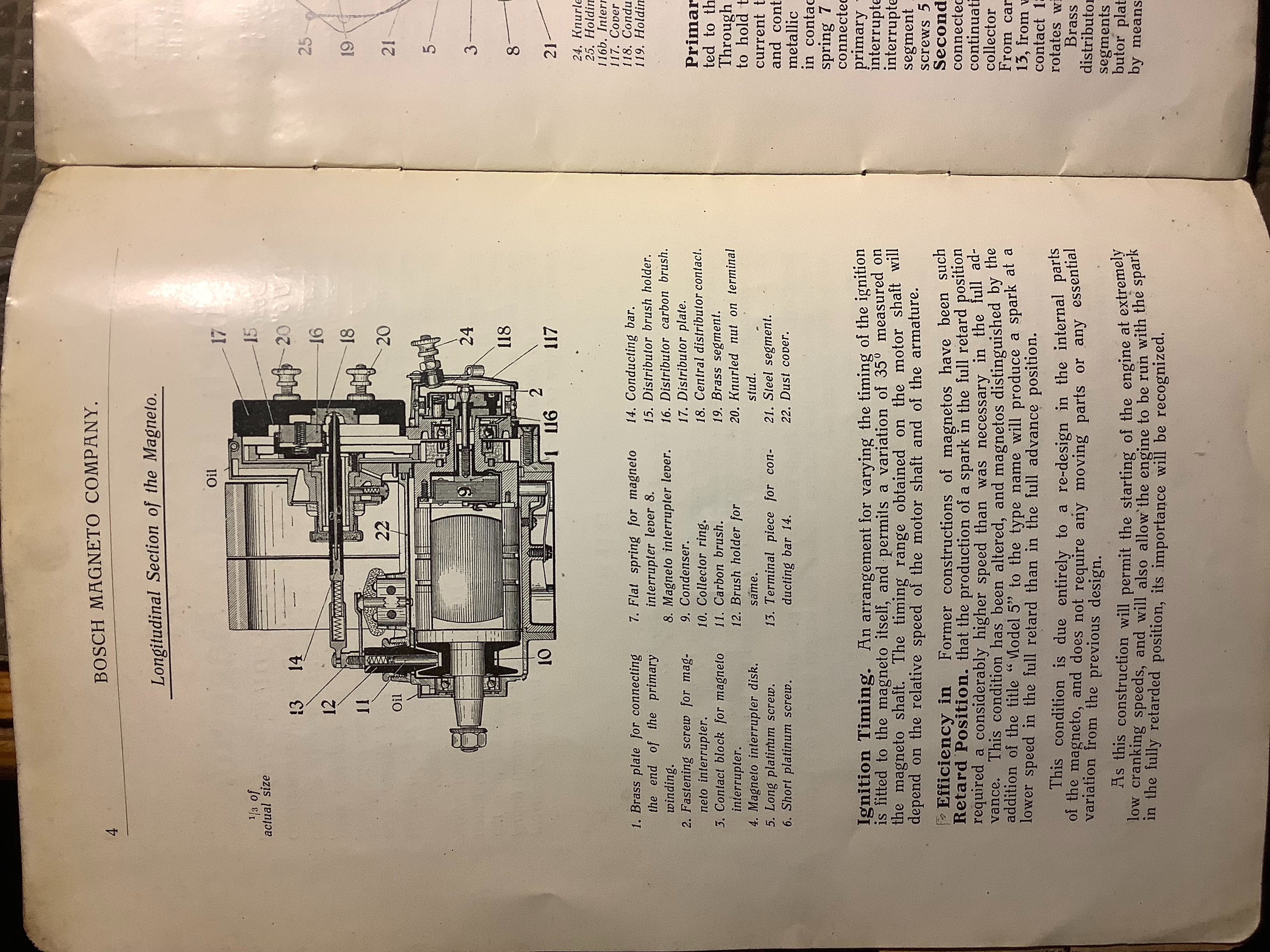

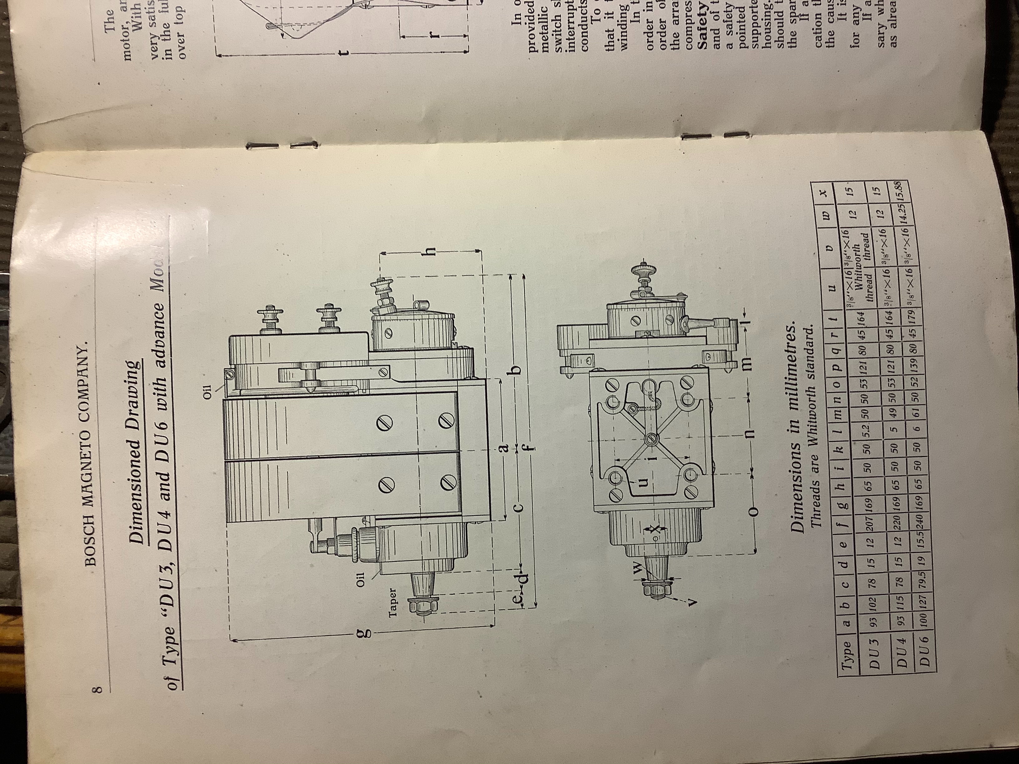

I’ll post the manual for the DU4 here, Duey. Feel free to pass any of it on, but please let me know if I’m incorrect.

Jerry has good advice above. This is what works for me. These Bosch DU4 mags are so plentiful ,that I only buy really nice looking ones. I take them apart, clean very well, especially the hardened old oil. I lubricate them, reassemble , and have never yet had one fail or not perform well. Knock on wood ! Another bonus is you really get to know the mechanics of your choice of ignition. I have them on 4 ts Be prepared to spend $4-600 for getting one rebuilt by a pro. I’ll let someone that has paid to have one rebuilt recommend a rebuilder.
