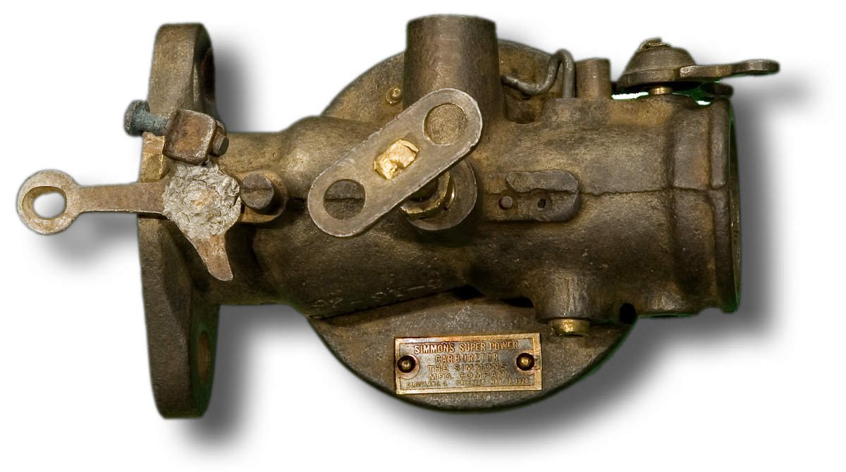

Post by John Warren » Thu Feb 28, 2019 10:08 pm

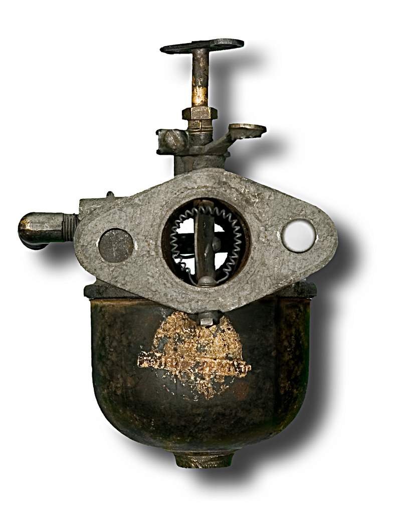

This one?

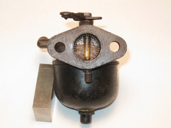

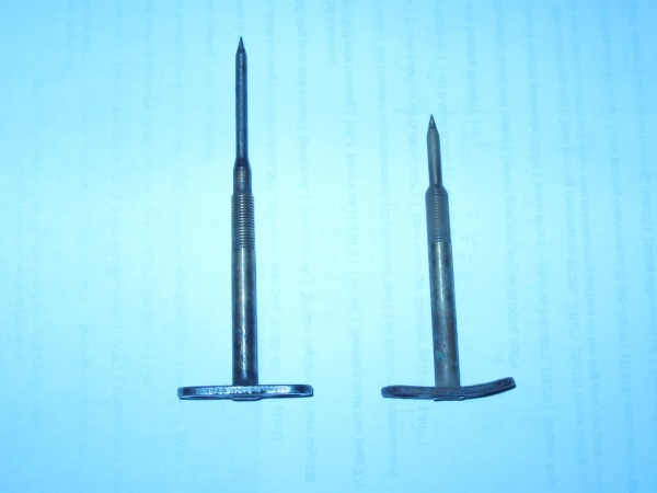

Post by Pep C Strebeck » Thu Feb 28, 2019 11:34 pm
I have one on the car and tell you that they run well. Some have said that they are a "hard" starting carburetor, but I have never found that to be the issue. It starts easily with either the hand crank or starter. As for the flapper, it is supposed to help with the low speed idle to make it run smoother at a lower RPM. The flapper is your traditional pot-metal and is often missing or damaged (swollen and cracked).
As for the parts, most everything is the same as a standard Holley NH. The only difference that I have noticed is the spray needle. The standard NH needle is on the left and the one from a Simmons is on the right:
This difference has been noted on 4 different Simmons Super Power carburetors that I have had (also the Western Auto version as well). The only other difference is the wire heating element at the mounting flange just past the throttle butterfly.
Hopefully this is helpful.

I was going to ask what that wire was for, because this one doesn't have one, but it does have that flapper and it moves pretty freely too. So does anybody know what height the float is supposed to be set to? Or is it set like the Holley's?

A good photo of the decal. Someone should print a batch of them.
It mentions “power and speed” so a good restored Simmons with a nice decal would probably bring about double the price of a straight-thru Holley.

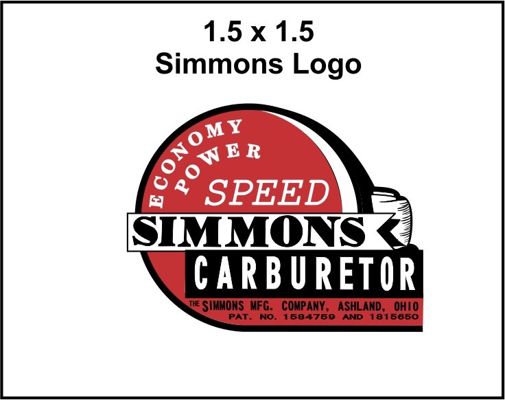

As near as I can figure, this is what the carburetor bowl logo looks like.

I think I need to rework that logo a bit...just got a new sample.

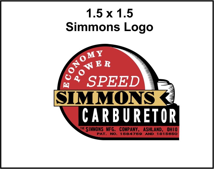

Ok, revised logo...I think this is closer to the original than my previous attempt.

And given that the SIMMONS banner may be a different color other than white, I'm thinking it was some sort of gold color from the way it faded on that carb picture.

Ok I got to looking closer to that logo and saw that there was some sort of shading round the ball as well as on the banner end, so I modified the last one slightly...let me know what you guys think, if this one is closer to the actual logo or not. It didn't make any design sense that the black right edge was so bloody thick, so I took a closer look and yep, there was shading there. I laid in a shading band to see if it looked more like the one on that carburetor bowl and also had to lay in more on the banner end also to even out the black on that side of the logo.

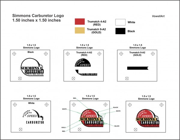

Post by VowellArt » Sat Mar 02, 2019 10:26 pm
In the interest of reproducibility (because you'd never be able to make a half tone like the one I just did above and make it come looking correct) I did this one removing ever other line. This way the line shading is defined and will reproduce easily.
Remember to make this logo you need to do separation and spot color the seps. If you want I could post the seps here with the spots too, it would be easy for me, because the art is vector art.

For those of you who are interested, this should do it. :)

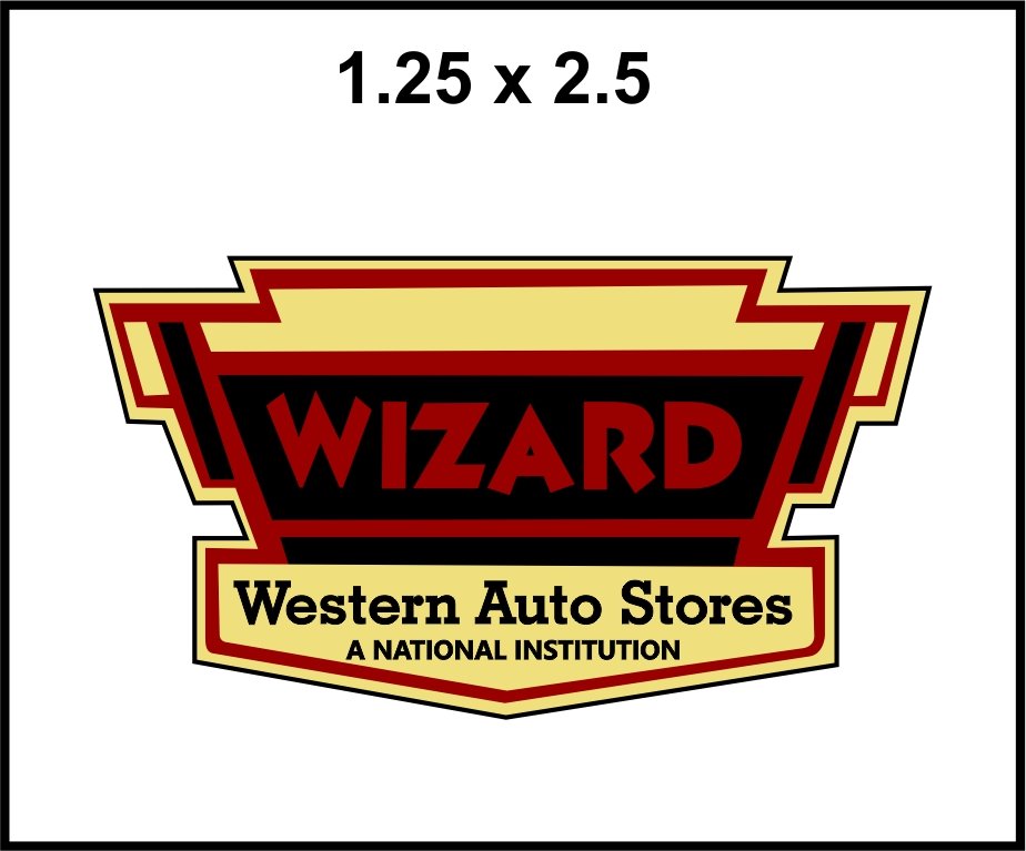

Is this the Western Auto Logo for the Simmons Super Power Carburetor? This carburetor was referenced in the old forum in August 2009
http://www.mtfca.com/discus/messages/80 ... 1257224811 And Eric Hylen referred to the carb as "Western Auto Wizard Imroved carb for Ford cars. "
This is the only logo I've been able to come up with that has the Wizard name on it.

Not sure about the Wizard model...I am sure, everything Western Auto was Wizard.
Seems my grandfather had a lawnmower with that Wizard logo on it.
Beautiful work Martynn :)

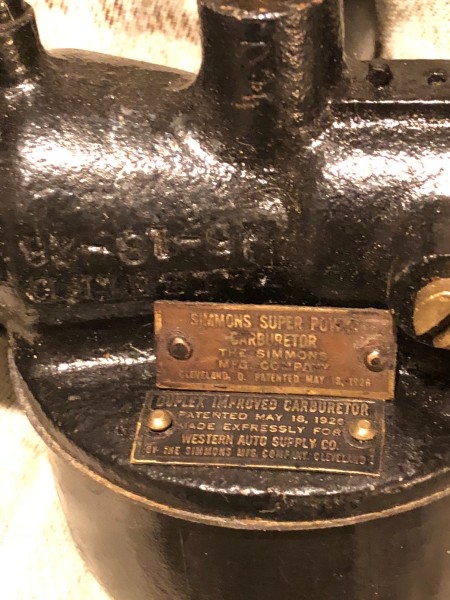

Post by Corey Walker » Wed Mar 06, 2019 11:42 am

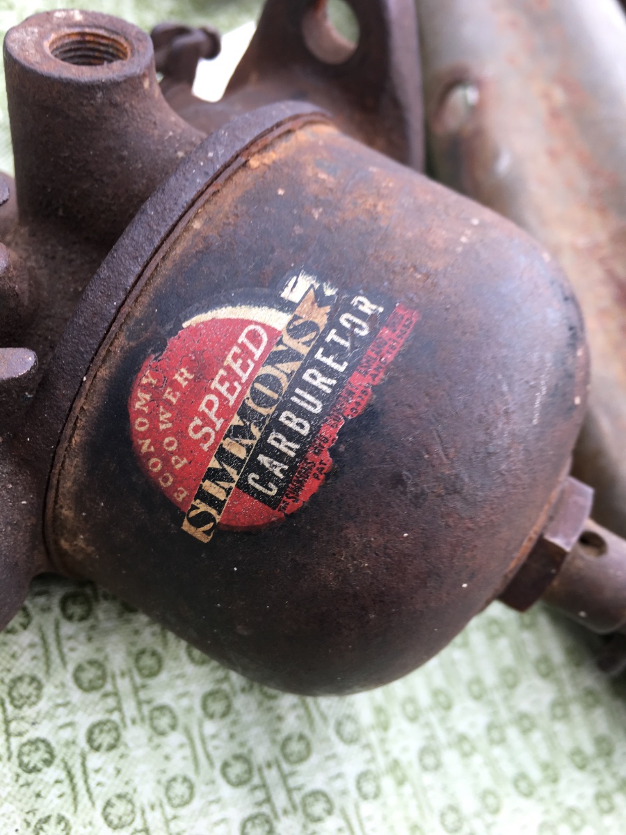

I’ve got 2, one with a Simmons tag and the other with a tag Made for Western Auto by Simmons. The one with the plain Simmons tag doesn’t have patent dates cast into the body. Decals were long gone when I got them.

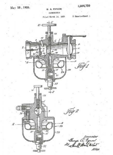

Post by VowellArt » Sat Mar 09, 2019 11:32 pm

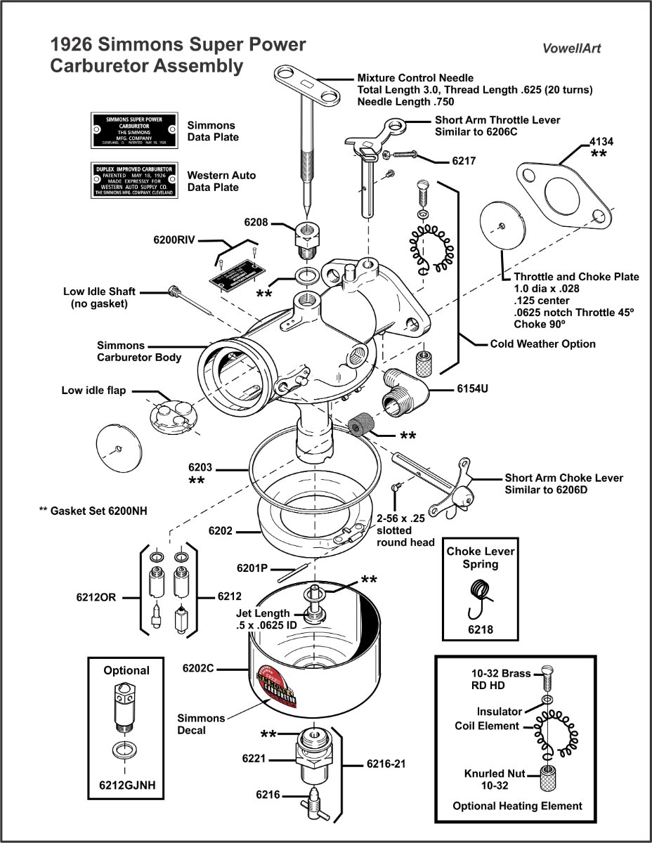

Ok, here is the Simmons Super Power Carburetor, with the heating element as an option. It seems that not all Simmons came with one...the one I've got having been sold here on the West Coast, didn't have the heating element, the place where it installs has a plug that is removeable, if you chose to buy the element option or maybe they sold the plug with the carb incase you wanted to uninstall the heating element.
A lot of the Holley NH parts will fit, some may need to be modified slightly, but where I wasn't sure I gave the measurements (in the hope that helps).
Anyhoo, I think I've covered all the bases here, but if there is something I've missed, let me know.

Correction...the battery died on my mic (yes, I've got a digital one), just put in a new battery and got a different reading on the thickness of the Throttle and Choke plates....0283
I know it is sort of unnecessary, but thought since I had to correct the original, might as well post the correction here too.
