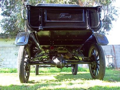

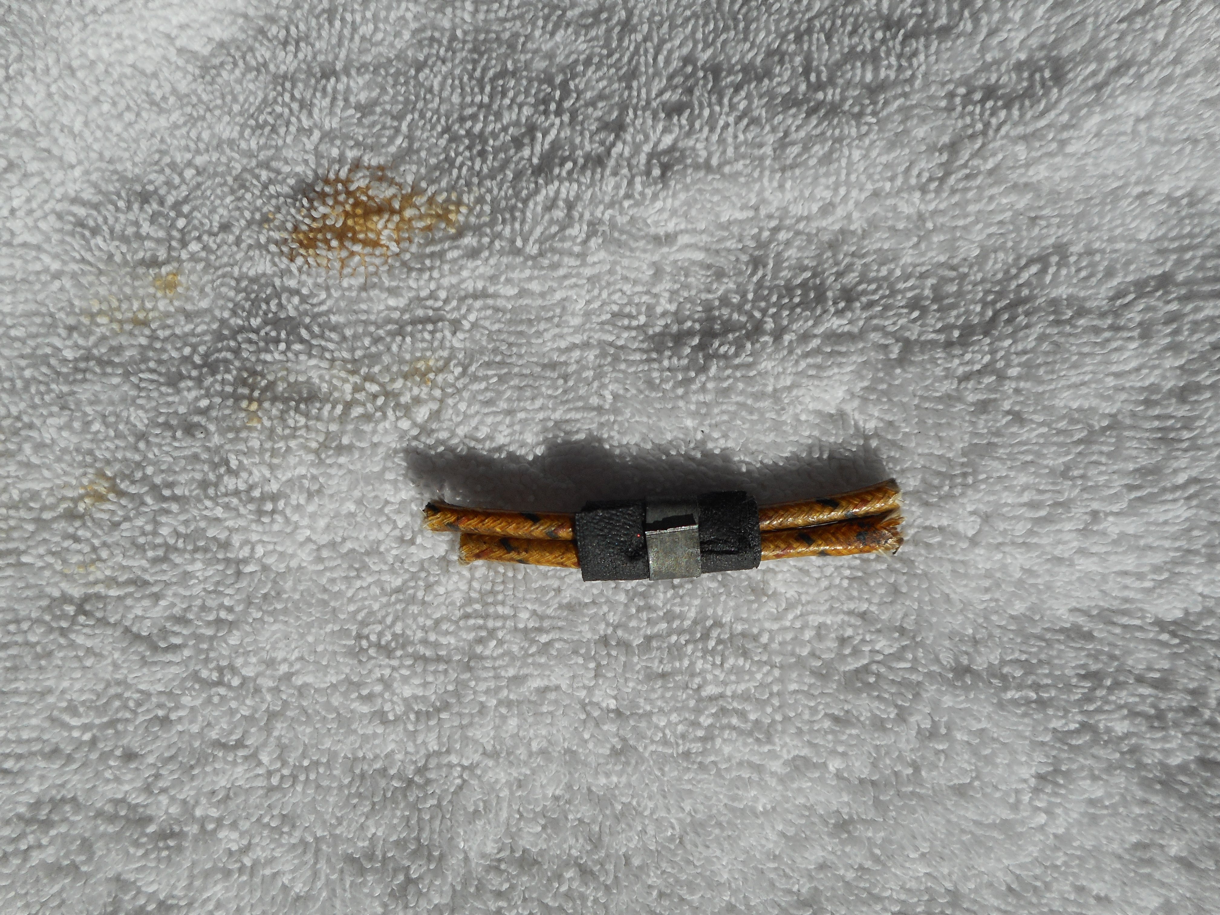

Here is a setup I used on my 1925, to convert it to a stoplight. I'm using a factory taillight and license plate bracket. The bulb is used for Model A cowl lights to convert them to turn signals. I have to file one tab off the bulb to do this. I don't know why Snyder had to put an offset tab on this bulb, but that's Snyder for you! The license plate bracket is a Ford product, but must have been made after Model T production. It has a socket just like the headlights. If you hold it up to a light, you can see through it. I use a double filament pronged plug, which is spring loaded and old stock too. A single wire plug is available too. I've seen these at swap meets for years, especially at Chickasha. It works, but is not authentic, but looks like it. He is what I did with the extra wire going to the stop light. A '26-7 could be done the same way. It keeps the two wires together, and is old fashioned looking too. I used friction tape in a half dozen places, and used a piece of sheet metal, probably 20 or 22 gauge, 1/4" wide. Of course the wire in the example is not the correct color code, but you get the idea.

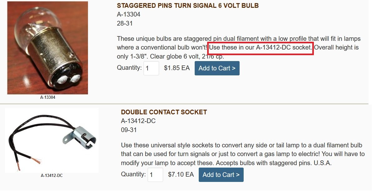

If these were the bulb you ordered from Snyders they specified for use with the socket they sell having offset pins. Model T sockets are designed for straight pins and dual filament bulbs have offset pins - done to prevent putting the wrong bulb in the wrong socket.

That’s quite a distance way under the pickup box. Have you thought of bringing it to a place where it might be more easily seen?

I have to agree. Isn't there a 26-27 rear fender bracket?

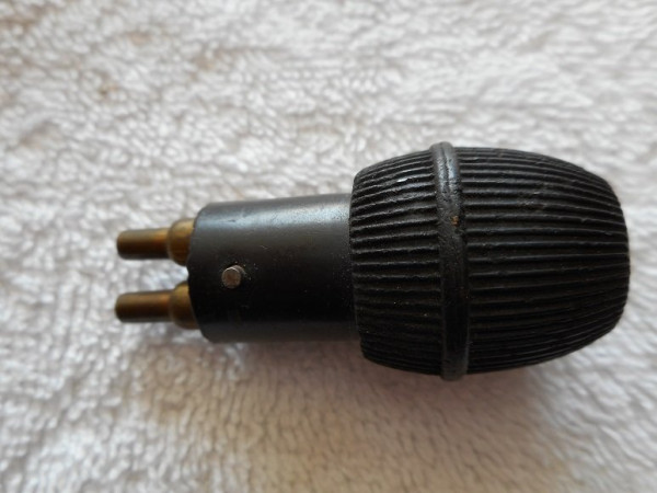

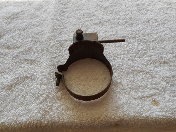

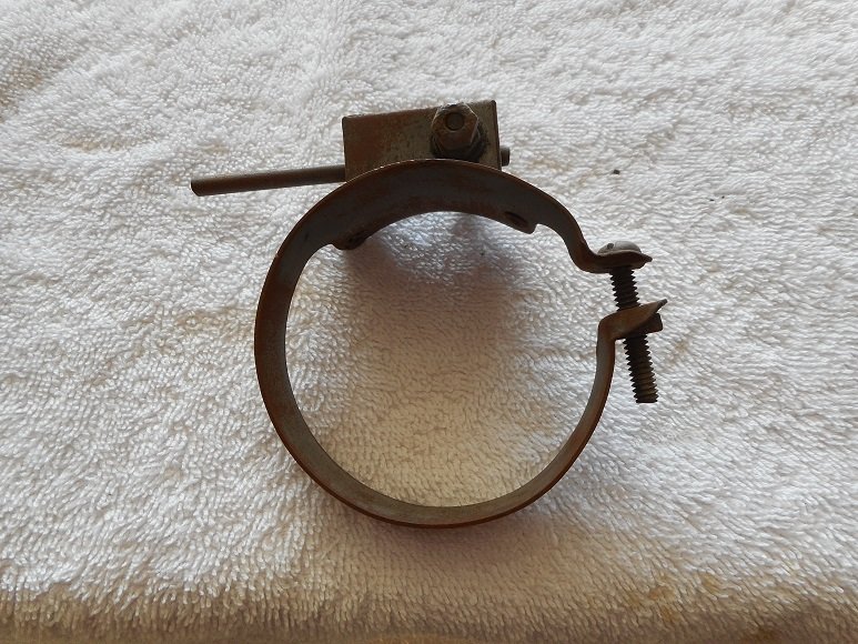

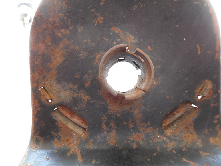

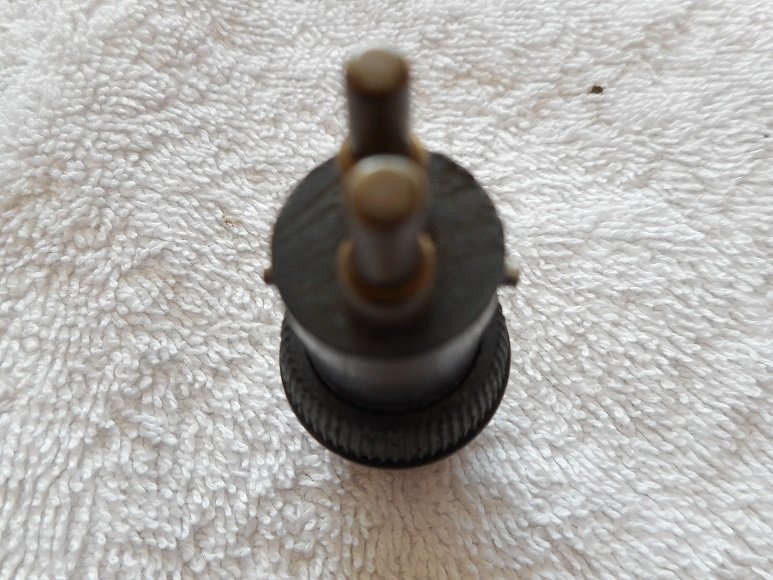

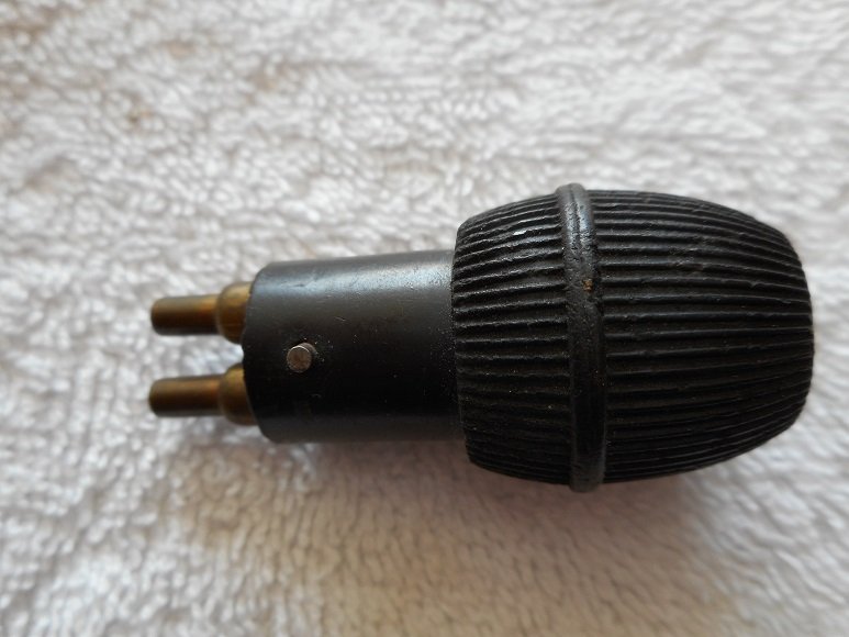

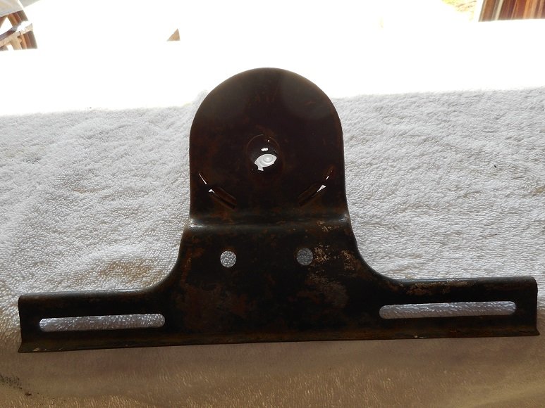

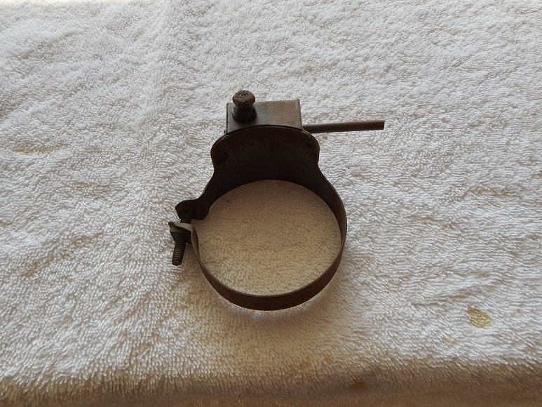

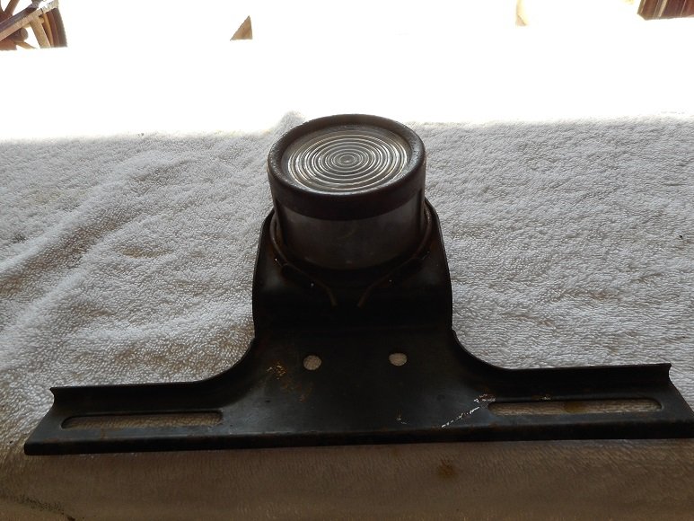

Here are the photos of the parts I used to convert my stock 1925 taillight to a stop light. As I mentioned I can't see any difference between the original, and the one I used, except for the straight through socket. The one in the picture is not the one on the car, but is a spare that I have.
