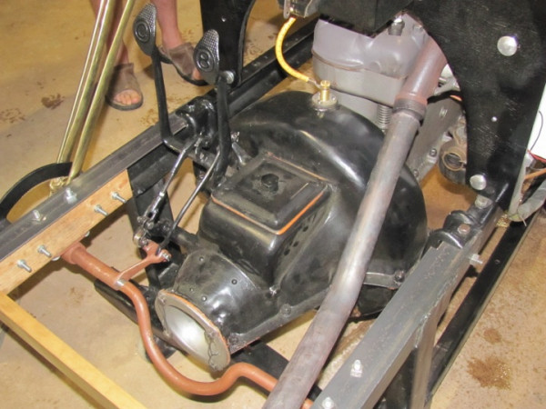

Post by VowellArt » Sun Dec 20, 2020 2:44 am
Does anybody have any pictures of a completely disassembled Hogs Heads (and I mean the Model T Parts, not some bloody pigs head), that is without pedals and or any of the other parts on or in it? Any and all of them I'd like to have pictures of and what I need is front, right side, rear and underneath and the years they came from. I'm especially interested in the 2 lever 1909's.

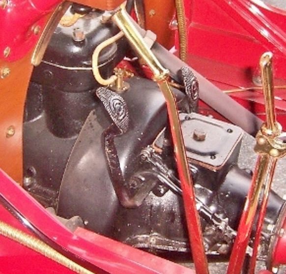

Post by DanTreace » Sun Dec 20, 2020 9:24 am
Martynn

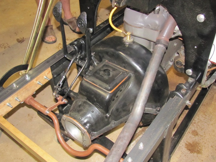

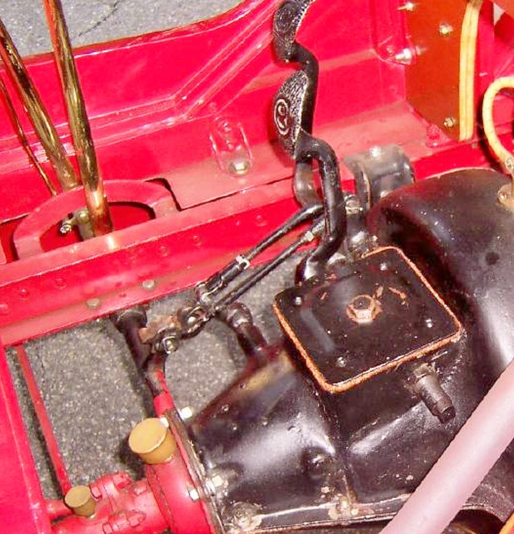

Some views of two-lever early 1909's hogshead.
100_8978 (500x376).jpg (169.34 KiB) Viewed 3879 times

Dan, Much appreciated, these are great (especially that last one, very clear as to what is going on). By the look of that linkage, it works like the brake lever in later cars, kicking the Hi/Lo pedal into neutral, I noticed it also has another arm on it that works the reverse band but uses a lever instead of a pedal to engage Reverse. In the last picture you posted (the one without the body), there appears to be a bell crank lever just above the Hi/Lo shaft, do you know what it is for? Also there doesn't seem to be any adjustment for the Hi/Lo pedal at all (or is that the adjustment for the Hi/Lo pedal?) no threaded shaft with jam nut like is on the other two you posted. Also noticing that the two in the car don't have that bump on the back of the inspection cover tower either...is one of these earlier than the other?
Also the hogs head itself appears to be stamped metal not cast, would really be interesting to see the inside of one of these, do you also have pictures of their insides? I'd like to know what those 4 rivets are for on the back. Do you happen to know if there was a RHD version of the 2 lever? Wouldn't think it would be that difficult, that slip shaft linkage part would be on the other side with the control arm also opposite of where it is in the picture, as all the shaft bosses would be too.

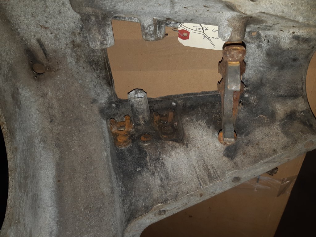

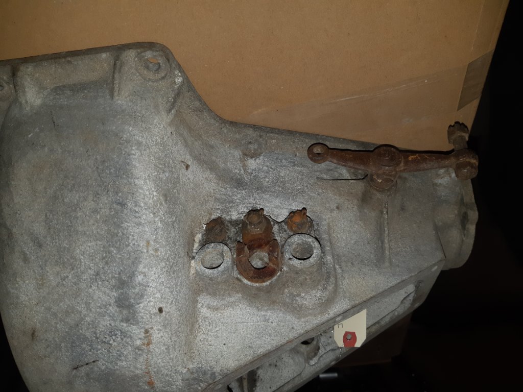

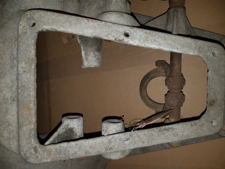

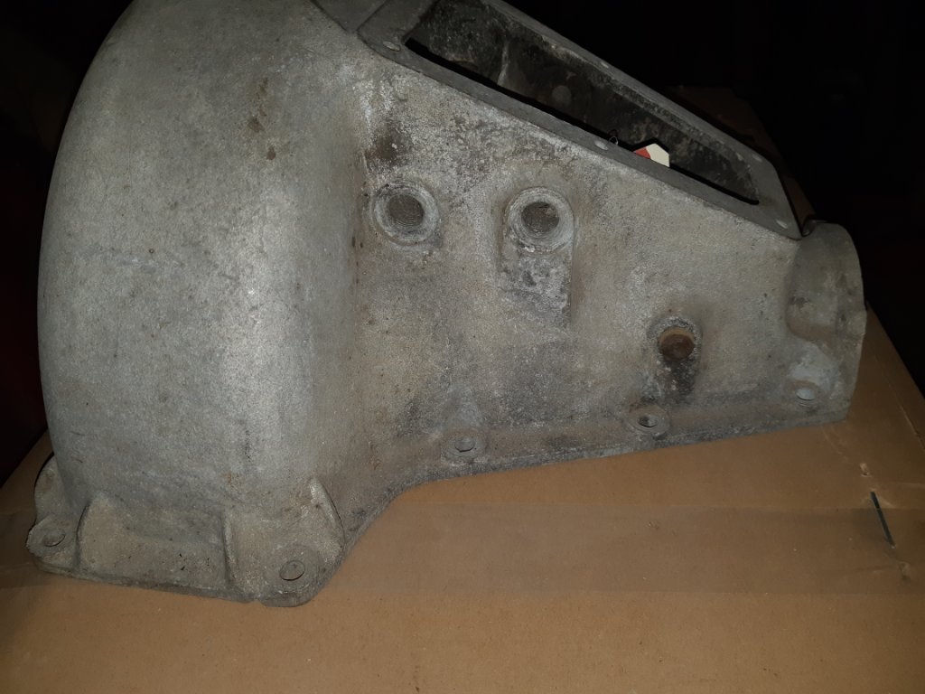

Post by nsbrassnut » Sat Jan 02, 2021 6:03 pm
Hi All
Based on comments in the book "In The Shadow of Detroit" Ford US didn't start shipping T parts to Canada until March of 1909 (reference was Detroit shipping invoices) and that barely 500 were even assembled in Canada during that model year, so I think the chance of two pedal Canadian, RHD is likely very low. I do know that by the time the late 1910 models with the cast aluminum hogs head did come in RHD as I got to view and photograph one a couple years ago.
Here are some pictures of the '14 - '16 Canadian RHD aluminum hogs head with the most of the parts stripped off for comparison. The casting shows mold lines around the right hand side where the pedal mounts are which suggest to me where th LHD patterns were modified to make RDH models.
Sorry about the upside down pictures, the system likes to flip some of my pictures.

Post by VowellArt » Sat Jan 02, 2021 8:50 pm
Thanks Jeff, this is exactly what I needed to know, good pictures too. I see what Allan was saying about the adjusters being on the outside for the brake and reverse and the Hi/Lo being on the inside of the Hogshead (just the opposite of the domestic cars).
