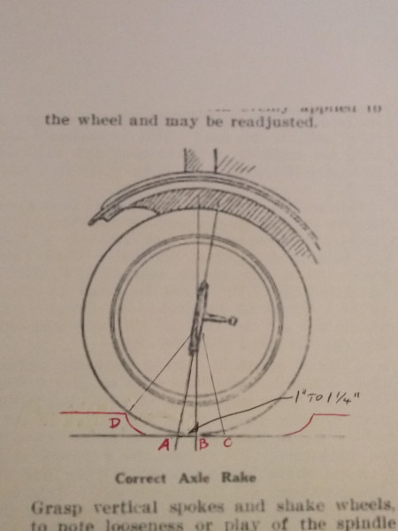

Have you measured the castor, camber, and toe in? An alignment problem can cause it to pull. A common problem with the early T's with the wishbone bolted above the axle is caused when you hit a curb or pothole hard. Even if you have not hit it hard in over 100 years, someone could have done so. This will bend the spring hangers causing the change in castor to what is called negative castor. Think of the castors on a chair. The axle is always behind the wheel as you push the chair. If you happen to push in the direction of the axle, the castor will spin around. Same thing happens to the car wheels. The top of the axle should be tilted toward the back of the car and the bottom toward the front. If it is bent, it will have negative castor. The camber and tow in are mainly used to keep the wheels going straight ahead when you are not turning.
In the Ford Service manual paragraph 147 page 45 the castor is called Pitch. To measure this park on a level floor, preferably a concrete slab. Place a square with one leg on the floor and the other against the axle right against the spindle body. From the front of the car measure the distance between the spindle body at the top and at the bottom. The difference should be no less than 1/4" nor no more than 5/16" The top should be leaning toward the back of the car. If it is not within these measurements, it must be bent to fit. I have not personally had to do this, however, you would need a tool similar to a large pipe wrench with a very long handle, perhaps, with a piece of pipe on the handle and use as a lever to bend to fit.

Is the wishbone holding the axle firmly with approximately 5 1/2 degrees of positive caster? (That was explained in more detail by Norman above -- Thanks Norman). Originally a 1909 to 1919ish would have the above the axle wishbone but sometimes they are replaced with a below the axle wishbone and/or braces below the axle are added to the above the axle wishbone.
Is the ball on the end of the wishbone that fits into the engine pan have minimal play but still free for the wishbone to move as the front spring absorbs bumps etc.
How to check the front axle caster to make sure it is not set too low. More positive caster makes the car's steering more stable going forward but more unstable backing up. Never back up fast in a stock T as by design the wheels tend to go full left or right when backing up. That is because "IF" you have the correct 5 1/2 degrees positive caster on the front axle -- when you are going backwards it has the effect of being 5 1/2 degrees negative and the front wheels want to go hard left or right. In the USA we have shopping cars that have casters on the front. And if I move the cart reward, the front wheels on the cart will turn around. The posting at: http://www.mtfca.com/discus/messages/29/40382.html shows the paragraph Norman referenced. It also has how to use a plumb bob and pencil to do the check instead of a square.

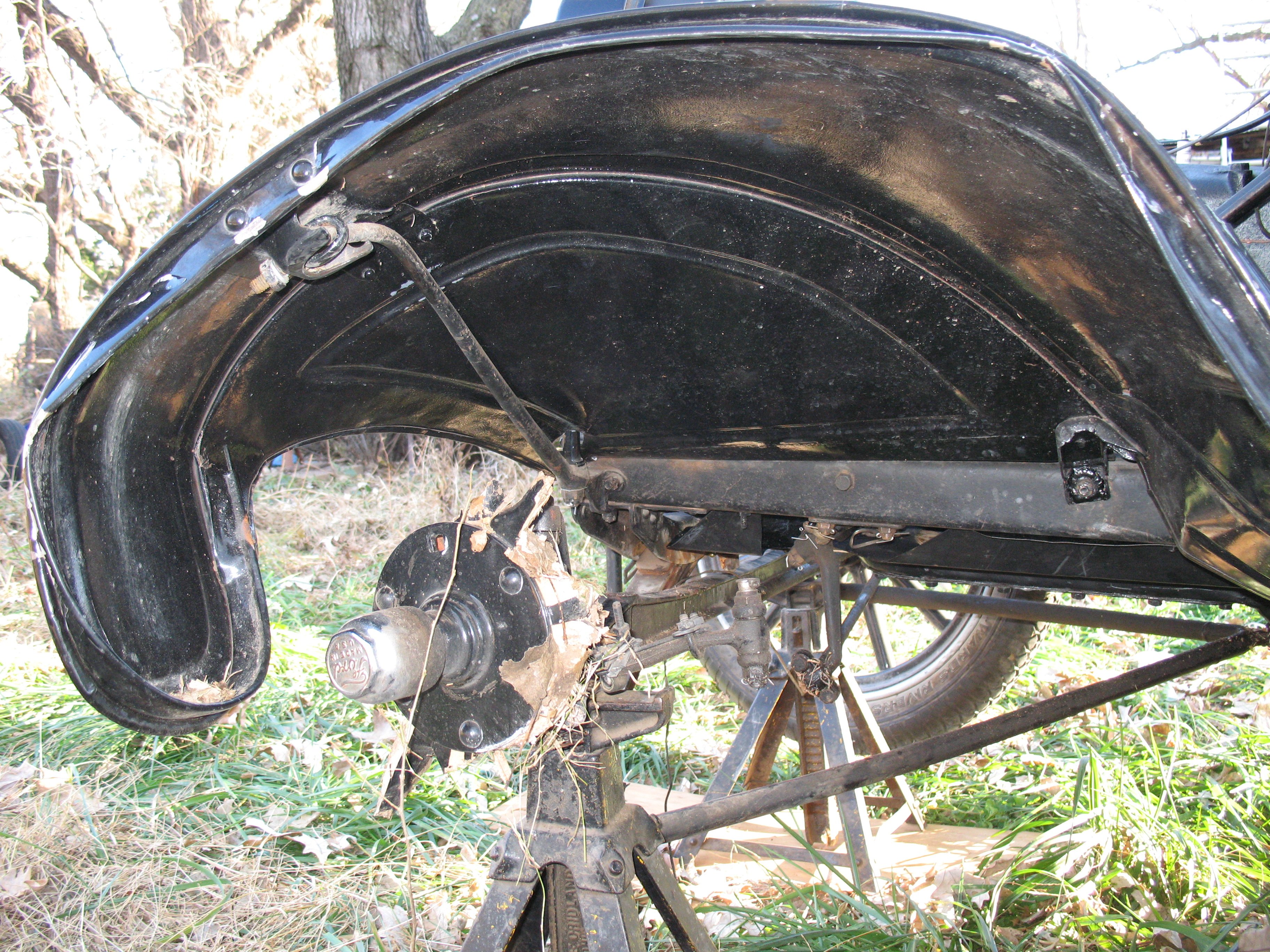

Be very suspicious of your wishbone if it's the "over the axle style". What you describe is not a "small" problem.
From a recent posting of mine....
I test drove my friend's 1914 just after he bought it. Seemed fine until I made a left hand turn. Both front wheels swung hard to the left, nearly causing me to hit a stopped car. If I hadn't been on my guard to begin with, it would have been a collision. When we got back to my friend's house, I looked over the front end. All looked fine. Then I turned the wheels left again, with the car standing still, and saw the whole front axle roll forward. It actually was as if it were wanting to roll under the car. It caused the caster angle to go from normal to maybe 15 degrees the wrong way, (i.e. forward).
Turned out, the studs at the ends of the wishbone, along with the holes in the perches, were completely worn out and sloppy loose. The axle didn't just move by the amount of the excess clearance however. The arms of the wishbone actually rotated torsionally as the axle rolled forward. Hard to describe, but freaky to watch and scary to drive! So yes, it was largely a matter of totally worn out parts, but it also demonstrated the dynamics of what occurs when the wishbone fails. I don't believe that they just bend or break, (though I'm sure that some do). I believe that even a wishbone in good condition can rotate in the perches and twist, allowing the axle to "go under", when an out-of-the-ordinary force is applied. It was a convincing demonstration. That car now has an excellent wishbone, nos perches, and an under-axle brace.
Jem

As Hap has quoted me at length (Cripes! am I now a grey-haired T guru?) I'll put in my two-pennyworth.
Sounds very like the problem I described, but it really only happens at parking speed, because it is right at the limit of applying lock. You need to look at all the other suggestions if it happens at any reasonable pace and moderate lock. But it doesn't sound like the horrific mess that Jerry was faced with.
The late Ralph Ricks and I both thought the dangers of the top-mount wishbone were exaggerated and felt the blame for some accidents was due to the T's very quick steering ratio. Ralph fitted a 1937 steering box on his Great Race car. Try this: jack up the front axle, hold the steering wheel while an assistant pushes against a front wheel - you won't be able to stop the wheel being pulled from your hands. That's what happens when you hit a pothole. Look at this sketch: point B is the normal tyre contact and the difference between that and point A gives positive castor. Go into the pothole and point D becomes the tyre contact - sudden massive negative castor and wheel can be torn from your grip. That said, I have survived 40 years driving the car. But I fitted one of these some years ago: it does what it says on the box. Jack up my front end and you cannot move the road wheel by hand, you have to use the steering wheel. Potholes are not so scary now.

Jerry's description of a worn wishbone and perches allowing front axle fold-under certainly rings a bell with me. I have experienced the same runaway steering with an under-axle wishbone when a lost perch nut allowed the front of the wishbone to go loose. It put me in the ditch, destroyed a wheel, and crunched a fender and splash apron. I now pay particular attention to those nuts and cotters.
