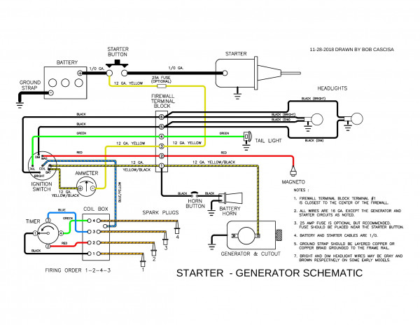

This is from a post in 2014, and gives the spec of the current to the horn:
reproduction horns and they are made to factory drawings for all but the motor parts so the diaphragm, brackets, motor cover...etc all will interchange with original so if you need anything new other than the motor, I probably can help you. I make the new diaphragm out of stainless steel so it won't rust out. The horn was adjusted for maximum loudness at a draw of 5 amps from a 6V battery.
So you might want to check the amps that your reproduction horn draws when the horn button is pushed. And check too that bracket for the horn is shaved clean at the block and head mounting brackets to be sure of a good ground. Plus, check that the positive wire from the hot button to the terminal block on the dash is connected to #6 terminal, the yellow/black wires, these come from the generator, that is the best amp connection for the horn wire.

Do you use a horn relay? What size wire are using to feed (+) to the horn?

The color-coded wire to the horn is part of the wire loom purchased for the '24 Coupe. It's the same size as the other wires in the harness, so it must be correct.
What kind of relay would I need to purchase to boost the volume? Brand name? Store? Part number?
