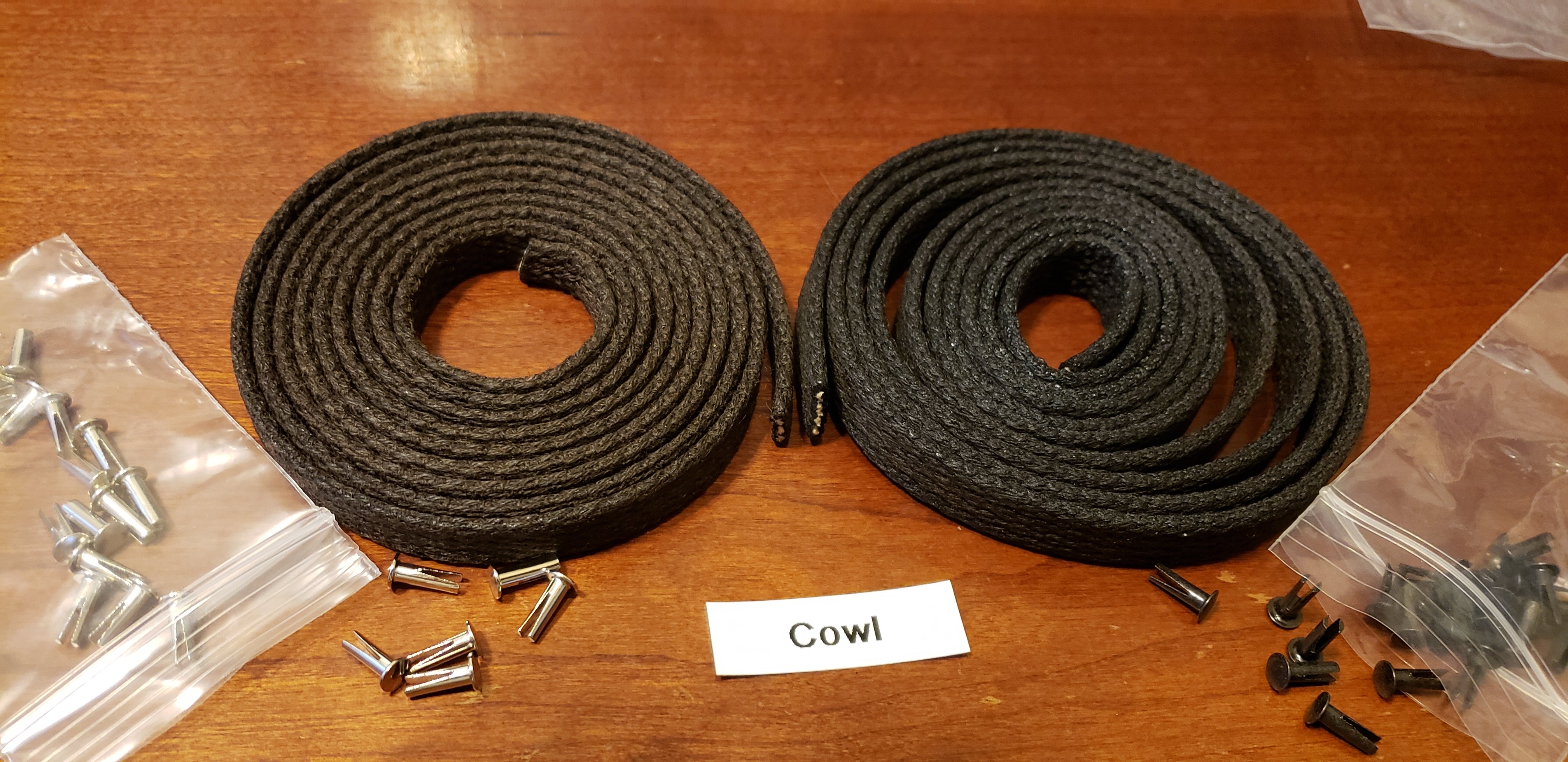

Which of the two cowl lacing sets would be correct for 1924 steel firewall? The one on the left is 3/8" the right is 1/2"[/size][/b]

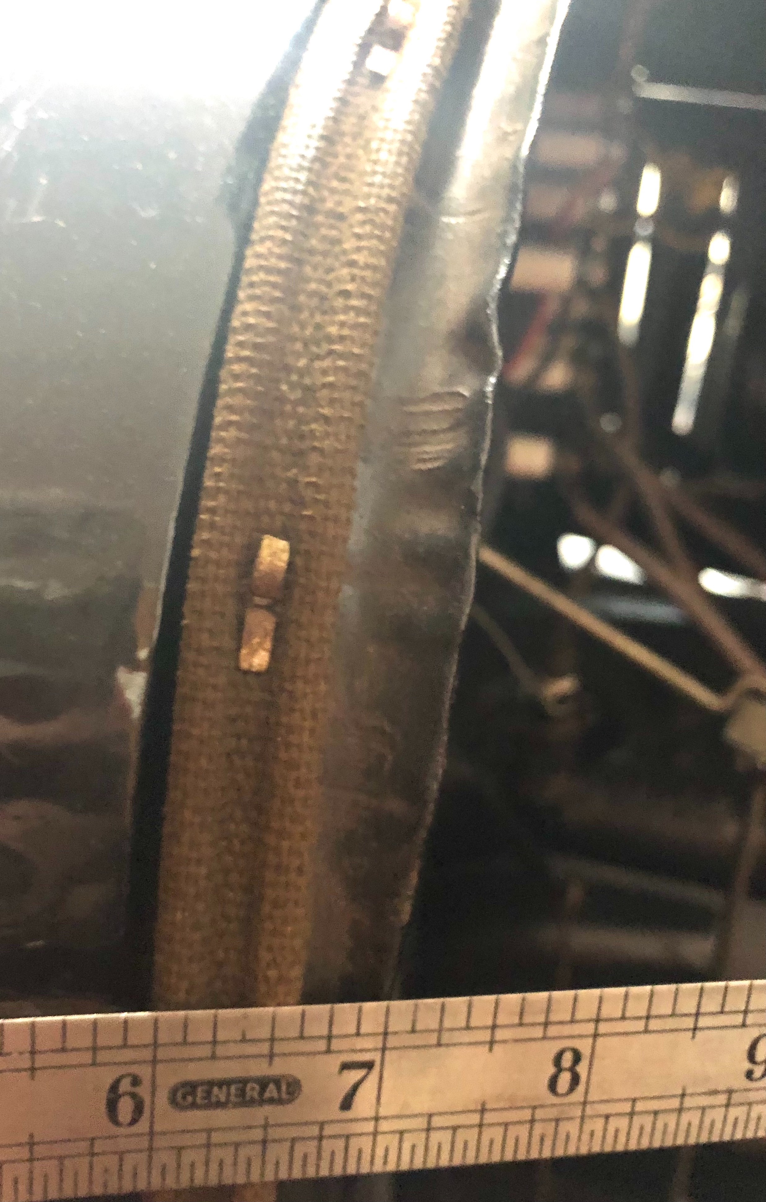

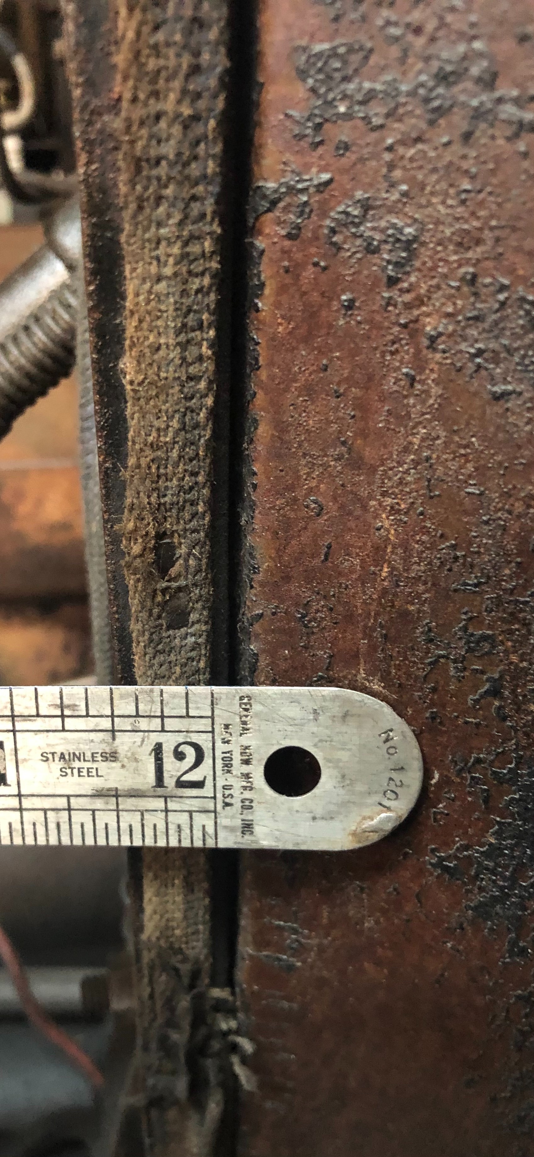

The flat 3/8" is correct for '23-'25 steel dash. Typical install by factory line folds the split rivet into the fabric, just like a transmission band.
Original flat lacing on my '23:
On my '24 used the later '26-'27 style double bead lacing, that is wider, thicker and has center space to fold the rivet tangs to keep them below the lacing. But it does let the hood sit a bit higher and adjustment to the hood clip springs is needed by countersinking the holes in the hood shelf wood blocks a tad deeper!

Also like to mention that both sets came from vendors marked "Cowl Lacing" with rivets so could not be mistaken for radiator shell lacing

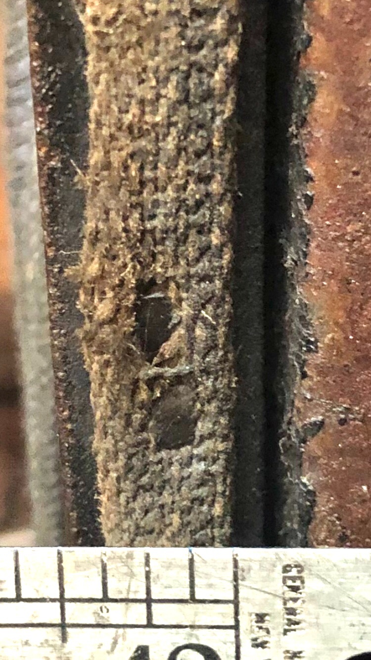

Daniel
Close up of 1923 original low steel dash (firewall) lacing, the split rivet tang is folded into the lacing. Head of rivet on metal underside. Just like tranny band lining install.
