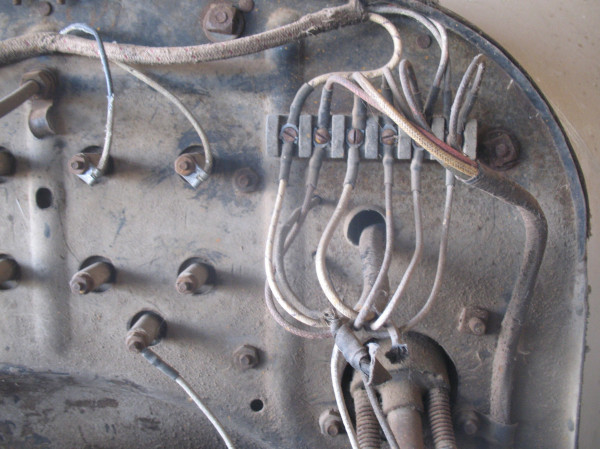

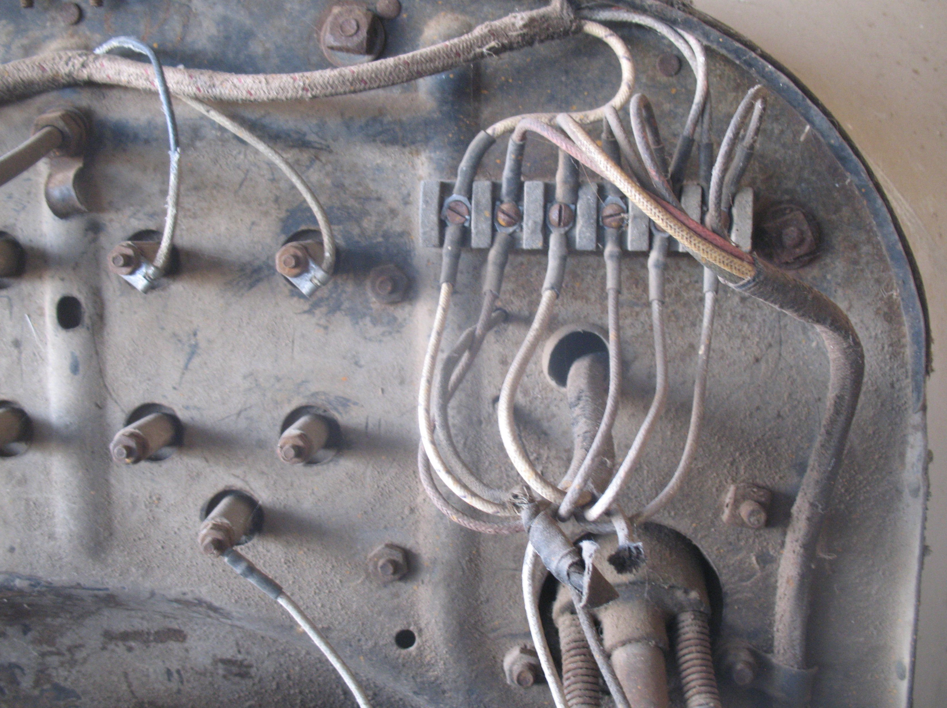

Post by Steve Jelf » Sat Dec 26, 2020 11:56 am
1923 Fordor
Posts: 7351
Re: Ignition Switch wiring harness routing
Post by Steve Jelf » Sat Dec 26, 2020 12:03 pm
If your car has a hole above the terminal block I expect it's a 1924 or 1925 model built after August 1, 1923. Confusion over the year of a Model T is very common. People often misremember what they're told.
