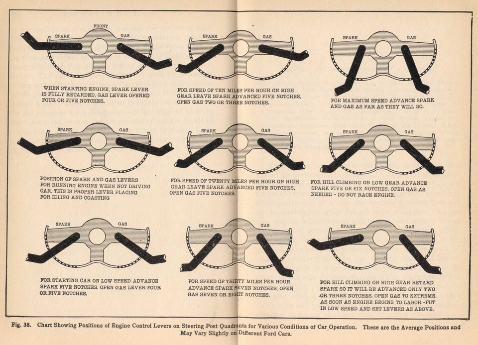

Post by jiminbartow » Fri Dec 25, 2020 11:47 am
Speaking of synchronization the levers...

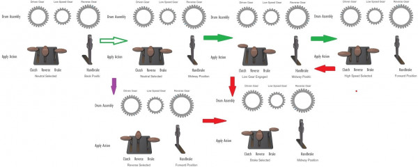

Post by TRDxB2 » Fri Dec 25, 2020 6:49 pm
This link has animation of how the gears engage as you change position of the handbrake lever and pedal usage . The animation may take a little bit of time to load t hen you can click on the handbrake and pedals
https://www.modeltcentral.com/transmiss ... #animation
Try these sequences and watch the drive gear. I welcome criticism of the sequences - thinking pictures help

The chart Jim posted showing many different throttle and spark lever positions applies to running on battery. When running on magneto there are only three spark positions. It's customary to start on battery and switch to magneto, in which case you can forget about the chart. Just move the lever down to where the car runs best.
