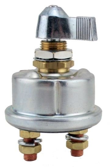

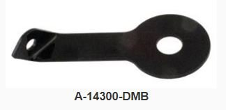

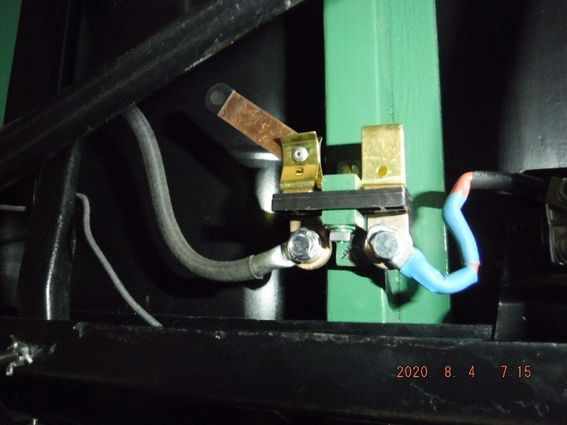

Battery cut-off switch should always be installed on the Ground side of the battery, whether its positive or negative ground for the reasons stated above.
I recently bought this one from Snyders with the bracket but have not figure out where it mounts. I'll have modify it .

- cutoff sw.JPG (28.62 KiB) Viewed 8212 times
- battery cutoff brket.JPG (12.25 KiB) Viewed 8212 times

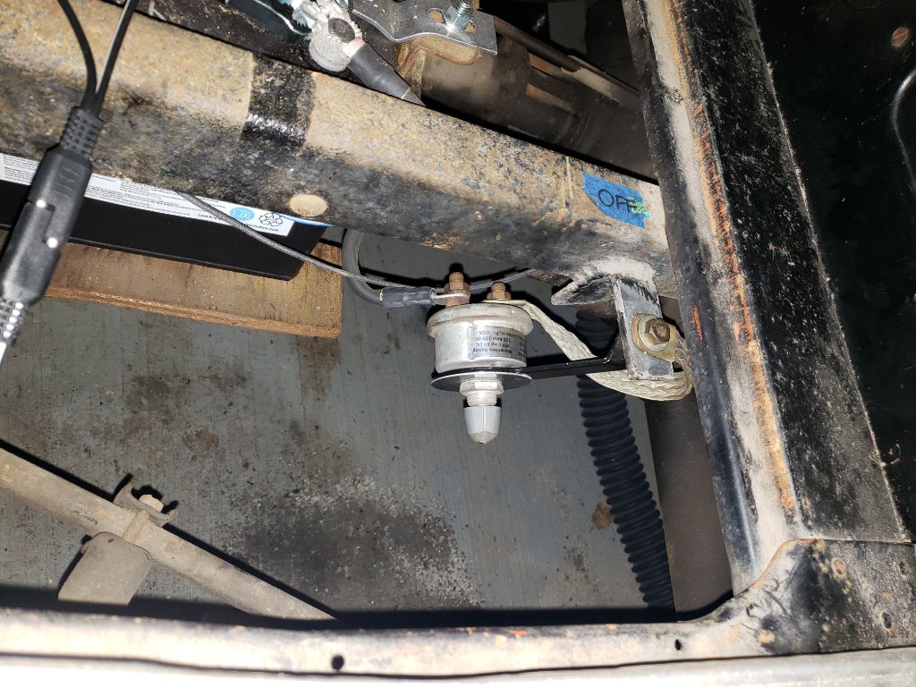

I have several - all negative cable connected. Touring is mounted in the rear floor board corner, Racer's is in the steel floor panel at the bottom near the front seat panel.

My 26 touring came with one like jsaylor posted. It is mounted on the seat riser between the drivers legs. It saved me from tearing up my starter and ring gear teeth when the cheap repo starter button shorted out and the starter would not stop. Flipped the disconnect switch off, then I disconnected the starter lead, flipped the disconnect switch back on, hand crank started and was on my way again.

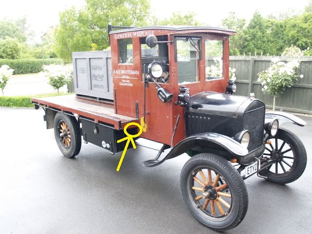

My 2c worth is to make sure it is easily accessible. On the front of the seat upright is a good place.

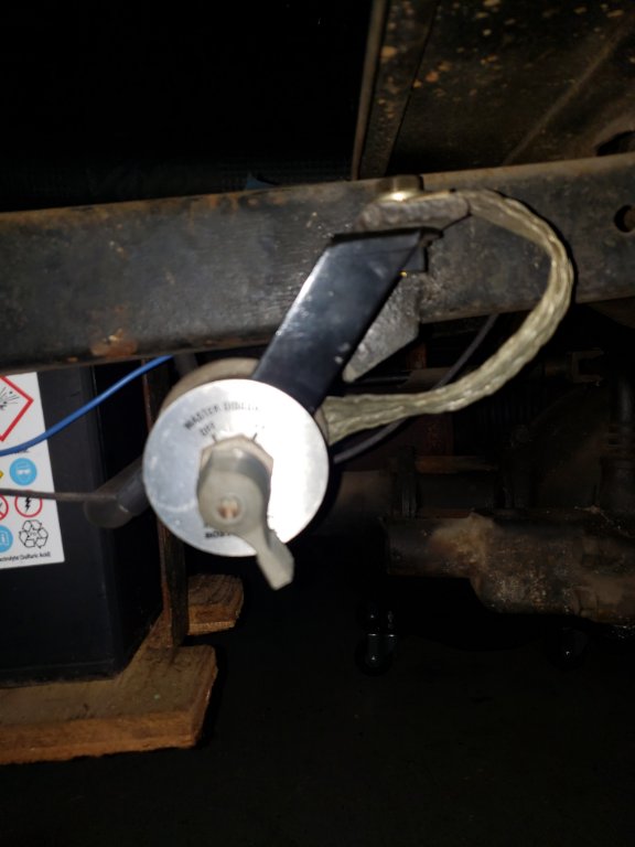

I have one of the rotating switch versions on the truck mounted on the wooden battery/tool box:
When the horn button jammed by the time I got out of the truck, ran around and turned it off I came very close to fire in the wire! that was a close shave. (This will start a discussion on master fuses as well....)

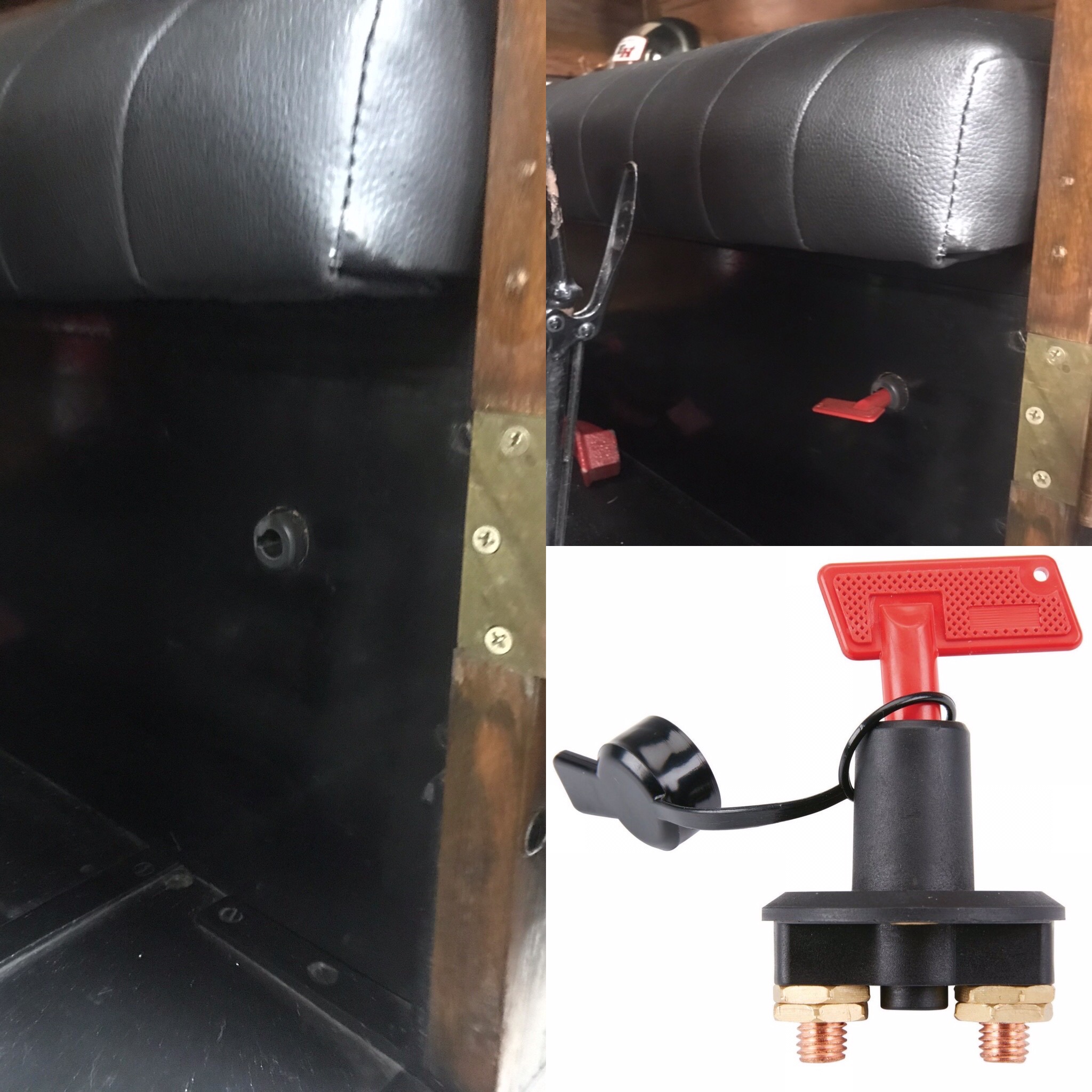

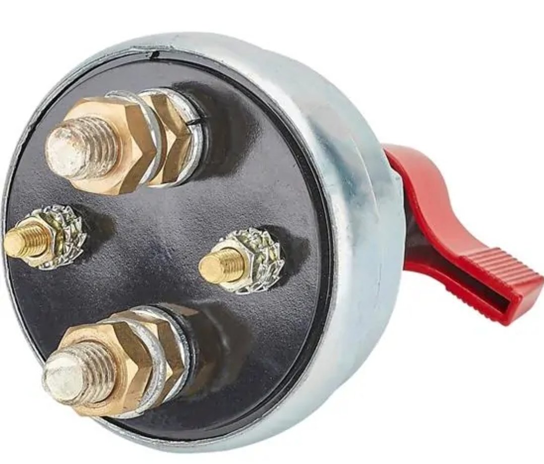

Just as a suggestion, you might want to try one of these from HFT (I know, I know it’s HFT)
as they can be mounted below the floorboard or behind the front of the seat remote from he battery. The only piece visible when you remove the key is the tip of the black pipe, so it doesn’t interfere with the appearance of the vehicle.
I’ve had one installed on my truck for probably 15 years with no issues. I always remove the key from the ignition switch and the battery disconnect at every show.
The removable key also prevents anyone from messing with your machine, potentially turning on lights or other switches.

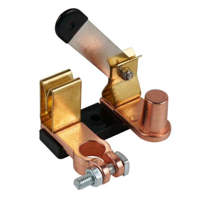

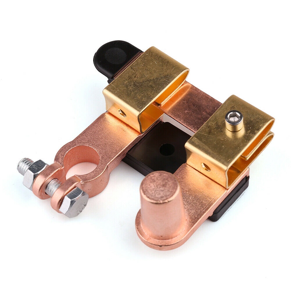

When top clearance is minimal, they make battery cutoff knife switches with a sideways hinged knife. Jim Patrick

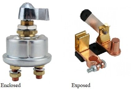

I prefer an enclosed switch to limit corrosion as well as any likelihood of an exposed spark.
As long as the switch controls the primary cable and thus everything from that battery post - either ground or "hot", I can't see how it could make any difference whether that is + or -. Can you explain why it should matter?

My 26 Touring had this bracket on the frame with a hole so I mounted my cutoff and new bracket on it. Not sure if this bracket is original or not. I can reach through the rear wire wheel spokes to turn on and off without lifting the floorboards. Don't intend on driving in weather. Just an idea for mounting.
Mike
Mike

I really appreciate all the interest in the cut off switch. I have learned a lot by listening to experience. I never thought the the initial question would evolve to be like the famous "which oil is best or which polish to use on brass or kevlar is best or cotton for sure". This has been fun. Thanks again everyone for good reading on a dreary couple of days. Dick C.

The battery cut off switch in my truck is fully enclosed, even the cable connections and is attached to the positive side, away from the battery. It is rated at 1000 peak amps, 300 amps continuous. These can be picked up at most auto parts stores.
Vern (Vieux Carre)
