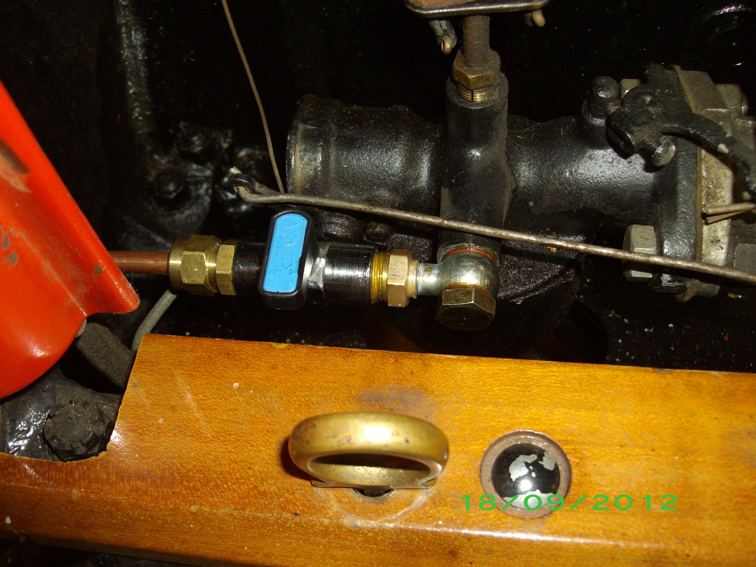

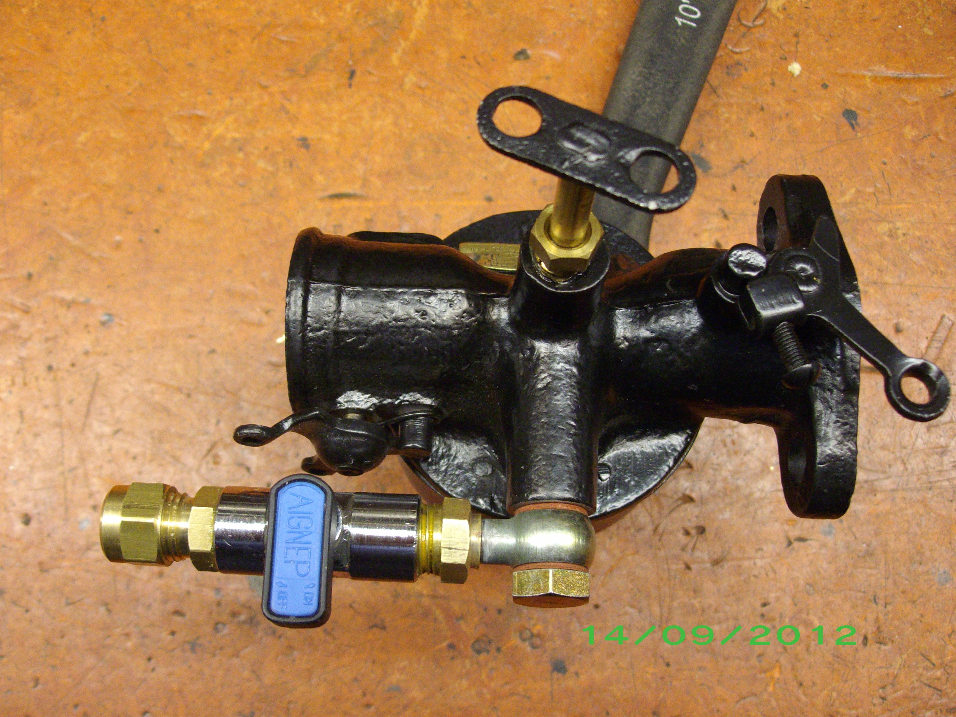

I had that problem with every one of the shut offs. I talked to Lang's and bought a tube of "airplane" lube they sold, it didn't work. Unless you are set on having an original looking shut off, I would go to the newer "ball valve" type. They seal and work!!!

I use this valves for years and they works fine .

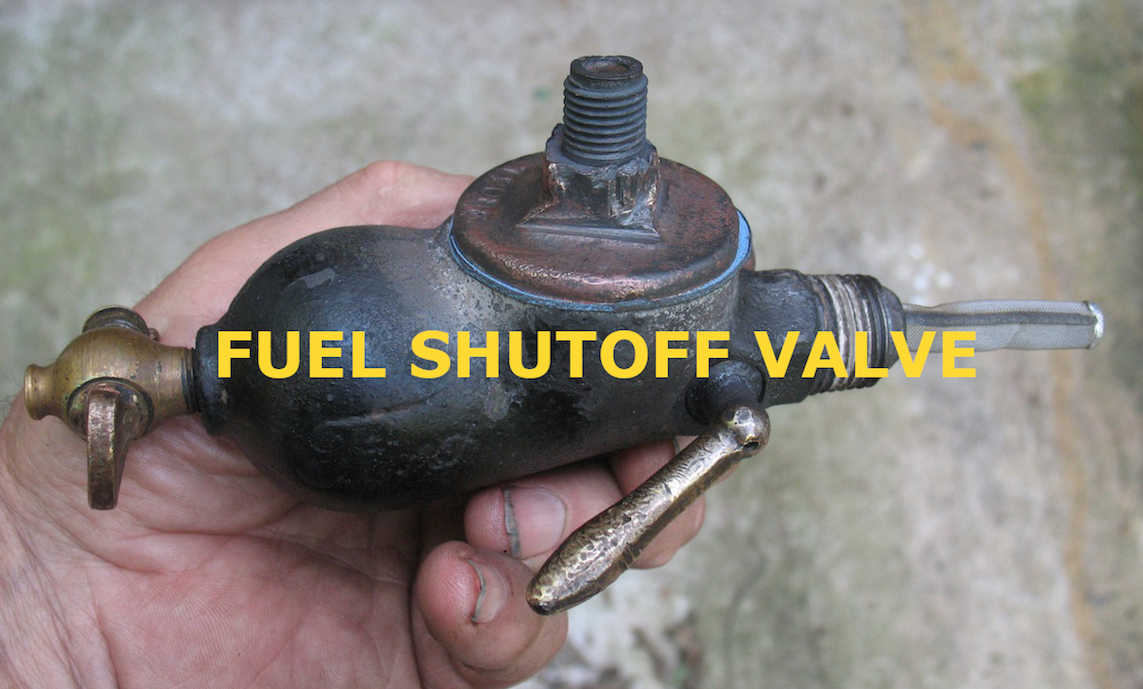

Post by Steve Jelf » Sun Dec 27, 2020 12:52 pm
I didn't like having to use a wrench, and I didn't like the look. So I got rid of it.
http://dauntlessgeezer.com/DG106.html

Where did you get the shut off valve shown in the third post?

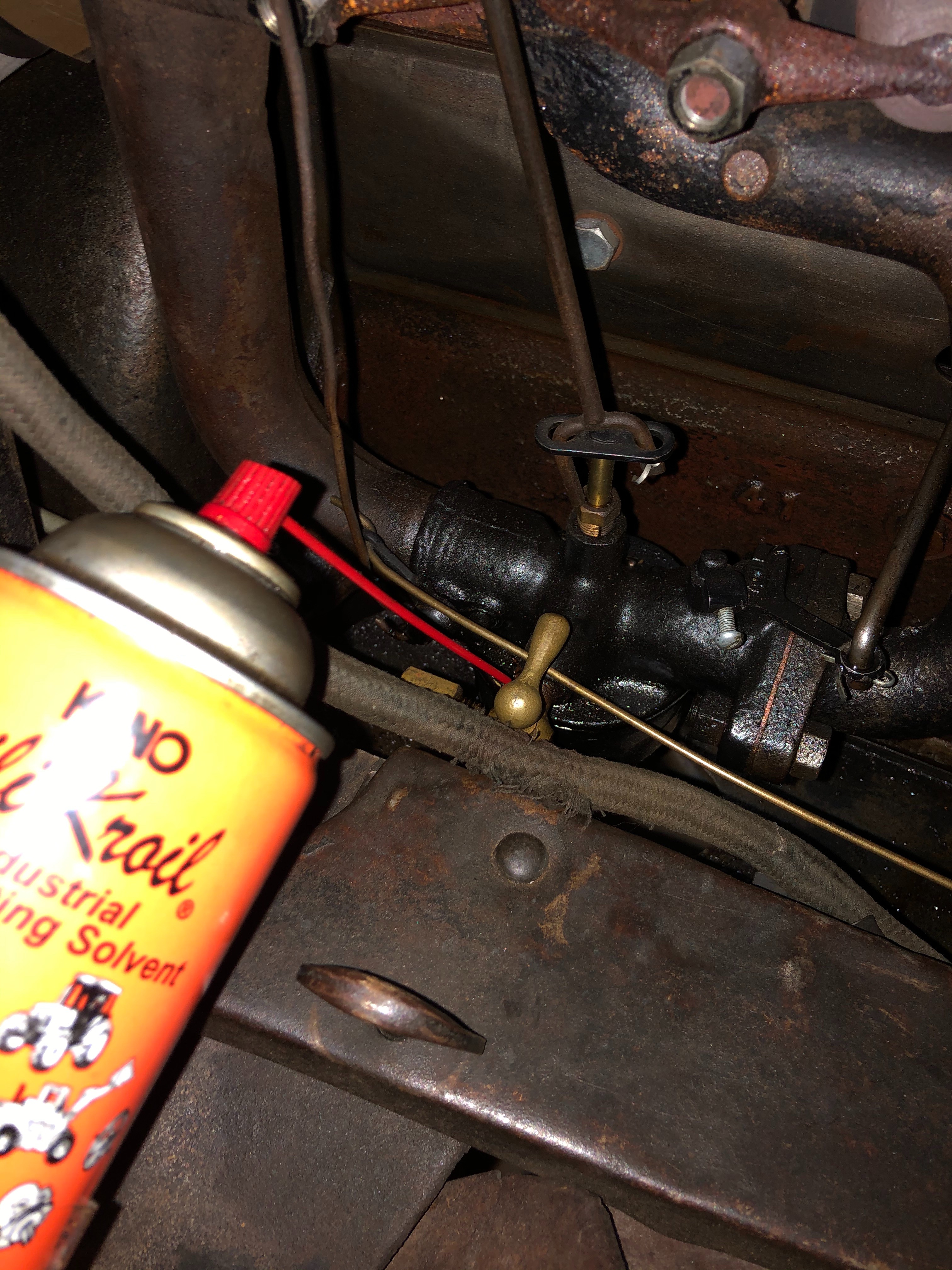

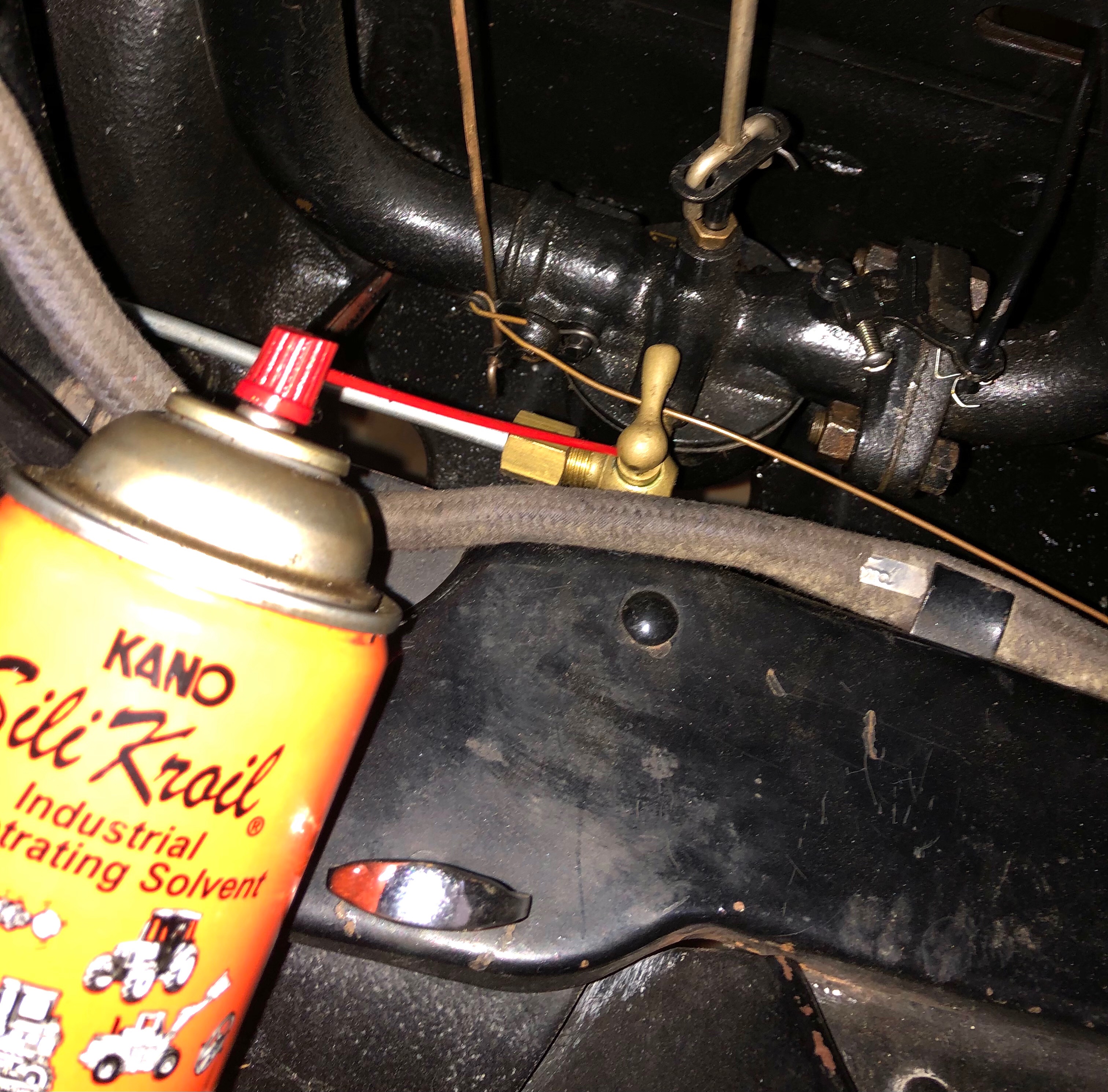

Good timing! My valve at the carburetor has gotten to the point where I almost need a wrench to turn it. I'm going to take it apart this winter and lube it. Fortunately I have a small can of EZ lube left over from an aircraft building project and plan to use that. I'm glad to learn some have had success with it.
