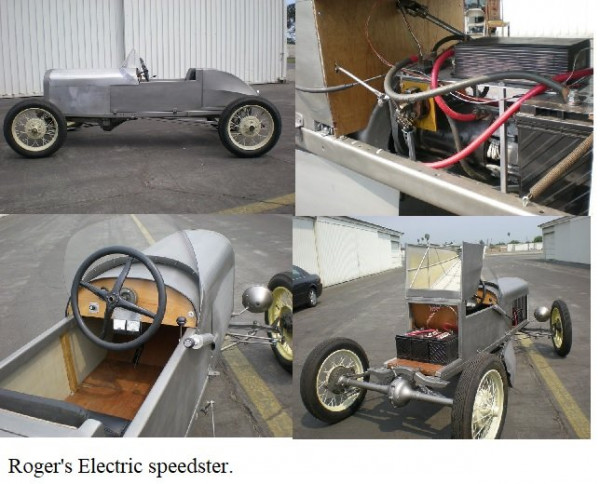

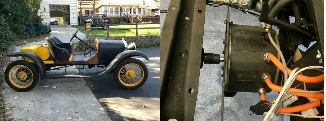

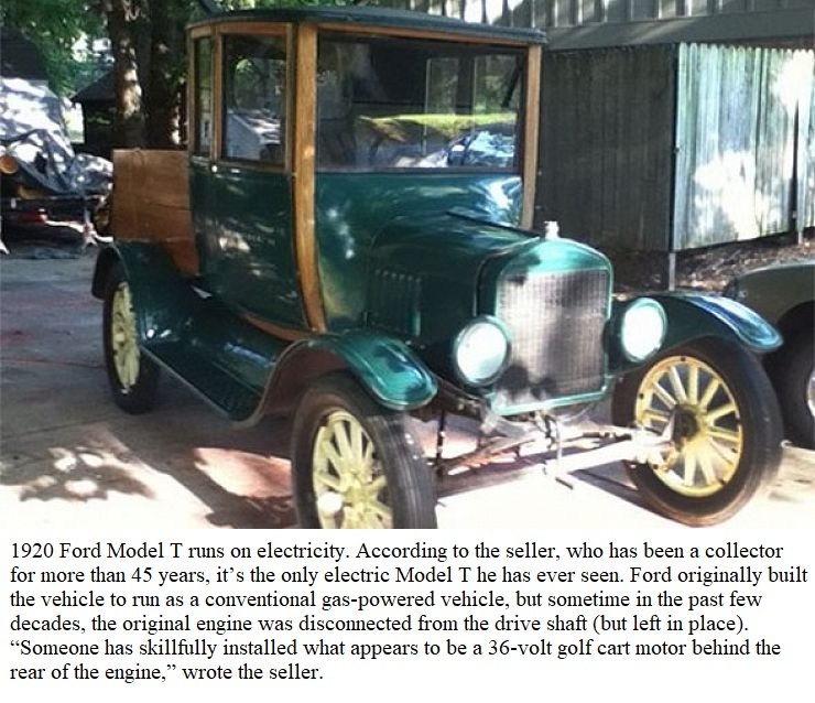

Its was first done in 1913 http://www.mtfca.com/discus/messages/11 ... 1291124879
and most recently https://electricss.com/qa-converted-model-t/ Found several other examples and there are more

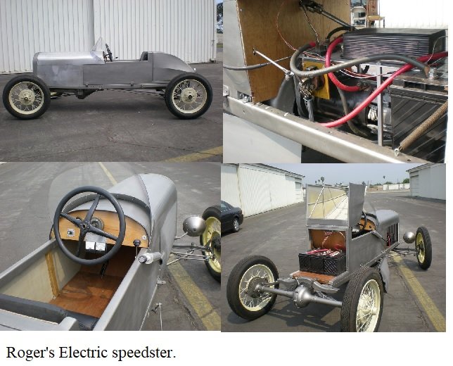

One was for sale on eBay claimed to be an original prototype https://www.ebay.com/motors/blog/green- ... d-model-t/ Speedster versions http://www.mtfca.com/discus/messages/11 ... 1291124879 This one is for sale http://topclassiccarsforsale.com/ford/6 ... ctric.html Not sure if this is available for purchase or if plans are available

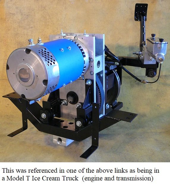

Above looks like just a gear reduction with a disk brake. Very cool and I love this stuff. My background is industrial motion control and I am very interested in building a electric conversion

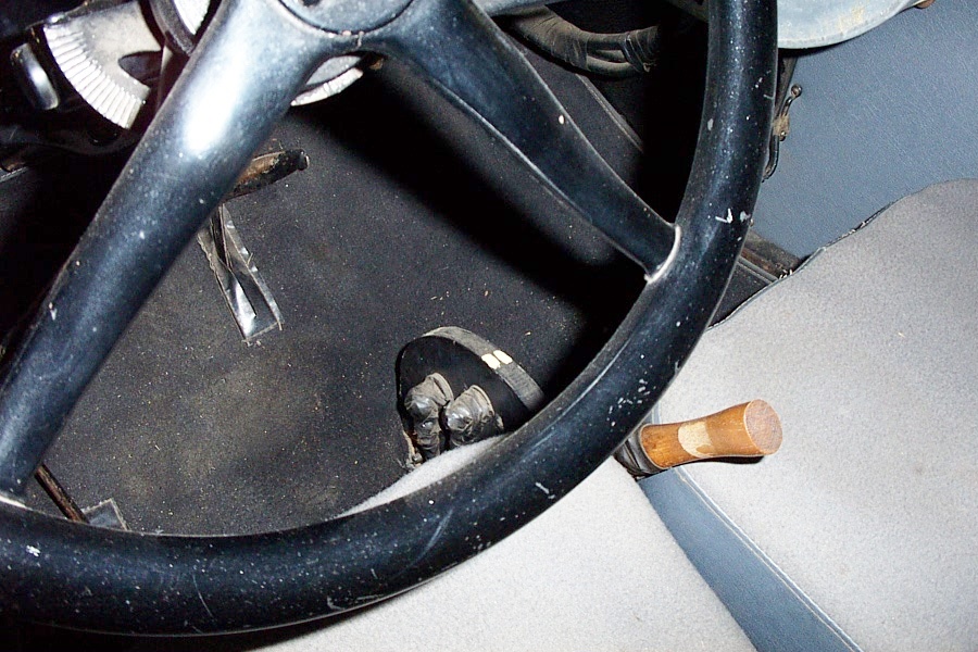

One of our Carbon Canyon Club members converted a mid 20's Runabout to full electric - was rather ingenious !

Does anyone have a link for the above picture? Or a link for more information on it? I am liking this a lot

Thank you John, for making my point. I would not want to create an electric hot rod, I would like to replace the Ford engine with an electric motor while retaining as much of the original Model T driving experience as possible, down to keeping the throttle lever on the steering column and most, if not all, of the pedals operational. If I wanted to build a hot rod, I would probably go with some more like putting a 327 into a 914, wait a minute, I already did that...
Since I’ve converted an number of cars (and my 30’ sailboat) to electric already, I understand tailoring the installation and electronics to protect the existing mechanical components. For me, that part is easy. But I was asking about the modifications needed to run the transmission without the original engine attached.
That said, a self-contained unit like the one with the blue motor and the internal brake posted earlier in this thread might be a suitable alternative, although I would probably work harder at getting any pedals positioned like the originals. That one appears to include a socket for the wishbone, which makes it more of a “bolt-in” replacement.

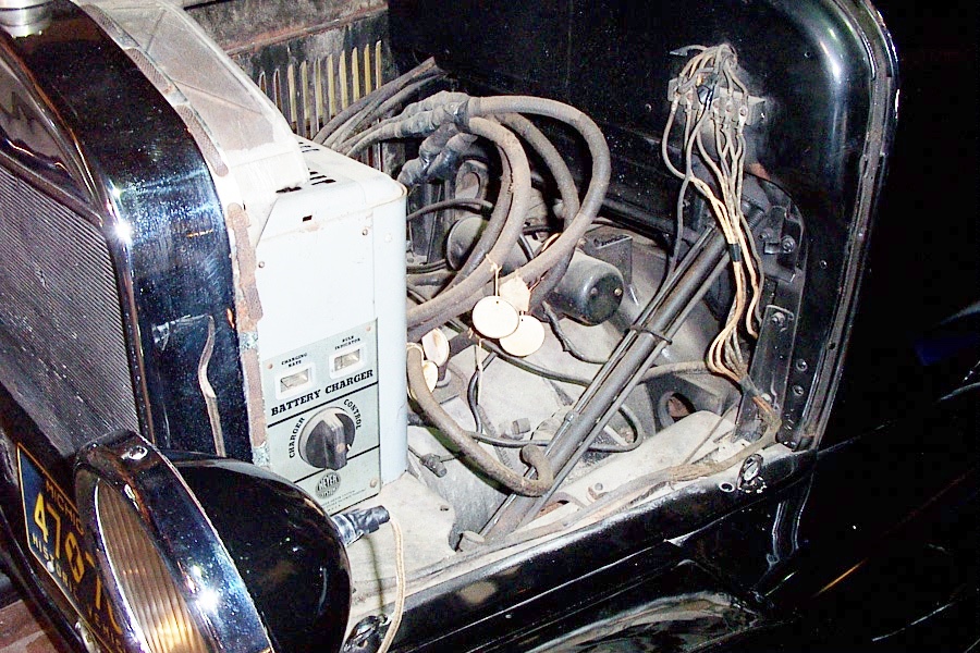

Ron Patterson
Re: Electric Model T Conversion
The man sitting in the electric Model T chassis with wire wheels in the third post from the top of this thread is Fred Allison.
He worked in the Ford Highland Park Plant Electrical Engineering Department and developed the Ford FA (Fred Allison) Starting and Lighting System introduced in the Model T in Late 1918.
Ron Patterson
