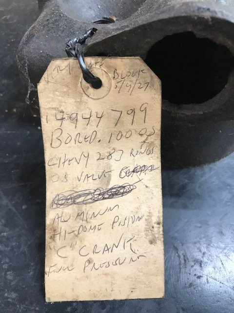

Re: Max a T engine can be bored? And other questions
Here's one at .100 over.
