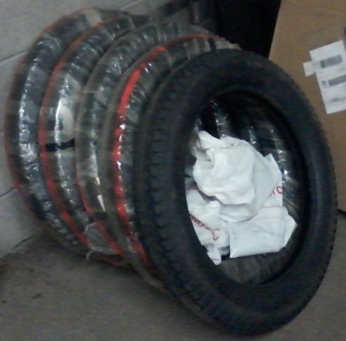

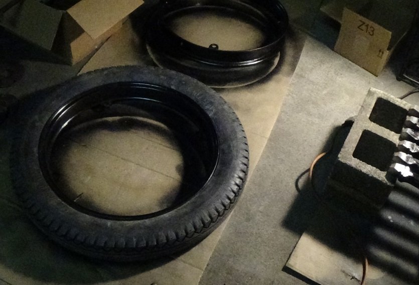

DickC,
About four years ago I purchased some "440/450-21 LUCAS Olympic Tread Blackwall" tires, including a spare. They came straight from Lucas Classic Tires, wrapped in plastic and labeled, "Made in Vietnam". None of they hold any air because that is the job of the inner tube :D . I also purchased five inner tubes from Lucas at the time. To the best of my recollection, they are rubber. Our T does not drive so I cannot speak to handling.
Lucas tires
Lucas tires
tire mounted
tire mounted
Sorry for the poor lighting from the garage.
Yes, and some tubes are better than others. I have found the Hartford tubes (China) quite satisfactory. I'm avoiding Custom Classic (India) because of the splitting problem. I think that's probably what caused my blowout a couple of years ago. I searched along both sides of the road and never did find that tire.
