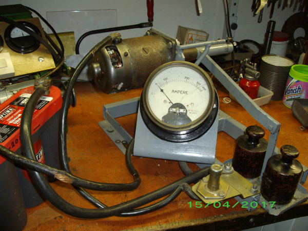

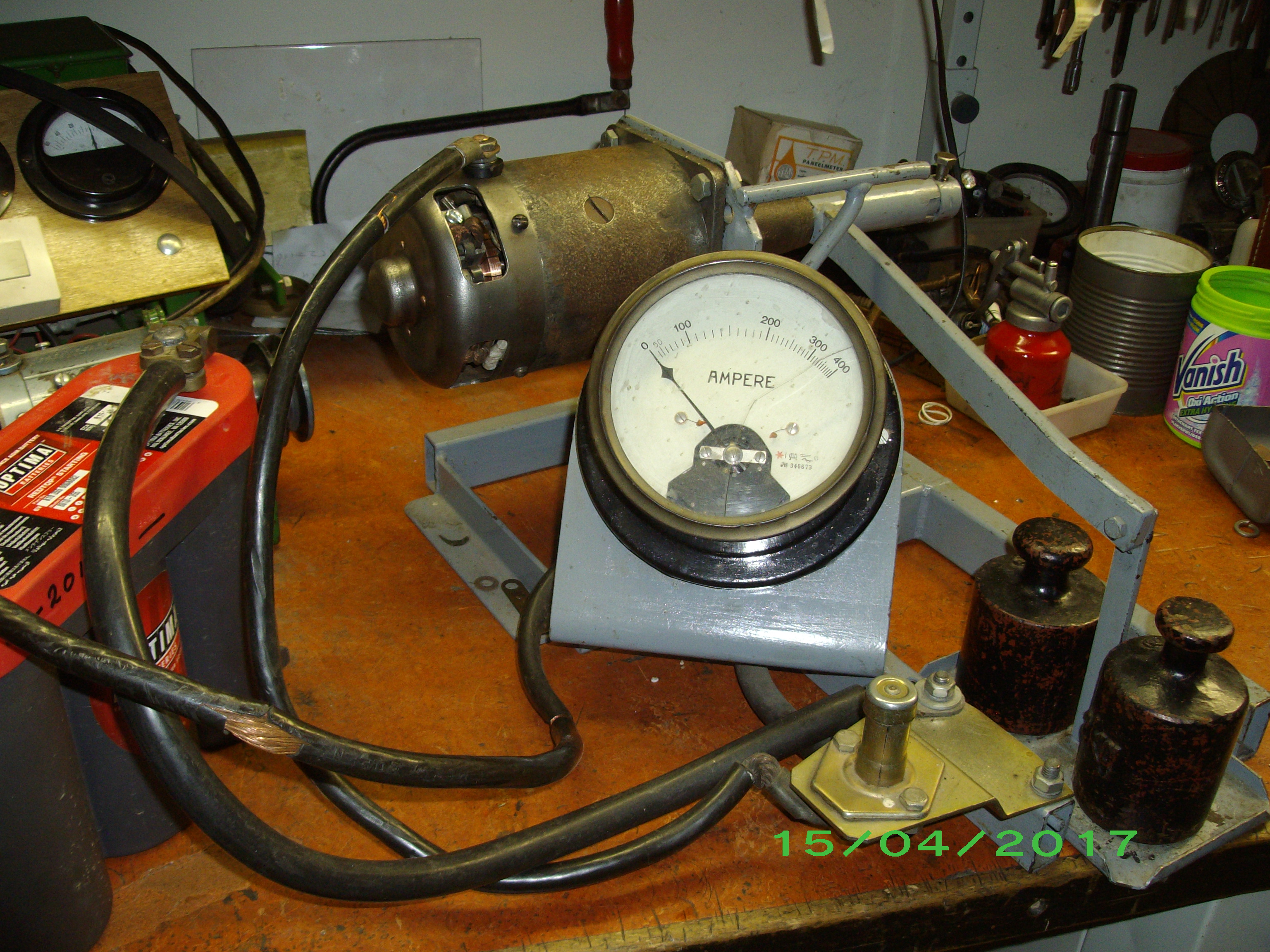

Ron covered this in 2012, see Scott's link for additional info,
"Assuming the starting motor is operating properly on 6 volts it should draw 70 amps free running, 150-160 Amps cranking engine and 450 Amps stalled pushing 12 pounds of torque.
Model T battery cables should be 1/0 with soldered (not crimped) wire terminals.
Ron the Coilman"
