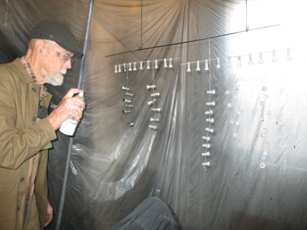

Certainly not the original technique, but I sometimes clearcoat nut & bolts to prevent corrosion. Really though, most of my T's automatically distribute a preservative layer of oil onto the entire chassis.

I don't know how they were done originally, but I'm not making hundreds of cars a day. I can take the time to paint them all chassis color before I use them. After derusting I prep with 50/50 phosphoric acid, wipe thoroughly dry, and paint. The acid etches the metal for paint adhesion and prevents rust from forming under the paint. If I have to use any modern fasteners I strip off the cad plating with muriatic acid because paint doesn't stick to it.
