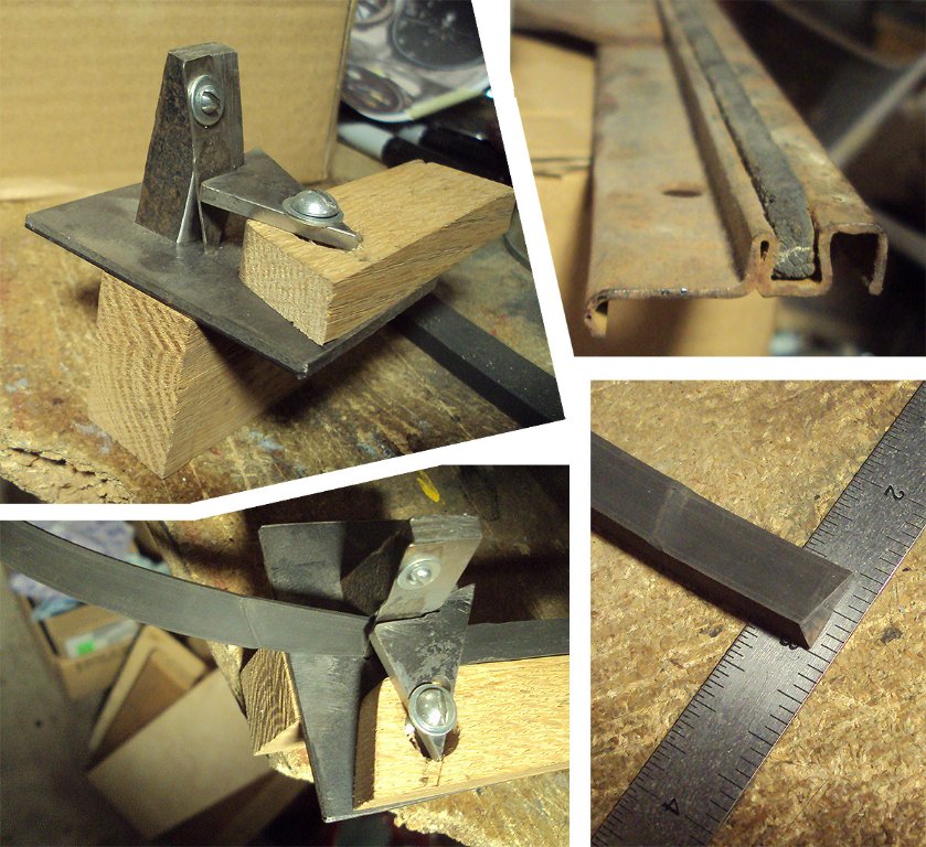

I wondered if the seal they make for the open car windshield post would work. At right here it looks like it might.
https://cdn.modeltford.com/i/c/2930731l.jpg
Not willing to take a chance I made my own from some rectangular rubber strip. I made a jig to cut the strip to a triangular shape by pulling it past an exacto blade screwed to a chunk of steel. I made the strips 3/16" x just less than 1/2" which was the thickness of the strip I was cutting it from. It is a little tough to get started. It has to be pulled through in one long consistent draw. Any hesitation or stopping with leave an irregular mark which can be seen as a flaw in the lower photos. while perhaps not what the original was it works well.
