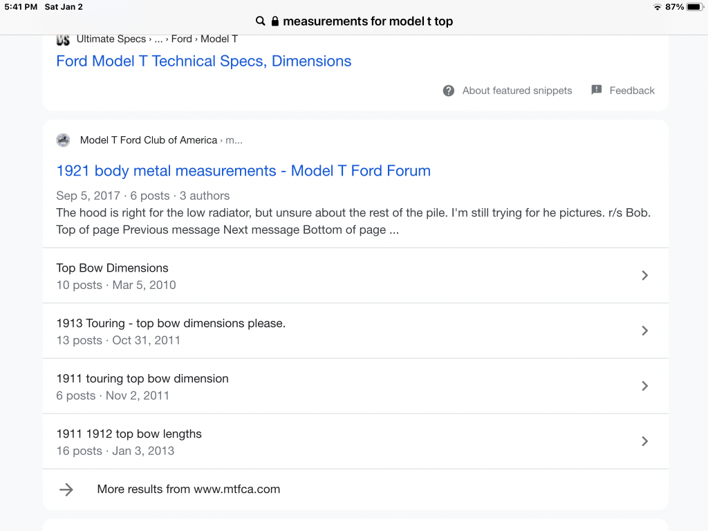

If he knows all that, he doesn’t need a pattern. There are key measurements on line.

Cmon, Jonah. I found them in 2 seconds and I’m a computer illiterate

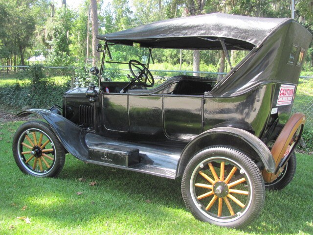

I looked in the MTFCA photo gallery and found two good pictures taken from the side: the ‘25 T roadster was posted by Dan Treace and the ‘26 T roadster was posted by George N Lake Ozark. Comparing the two pictures might give you a idea of the differences. If, when I post them on this thread, they are too small to see details, you can go directly to the gallery and click onto the pictures to zoom in and have a close up look. Jim Patrick
david_dewey
- Posts: 522
- First Name: David
- Last Name: Dewey
- Location: Oroville, CA
Re: Help!!! I can't find a top pattern!
Ah, but a roadster top and a touring top are very different in the "cuts" so try to look at tourings only!
