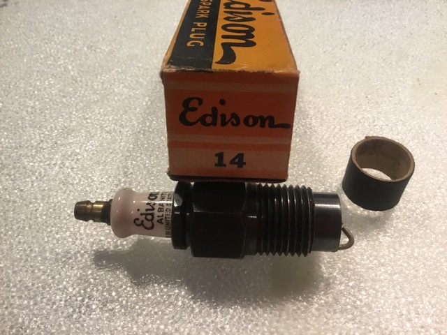

What Edison spark plug (number) works in a Model T? I have heard that number 14 is the correct number. Are there other numbers that work? Jim Patrick
- Posts: 7345
Re: Edison spark plugs
#13 (it has a double electrode) also fits a Model T. I saw one sell on eBay recently for over $40. As far as I know #13 and #14 are the only Edison plugs for Model T.

So, #13 and 14 are for use on a Model T. What is the advantage of the double electrode on the #13? The Edison #14 looks like the Champions I have. Which one of the Edison’s works the best? #13 or #14? Thank you. Jim Patrick
- Posts: 7345
I suppose the idea of the double electrode is more spark. I don't know if that's valid or not. I believe Mark Strange has been running Edisons. If he's tried both types maybe he can tell whether he's noticed any difference between them.

I use the #13 Edison plug just because it is large...1 1/8 inch wrench...Edison plugs in a Ford kind of goes together...Robert

I have a set of Edison 14s in my 1924 cut off touring, I like them. I installed them in 2013 and haven't touched them or looked at them since.
I have three Edison 13s, but I haven't run them yet, so I can't compare them to the 14s.. If I can find a fourth one I might try them in my 1912 Flanders 20 at some point. Right now the Flanders has Bethlehem "five point" plugs in it, pics are in my OT Flanders thread. The Flanders isn't running right now, so I can't comment on how they run except that the one I pulled out had good color on it.

Almost 10 years ago, George Mills and I installed a set of NOS Edison number 14 spark plugs in the 1922 touring car at the Glenmont estate of Edison's in West Orange New Jersey. Gap was checked at 0.025", and and runs great on battery and magneto. If there ever is another Saint Patrick's parade in West Orange we will be called to check everything over.

The multiple electrode thing is basically a bit of snake oil that has been around for a very long time. Many very early spark plugs (think before 1901) used a multiple point or ring type arrangement before experimenters went to the more common newer design. The ring or chamber style early plugs fouled badly, and were not reliable. The more open electrode designs worked better (stayed cleaner). However, within only a very few years, people began marketing multiple electrode designs. The theories sounded good. Two sparks had to be better and hotter than one, right? Reality however, doesn't work that way. MOST of the time, only one such electrode actually fires a spark. Once the voltage is ready, and the points fire, the voltage will fire the path of least resistance. One electrode or the other will foul a tiny amount, and the other one will fire alone for some time until circumstances change. Once in awhile, the path resistance will balance, and the two electrodes will alternate! I actually saw a high speed camera film of this many years ago in relation to electronic pathway studies. Fascinating to watch. The camera actually filmed the inside of a running engine cylinder, aimed at the spark plug electrodes.
True dual ignition can add somewhat to engine power. It works as long as the sparking points are separated, and the voltage sources are also separated. Timing between the two separate systems is critical. In the real world, single voltage source dual electrode plugs just doesn't add much. It MIGHT help a bit against fouling issues under SOME circumstances. And it could maybe help a bit if/when the electrode is badly burned or otherwise damaged. Otherwise, pointless.
In spite of that, they have been marketed over and over again for more than a hundred years now. I have a few Edison 13s (don't want to sell them), and have seen several others offered in the 1910s and 1920s. I have also seen ads for them from the '30s, and know the idea was quite popular during the 1950s. I have seen a few over the years since.
