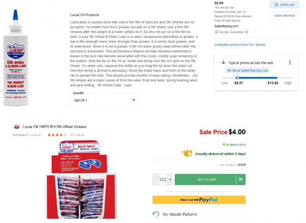

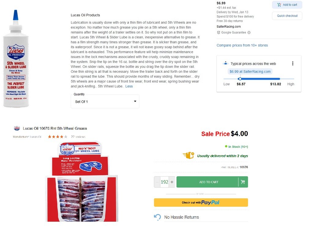

I was wondering if 5th wheel grease would be a better solution for the ball end. I would prefer a grease for the ball end to be "water proof" not just "water resistant"
Posts: 3743
Last Name: Wrenn
Re: Is there a way to keep the u-joint grease in?
Post by TWrenn » Sun Jan 03, 2021 3:55 pm
Frank, I've been using the "Red 'n Tacky" ever since starting with Ts in 2012. I think it works super good. Just my opinion.
Posts: 6262
Post by TRDxB2 » Sun Jan 03, 2021 6:03 pm
Thanks lots of brand's to choose from. Question : does it leak out much? Some owners have complained about the grease that they use (brand?) leaking and making a mess.

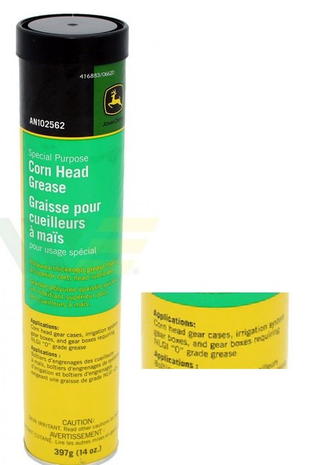

I use John Deere corn head grease.
Jim-B
Posts: 18
Joined: Sun Jan 06, 2019 2:39 pm
First Name: Jim
Last Name: Boyer
* REQUIRED* Type and Year of Model Ts owned: 1927 T truck. 1927 T roadster
Location: Declo. Idaho
Post by Jim-B » Mon Jan 04, 2021 11:29 am
I have noticed several posts using corn header grease for several different things, is there something special about corn header grease?
Thanks for your input. Jim
Posts: 6262
Post by TRDxB2 » Mon Jan 04, 2021 12:15 pm
Did some Internet searching...
"corn head grease is a poly urea based NLGI 0EP grease. commonly used in corn headers and similar boxes. It is a semi-pourable grease suitable for some gear boxes as it will slump to prevent cavitation voids like a #2 grease might cause. I would not recommend it as gun grease for grease fittings."
From https://www.cenex.com/~/media/cenex/fil ... h9-02.ashx
Multi-purpose Semi-Fluid Grease
General Description Corn Head Grease is a high quality multi-purpose, semi-fluid type grease available in an NLGI #0 grade. Although primarily applied in corn head lubrication, this product can be recommended for many applications in agriculture, automotive, construction and industrial environments.Corn Head Grease is a carefully formulated lithium 12-hydroxystearate grease with oxidation, rust and corrosion inhibitors, extreme pressure (EP) additives for anti-wear and heavy shock loading, and a special polymer to control oil separation during storage. The base oil used is a high viscosity index lubricant which provides excellent stability under various temperature conditions.Corn Head Grease has superior water tolerance and resists water washout, exhibits good high temperature capabilities and has outstanding mechanical stability by retaining its consistency in hard use.
