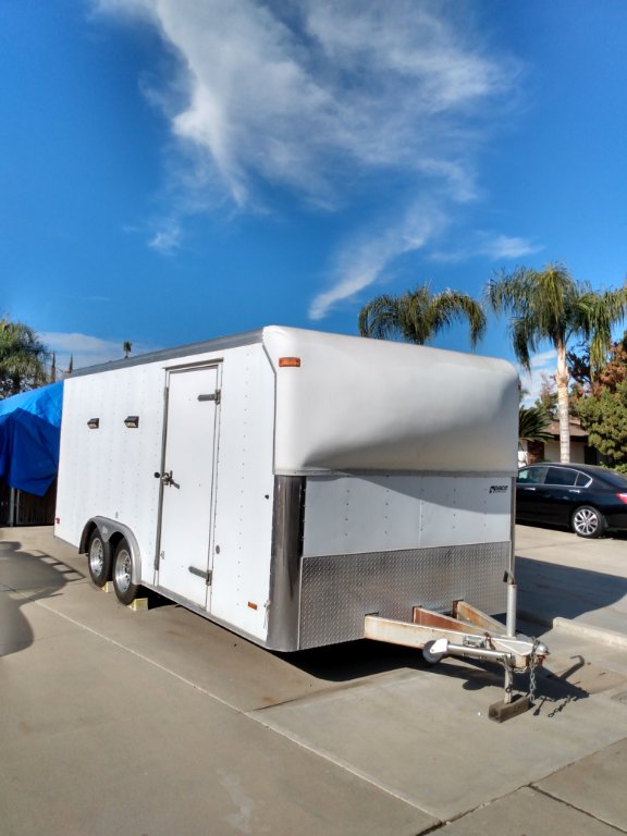

Hello fellow large trailer pullers,
Yesterday I purchased a 1999 8'x20' Pace aluminum enclosed auto-hauler. My 2019 Chevrolet tow vehicle has the factory tow package with "tow mode" and a 7 prong plug. The trailer's plug matches the Chevy's, and its running lights, break lights, turn signals, and flashers all activate as they should. This is easy to see.
However, I cannot know "for sure" if when I step on the brake that the trailer breaks are activating. Would any of you know a technique to test them?

One way to determine is IF your trailer has the breakaway switch...I can't tell in your picture if it has one..pull the pin on it, with
the trailer connected of course through the 7-way plug, and try to drive off with it. Trust me, IF it's working (the switch), you won't be able to budge. That in itself I would think would let you know your brakes are working. At least in emergency mode.
Otherwise, you could do like I did..jack up the trailer, with a helper, have him/her try to rotate a wheel off the ground while you
firmly push on the tow vehicle's brake pedal. That'll let ya know!!

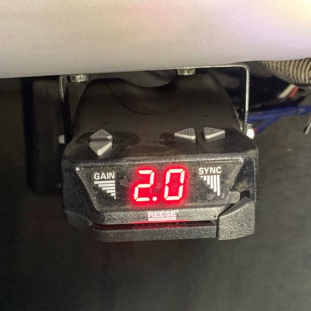

I have one of those lights under my dash. It tells me what setting I have on the trailer brakes and also whether they are connected. There is a switch If I am driving slowly, and I move that switch without my foot on the brake, I can feel the trailer pulling trying to stop. If you don't have one, follow FreighTer Jim's advice and have one installed.

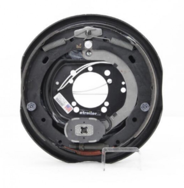

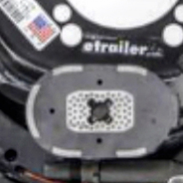

Electric trailer brake magnets fall out because
the design of all manufacturers relies on a cheap
clip in the center of the magnet to hold the magnet
in place - this cheap clip has a tendency
to become dislodged - this causes the magnet to
fall into the drum and get eaten up.
The passenger or curb side magnet clips tend to come
loose first because the curb side wheels
take more shock and road abuse.
If you jack up a trailer wheel & turn it - if there
is a distinct sound of something loose
inside the drum - chances are it is your magnet.
All brake backing plates have this clip.
It is a shitty design that has never been - and probably
never will be - improved upon - because then you
wouldn’t need to buy replacement backing plates
prematurely
Regarding electric brake controllers - all brands
work the same by applying electric current to
the magnets in coordination with the tow vehicle’s
braking system.
All work satisfactory if they are set up correctly
and adjusted per the owner instruction manual
for your particular tow vehicle - trailer - load.
I currently have a Reese brake controller
in my truck
FJ
braking system.
in my truck
FJ

Yes the design is crappy, NO every controller is NOT the same! There are big differences, that is why High End Trailer Manufacturers (Featherlite, ATC, etc) recommend Tekonsha. When you use junk equipment, you have many more problems with your trailer.
I urge people wanting to have as little problems on the road as possible to do their own independent research, go by the saying "you get what you pay for" & not listen to people who are constantly laying on the side of the road broke down!
It has probably been 10 years since the last time I had a bearing issue on either of my trailers (somewhere between 1.2 & 1.5 million miles) I can count on one hand how many blowouts I have had in the last 20 years & only ONCE in those 20 years did I have a brake magnet cause an issue that caused me to have to do a repair on the road. My maintenance schedule is all conducted inside my shop & I am very anal about it!
I liked the tip about the compass, but unfortunately requires two people. I also carry the Non-contact laser thermometer in the door pouches of each of my trucks & while I don't use them every time I get out, I do use it once or twice a day. The Harbor Freight ones are under $20.00 & are a good investment!
God Bless
Bill

If your Silverado does not have a switch on the dash like this you need to have an aftermarket brake controller installed, sounds like you do not. "Tow-Haul is a function of the Transmission & not Auxiliary Brakes on a trailer. https://images.carid.com/acdelco/items/84108377.jpg

I want to thank all of you for your useful comments above. You have got me thinking about far more than my original question. Because of this thread, the trailer and Chevy will be taken to a professional hitch shop and be thoroughly checked out.
Cheers,
