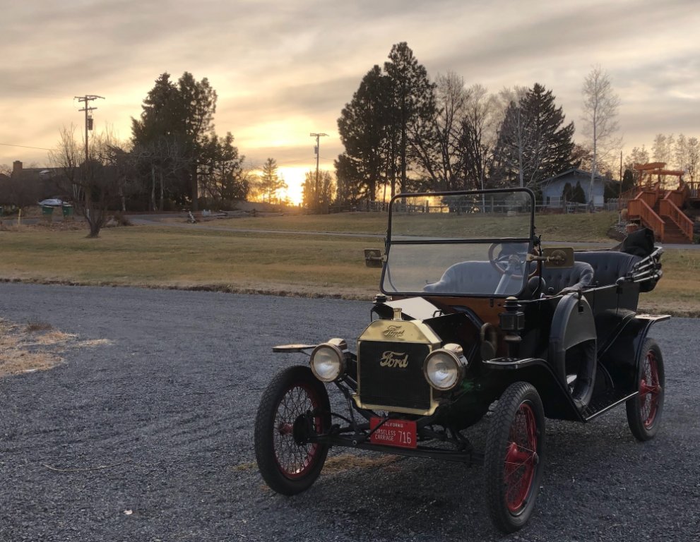

When the 1914 came to me, the headlights had been converted to electric bulbs. About 15 years ago I had de-converted a friend's car from bulbs back to gas and I wanted to do it now on this car.
After removal of the bulbs and wires and replacing it with burners and gas pipe and hose, it was pretty much just a matter or putting the calcium carbide in the generator and filling the water tank.
I couldn't remember how much carbide I put in the generator of the other car (I only lit those headlights 2 or 3 times), I put about 3/4 of a cup in the basket. I turned on the dripper and waited about a minute to try to light the headlights, but it took much longer than that. After several minutes, two little blue buds popped up with a match. After maybe five more minutes, the little buds grew together into the beginnings of some light. After a bit more, the headlights were doing their thing, they were at least as bright as the electric bulb conversion had been. The amount of carbide I put in fed the headlights for 2 hours and 4 minutes.

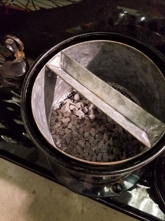

On that type of basket, I was told to put the carbide in the V shaped trough, not in the bottom of the basket. I guess it will work either way.

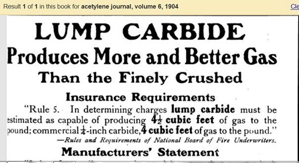

Carbide produces about 4 cubic feet of acetylene gas per pound.
If you are using 3/4 burners (standard for our T lamps) you should get about 2-1/2 hours out of a pound.
The clip below is out of the 1904 "Acetylene Journal". Carbide does go in the basket like you have it.

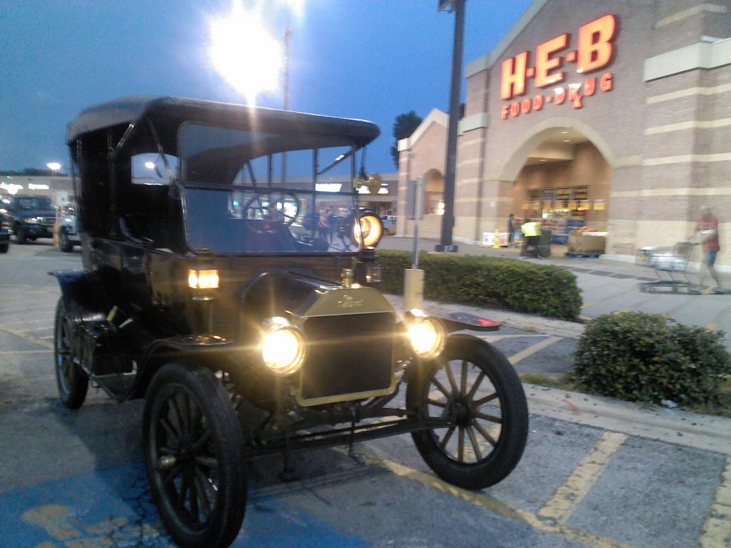

Drove my '14 Touring a couple of hours looking at Christmas lights week before last.
A lot of stop and go but my grown kids love it and we had great weather this year.
I can light the kerosene and acetylene lamps in about 4 minutes

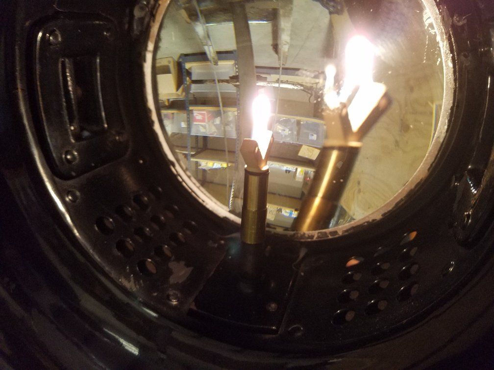

I've seen a couple of instruction sheets that say "Fill the basket with a good grade calcium carbide..." "Fill" it? Yikes - that basket holds a LOT; I could easily pour a whole one-pound can in the basket. Filling it really seems like overkill to me, I don't need lights for all night and into the next day. I used about 1/3 of one can and got two hours and that was a good test. I have only seen one person who puts his carbide in the water spreader trough instead of putting in in the basket. Maybe if a person wants lights for only a half hour or so?

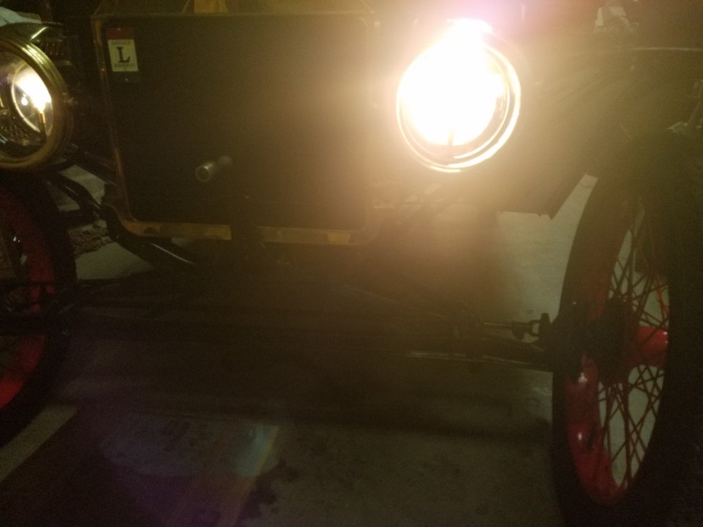

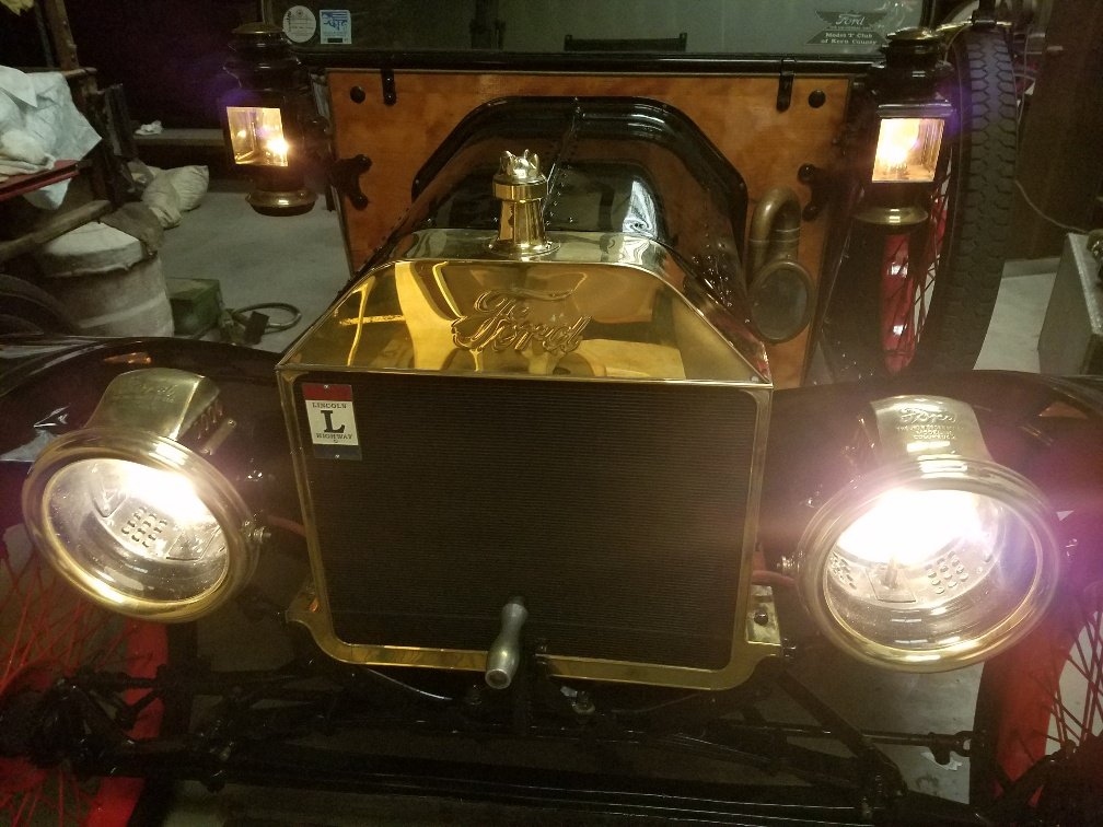

For my test, I set the pointer on the top tank to about 15 drops of water per minute, but I don't know how many drops it made in reality. At first I did try dialing the pointer open wide to speed things up, and in a few seconds I could hear the generator start making a boiling noises. It wasn't really boiling, but the gas pressure was blowing back through the drip hole and bubbling up through the water reservoir and escaping through the vent hole in the water cap. Normally the weight of the water in the tank is the pressure regulator; after it drips on the carbide and gas is made the pressure builds, making the water stop dripping for a bit. As the pressure drops the water drip resumes.
I was pleasantly reassured that the light the gas provides is ample and it really is as good as the bulbs were. The lamps don't flicker or hiss. The flames do vary in size a little bit, though; sometimes the flames are the size of a dime and other times they are the size of a quarter. The car was in the shop while I conducted this experiment and the chimneys smelled like hot stuff. Scorching polish residue? Fingerprints burning off? Hot brass? I dunno, they just smelled hot. They took on a very faint rainbow effect, too, but the rainbow colors polished off the chimneys with no effort at all.

Good job, Dan!
Nothing increases the cool factor of a Model T more than operating acetylene headlamps!
Keith

Unlike the square kerosene lamps, the gas lamps are really meant to be air cooled by the car moving.
It doesn't take much movement to cool the bonnets but I don't leave the acetylenes burning while I am not driving.
The other night, there was a crowd looking at lights so I had one place I went twenty minutes or so stop and go low pedal.
That is pretty much pushing it for me on the bonnets. In just general night driving, my bonnets don't get near as hot as the radiator.
FWIW I have lined the inside top of my gas lamp bonnets with manifold wrap and I notice no effect on the brass/polish.
Flame size may be a little difficult to maintain with a generator. Let us hear how you make out with it.

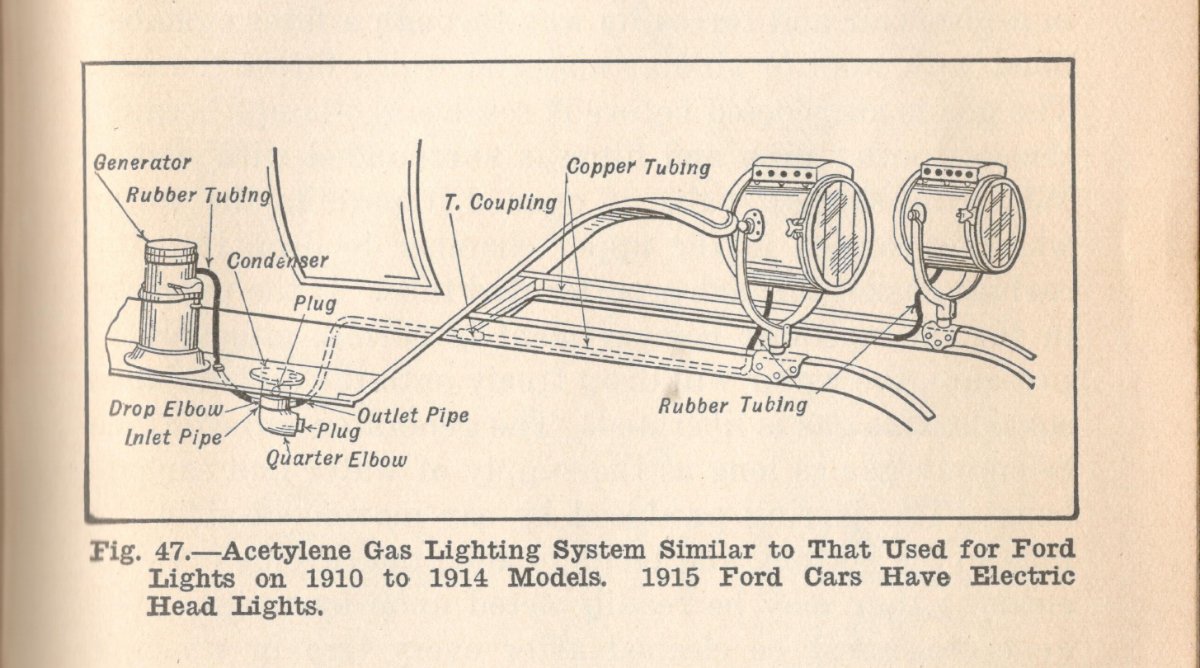

Any chance of you showing off your routing of the metal lines from the generator to the radiator?

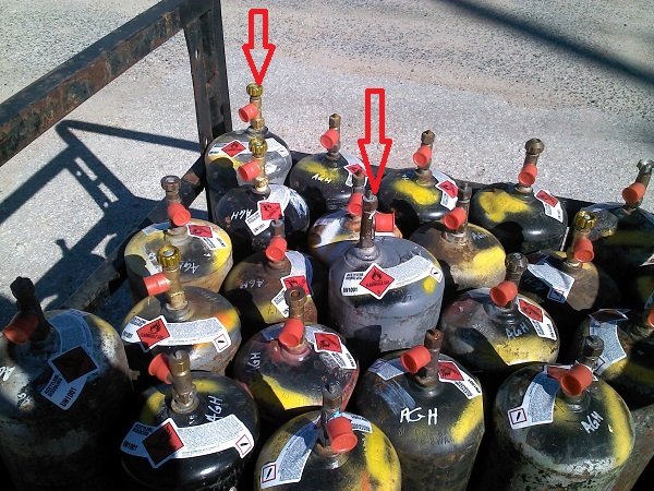

Yes, Hudson, any welding supply will have them. They are the same size as they always were and some of them still have the Prest-O-Light script pressed in the wall of the tank. Maybe I'm extra lucky, but the guy at the local supply shop lets me take my pick from his inventory.

Hudson,
The local welding supply houses have them, Praxair & Airgas. I find
the Prest-O-Lite tanks with the off-center valve are mixed in with
the other "B" tanks. You have to look carefully to spot them. This rack
had two and I took the one in the back corner.
The POL center right has the fine valve and works best if you "crack" the
valve for gas. I use a small regulator so I like the POL in the back
with the knurled knob which indicates a coarse valve.

- TWO PREST-O-LITE TANKS IN THE "B" TANKS
- B TANK PILE.jpg (100.14 KiB) Viewed 3462 times
