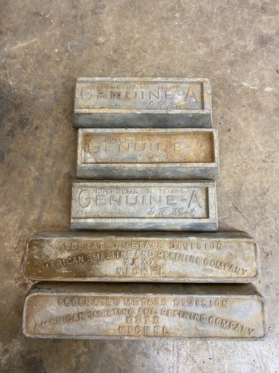

I have access to a bunch of these bars of Babbitt, wondering if it is any good. Opinions?

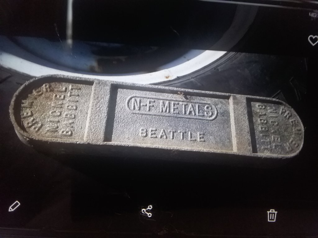

I knew the manager at Non-Ferrous Metals in Seattle - I did a considerable amount of work on his father's Runabout.

Hopefully a couple of our "Babbitt pourers" will chime in but I believe Premium Nickel was acceptable for our engines.

Just because an old ingot says anything on it does not mean that is what the ingot is...
Here you have some ingots that were used as ballast in a sailboat. It is quite possible that someone decades ago found an old mould that was the right size for what they wanted to do and then cast a bunch of ingots of whatever they could melt to use for ballast weight in a sailboat. Maybe not in just that one boat, but maybe in dozens or even hundreds of boats. Or, It could be bearing metal that could make satisfactory bearings. I wouldn’t ever take the chance of using any bearing metal I wasn’t 100% sure of.
Some bearing metal suppliers can assay a sample for you and tell you exactly what it is. That was a $100 service when I inquired with my supplier several years ago.
The scrapyard that takes all my unusable T stuff would pay $3/pound for babbitt a couple years ago. If you go to a major scrap buyer, they have a device that will tell them enough about those ingots that they can make an offer on them.

George- if there is any concern regarding the authenticity of your bars, take one to a scrap metal dealer and ask them to shoot it with their XRF gun.
Most scrap yards have them and should be willing to check a bar as a favor or for a small gratuity. I would imagine that most metal suppliers guard their ingot molds pretty well but. . . . . Any way nice find. Dan

Are these useable for engine Babbitt ?

The two bottom ones- the XXXX Nickel ones are for sure- purchased my babbitt from them for years before they closed their plant in San Francisco.
