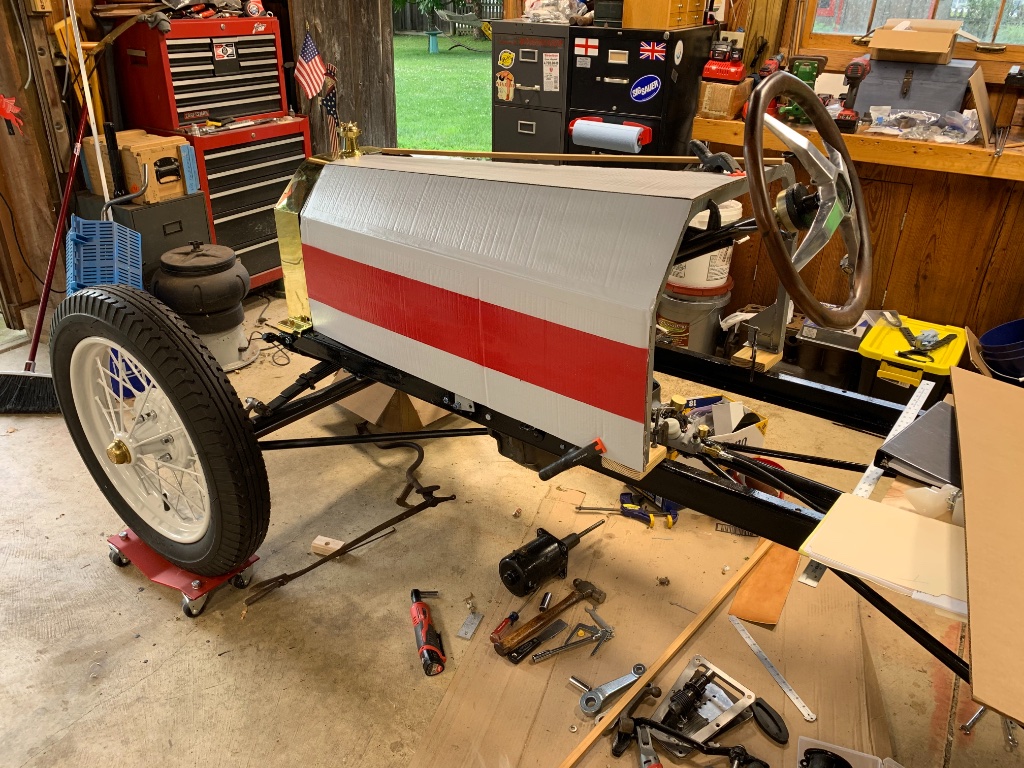

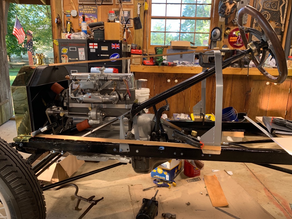

Since the Speedster project is now running, Its time to think about driving it.
I have been oiling the push rod guides and the valve stems with my little pump oiler. But it is a real mess each time. I know that this thing is going to be an "oily beast" but I hope to keep it to a minimum. The Rajo 4 valve has a valve cover but it is almost useless. There is no back to the cover and no good way to seal it at the bottom.
A friend suggested "spray grease" for the guides and rockers. I had thought about chain saw bar oil. One other concern I have is where the rocker arms meet the valve stems and push rod tops. There are no "cups" that the push rods fit into. Just a flat smooth surface that "rubs" the push rod top as the rocker works.
My squirt can works OK but I'm just looking for suggestions from more experienced overhead owners

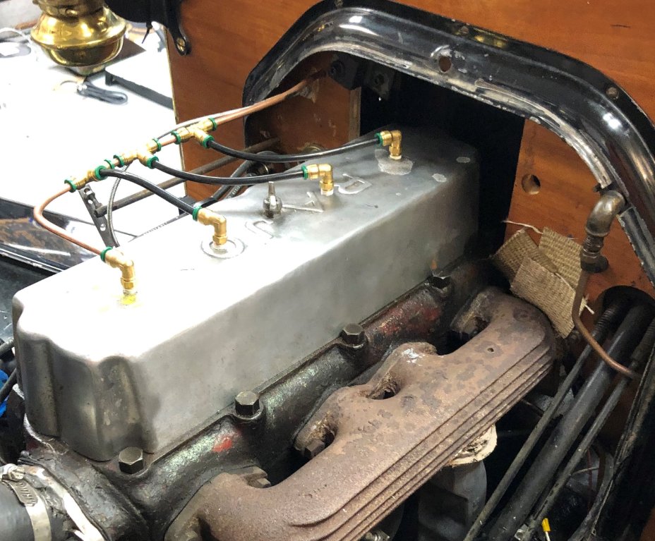

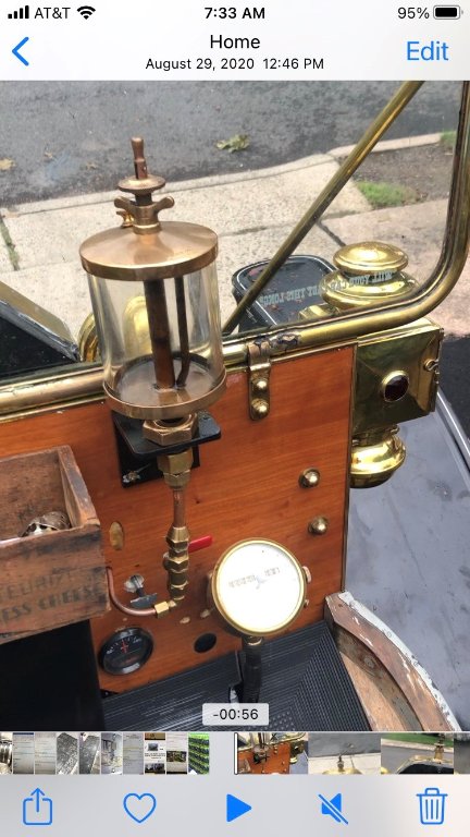

I run a Rajo BB on my 1912 touring car and have had good luck with this system. typically in the morning when touring, I back out of the trailer and do normal maintenance. included in that is to take the valve cover off, and put about 1/2 quart of oil on the felt under the valve cover. after lunch I put about about 1/2 the sight glass worth of oil through the system. It seems to work good. I don't burn my hands after lunch on the hot valve cover and it is a much cleaner process.

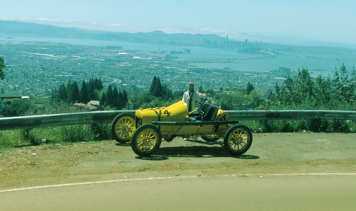

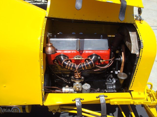

My B Rajo has been performing double duty for me for 53 years. during that time I've had very few problems. I'll attach a picture of it after a days run, no messy oil problem. With a yellow chassis I don't need oil from the cylinder head to add to my cleaning duties. Daily routine while on the road; With a Ford script oil can lift the felt pad and oil both sides of the rockers, then the shaft. Then lay the pad back down and the same locations on the felt pad, just a stream across each rocker and a stream front to back on the shaft. That's it. Regular engine oil (I'm still using non detergent 30 wt.) Probably use 1/3 to 1/2 of the oil can, never really kept track of how much. If I wasn't so lazy I'd go down and shoot a picture of it right now as I haven't touched it since our last outing of about 80 miles, but I found in my file one that was shot after about 40 miles on the race track at Laguna Seca in Monterey. Some times I have to wipe a little black residue at the base of the cover and top part of the head just below the cover

I don't see radiator support rods in the 2 pics. Yellowracer, hard to tell from your pic. Have you modified your rods for clearance to remove the valve cover? Or remove the rod to pull the cover? I am setting the hood on my racer/speedster and running a chevy head. Mine seems to fall within an inch or so over the valve cover top side.

Suggestion re the hood rod; Install studs at firewall and radiator. Then weld on open ended slotted brackets at each end of the rod. Then all you would need to do is loosen 2 nuts and remove the rod. The rod being a little shorter then needed and one stud a little longer so length could be adjusted.

The 4 valve rocker arm cover is unique that there is no back to it. It does help some as to the "spray" of oil from the rockers. I was also concerned about the thicker oil not going where it was needed, so I guess Ill stay with my 30 weight oil Im using... Its not un-managable, and I guess that is part of the story of the speedster/overhead part of the T history.
Terry, I still have the 2 single heavy rocker covers. They would be easy to seal off to the head. But I have installed a single rocker shaft instead of the two single rocker shafts that came with the head. The two single shafts are a weak system and can allow the rocker towers to flex front to rear . The single shaft solves the problem. The only way I could use the two single covers is to cut a 5/8 notch in the two covers to slide down over the rocker shaft. I may end up and do that and then make some form of a door or seal to cover the notch when in use. I could use them when on longer drives, and the original cover at shows or around the house. Since the two single covers are a "fantasy" item made during the 80s 90s era I do not mind modifying them .. And they are really cool looking .....
dmdeaton. I can see the hood rod in the yellow racer photo. If you zoom in on the photo it is there. I have a "mile" of room for installing my valve cover ...

On a low radiator car, with the Chevrolet conversion, there is a mile of room. He must be running a much lower type radiator if there is not a lot or room.

[image][image][image][/image][/image][/image]The rod you're seeing is the control rod for the adjustable upper hood vents. There is no radiator to firewall rod. The only upper support that my radiator has comes from the shell. The center panel of the hood is attached to the firewall/hood former by 2 screws and nuts at the rear and to the radiator shell by 2 screws at the front. Unfortunately that's all the radiator get for upper support. I'll attach a picture showing the hood vents. I'll have to take some closer up pictures of the hood vents because this is the best one I've got. Zoom in. (the background is Oakland and San Francisco.)

Hey Ed,
was that pic taken up on Skyline road?
Tim
Tim
Dan McEachern
- Posts: 1510
- First Name: DAN
- Last Name: MCEACHERN
- Location: ALAMEDA,CA,USA
Re: What lube do you use on your Rajo or other overhead
Tim- my guess is its up on Grizzley Peak.
YellowTRacer
- Posts: 606
- Joined: Tue Jan 08, 2019 6:55 pm
- First Name: Ed
- Last Name: Archer
- * REQUIRED* Type and Year of Model Ts owned: 1909 replica Transcontinental race car, 1915 2 man race car, 1918 American bodied speedster
- Location: 1807 East Ave. Hayward, CA 94541
- Board Member Since: 2009
Hi Tim you're close, up on Grizzly Peak Rd. Off of Skyline. A Tour that I planned a couple months ago for the Bay Area Horseless Carriage Club.
