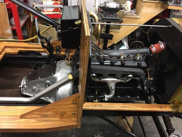

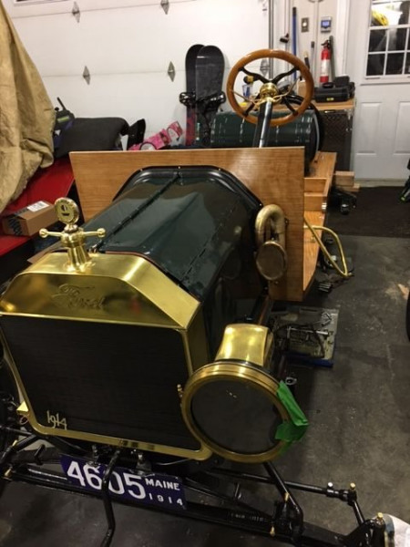

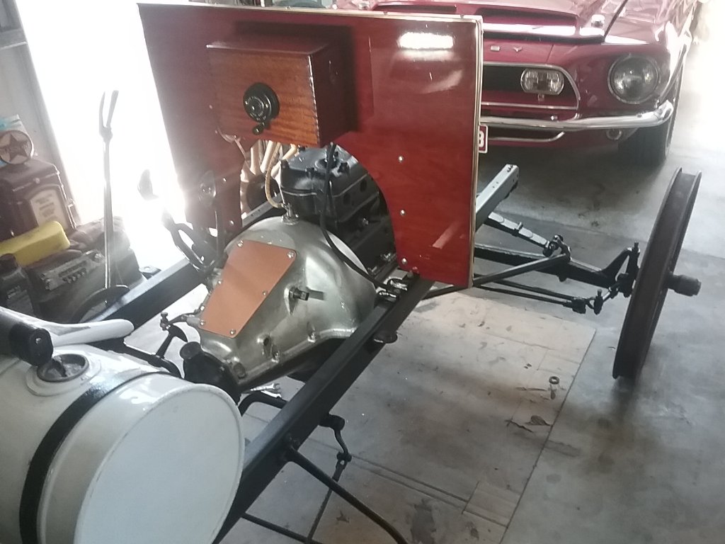

Hi Don, here bellow my original stock 1914 speedster project as well. It may inspire you.

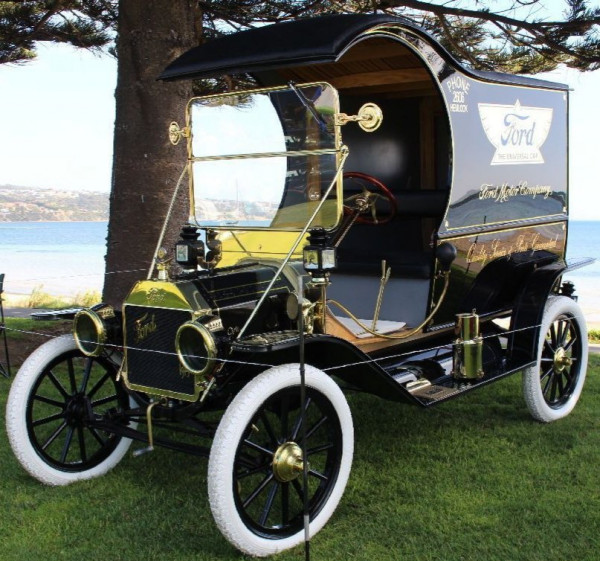

Nice work. Does anyone have plans for a 1916 style that will have a brass square windshield?

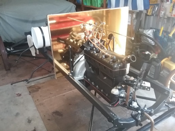

I just stained my firewall few days ago in cedar on 1 side and on the otherside i went... gold baby !! Trust me the end result gets people crowding at the car shows , like bower birds they like shiney things ! Just Look at my last classy project

Johnny you did a fantastic job ! Congrats. How did you make the brass modling corner? I'm asking because I'm ready to install mine...

The brass framing around the firewall comes in lengths with pre drilled holes from most vendors .
With the thinner wrap material you can tuck it around the edges of firewall & the brass frame fits , hides & holds it in place ..
With thicker wrap it wont fold over the edges & can bubble up & lift around edges there ..but you can cut your wrap material to the firewall edges with a ultra sharp new box cutter knife .
Just be sure your surface is smooth as !! ..with no pimples etc before you wrap..
I stained & laquered to perfection both sides of the firewall so if any deterioration was to occur i can simply remove the wrap.
You can actually buy wrap in all colors of chrome these days & or other many textures ...also wrap that has different woodgrain textures too so you wont have to stain or laquer your firewalls... just wrap your firewall in your favourite wood grain texture..
its cheaper and more effective & with minimal labour too...
