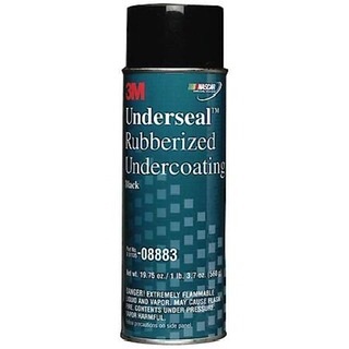

I have used “3M rubberized undercoating” which is black and, not only seals the underside from rust causing elements, but soundproofs from road noise, while also preventing damage to the underside of the vehicle by pebbles and rocks which just bounce off. Jim Patrick
