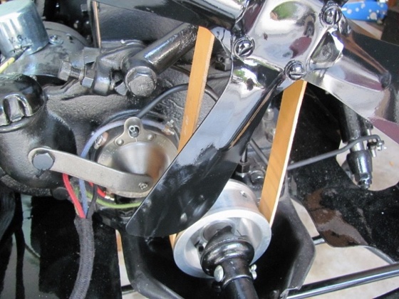

Hi I am brand new to Model Ts (although Ive owned this one for 10 years I just started work on it with my son) When i got it it had a rebuilt motor, so we took the body off and started putting it together. We have it so it runs but the timer lever and rod interfere with the belt when we advance the timing more than 1/2 way. Has a new day timer and 4 blade fan. Any help on this would be greatly appreciated. download/file.php?mode=view&id=78407

Not sure if this is your problem, you may want to try a shorter fan belt. This will move the belt away from the timer.

Like Jim says it’s either using a longer than needed belt, the timer rod needing rebending to clear the belt but from the looks of it without more views a shorter belt may do it.
This sometimes happens when putting an engine together so your not the first.

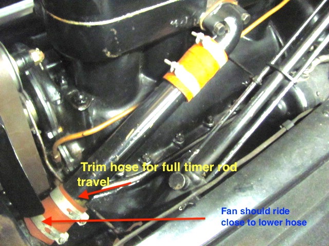

As noted by others, be sure the fan and belt length selected places the fan arm to the lowest position. The fan blade should be very close , about 1” or so to the lower hose.
Also be sure the lower hose is trimmed in length to prevent impingement of the timer rod's full travel.
Once that is checked , if the belt still rides on the timer case, re-check the timing, as the timer rod may be mal-adjusted. Re-time instructions can be found on search of forum posts.

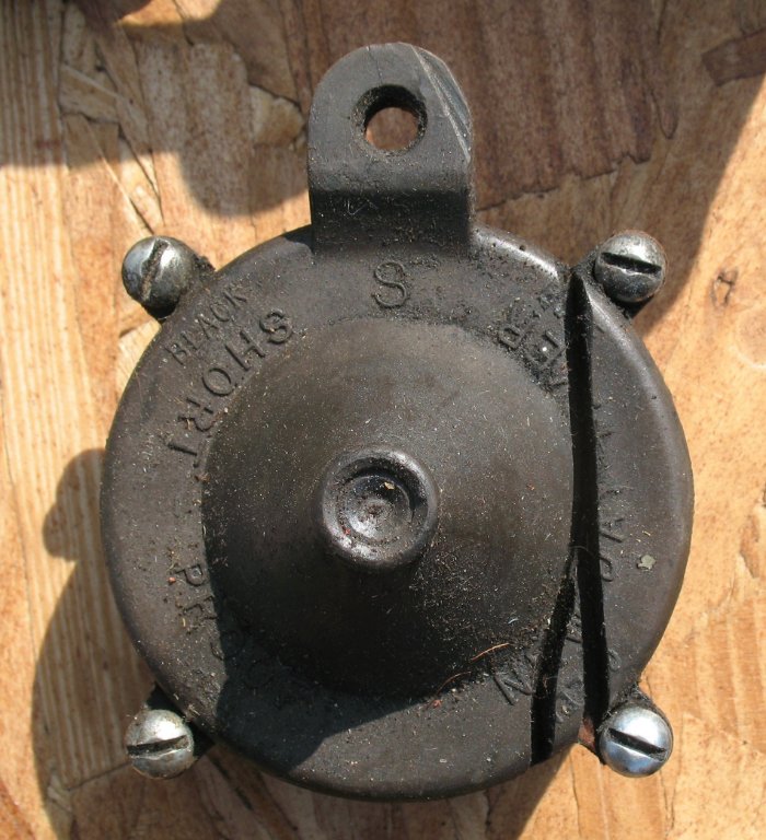

I weld and recut the notch on the timer brush to allow the timer to rotate further counter clockwise. You then have plenty of travel before reaching the belt. I find this problem more common on the Anderson timers.

For that reason I don't like Anderson timer. I used new day timer as well

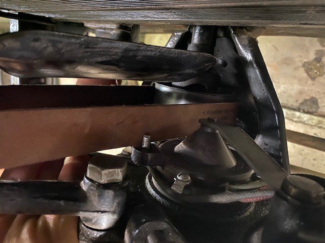

As John says, you're not the first. :D

This is a good topic and Dan your pictures and comments are very helpful. I noticed some loss of my timer lever travel this fall and my lower hose had move up a tick and caused that same problem.
A replacement radiator for this spring and will trim down and check that lower rad hose again. The forums are priceless.
