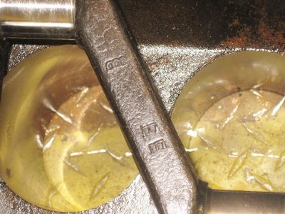

It has the letters EE forged into the flat surface of the crank.

Pre 1926 crankshafts have a "diamond" shaped throw between journals - '26 - '27 AA & EE cranks have parallel shaped throw. I have both EE cranks that have forged EE in the throw & EE stamped into the front where the fan drive pulley mounts.

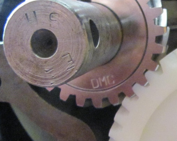

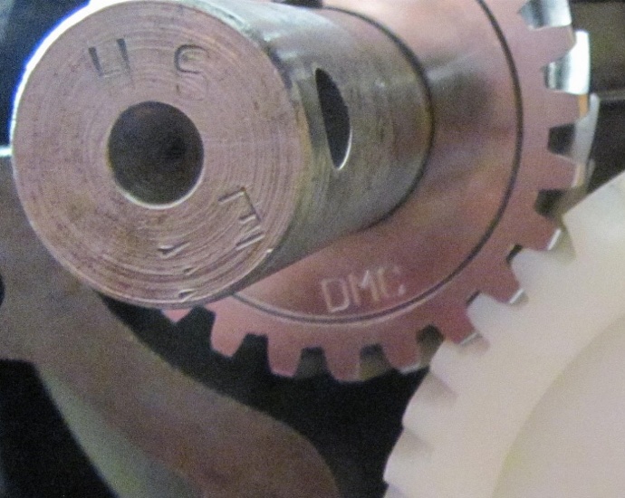

Here are some images

Thank you all for responding and the info, just to make sure I have it. The early cranks have the diamond shaped throws and they were used up to 1925. The later cranks have parallel sided throws and the EE cranks are the later cranks and have the EE forged into the side of one of the throws and on the front end of the crank. Thanks again , Dennis
