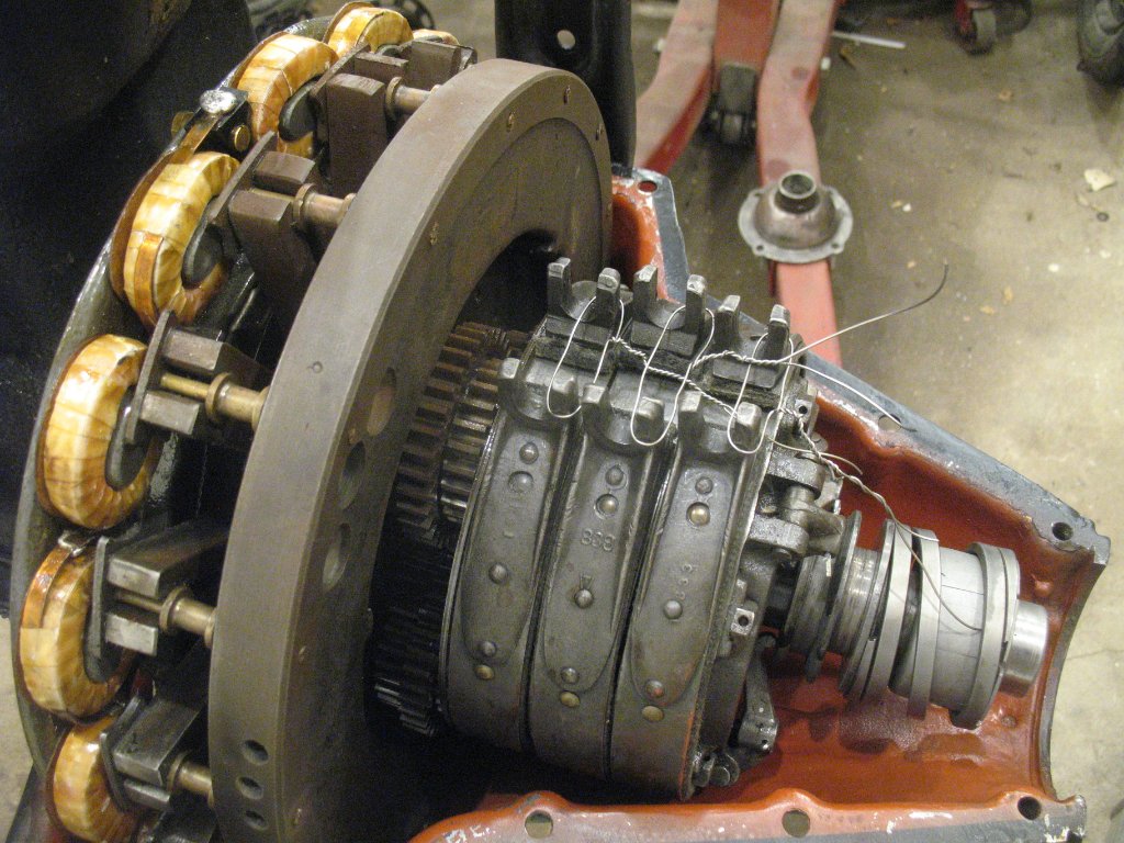

This is how I set up the bands. Is there a better (easier) way? Is the band clamp enough better to be worth the $13.50 + shipping?

I have always used cotton string. Less concern about loosing bits!!

You are asking for trouble with the wire. Use plastic zip ties. If a little plastic falls into the transmission it will not cause trouble

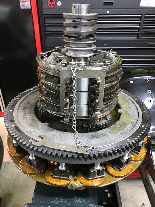

Steve, I use the band clamp sold by Langs and it works fine. After lots of use it began to spring out a little and I just bent it back it. I would recommend getting one.

Steve, I use copper wire. It's non magnetic, should a bit come loose, and it is softer to to bend around when withdrawing it . On our RHD set-up we have two springs to contend with, reverse and brake. I do not like the new springs available because they seem to be longer than necessary and too strong. Unless there is damage to the springs, I leave them well alone. I do measure the gap and wire the band ears together to match the gap. This leaves the maximum clearance to get the cover over the springs. Obviously, others do it differently.

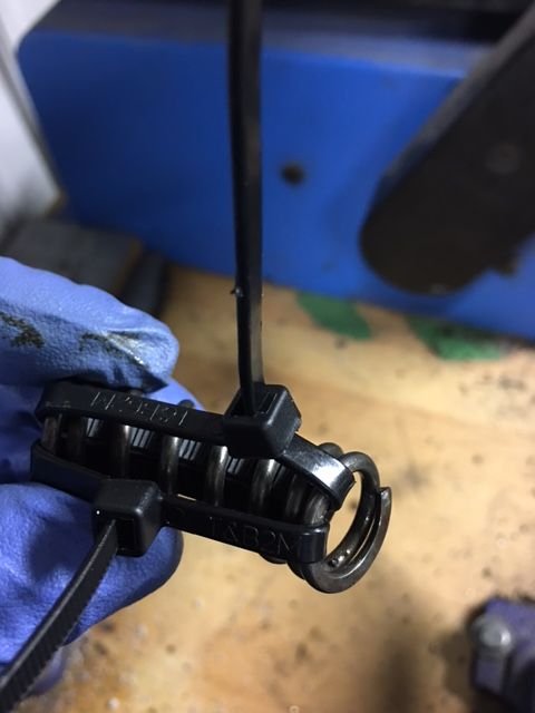

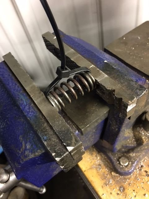

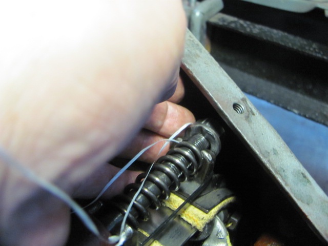

I’ve used heavy zip ties, work fine. Once had to find a busted wire end.
But you can use that excess wire for the bolt heads on your driving plate before fitting your alum. hogshead
Note the black zip tie, use two and lace together and grab all three band ears. Use dental floss on the washer/nut assembly, loop tied.
Turn the nuts a few threads, then remove the zip tie by snipper, the band ears will catch on the hogshead bosses.
Do that prior to setting and bolting the hogshead all the way down.
Zip ties will sneak out under the band lugs, that big fat tool won't! Tried that, been there

I like the zip tie method. No wire bits to fall in.

I have had good luck using three separate pieces of wire. One on each band. As I lower the hogshead at an angle with the rear lower than the front onto the drums I cut each piece of wire one at a time as each shaft engages the band ears.
This period tool works amazingly well to compress the band springs. Although it won’t work on ‘26-‘27 hogsheads. One of my better Hershey finds!

Hi, I wasn't successful using the clamp. I used black zip tie and steel wires but just be careful...I used a lot towel surrounding the band in the goal to avoid any steel wires fall down in the transmission. Also bellow couple pictures for the springs tips. Hope that help.

I have exactly the same tool that Ed shows. I will never install a hogshead without it! Once you have the band ears tied together with the plastic ties and the springs compressed with the tool, the hogshead just drops right into place. Easy peasy.

The Ford script u-shaped band tool works better than the modern copy that Lang's sells.
It has slightly different dimensions.

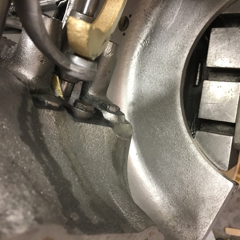

heres a silly question. why isnt the low pedal shaft cut per service bullitin? this t is using demountable bands, but low cant be replaced without pulling the hogshead. i do realize with kevlar you wont need to change the bands for the life of the transmission. then why waste a demountable band? nondemountable bands are a throwaway, like a buck a piece @ swap meets. i generally keep a few n/d bands around for kevlar or wood band installations, where removing the hogshead is necessary. just wondering.
- Posts: 1187
- First Name: Joe
- Last Name: Bell
- Location: Tiffin Ohio
Re: Installing the hogshead: Is there a better way?
I have often thought of cutting the low speed shaft shorter, I do on the cast iron ones but the Aluminum covers I think that gives the shaft more support for wear? Am I just thinking to much?
- Posts: 1584
- First Name: Adam
- Last Name: Doleshal
- Location: Wisconsin
Joe, I do believe there is a potential support issue on the aluminum hogsheads and I don’t cut the low shaft on them either. Also, many of the demountable bands will have interference issues inside the aluminum hogshead on the left side and you are generally better off using non-demountable bands because they have a lower profile. This is also a factor on about 50% of the iron hogsheads that were not originally manufactured for quick-change bands. It almost seems like the placement of the mould cores for the inside of the hogshead was real hit-or-miss. The towers on the inside for the low and reverse shafts can be anything from well centered, to paper thin on one side. I built by own fixtures and tooling and have rebuilt more than a few hogsheads.
The major “catch” with modifying an earlier hogshead for later bands as is in the Ford Service Manual is that they were using cotton bands that were much more forgiving and quickly wore away in cases of interference. The majority of us use Kevlar bands and a small spot of interference is likely to result in a cracked drum.

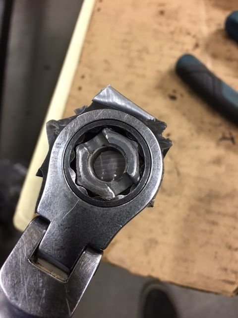

Steve, where is the lock wire in your driven plate bolts?
When I install a hogshead I use the clamp sold by the vendors. When I sit the hogshead in place, I start all the bolts and nuts to make sure the gaskets are in the proper position and every thing lines up. The bolt are just barely long enough to get started towards the engine. Before tightening everything down, I install the pedals, band springs, washers and nuts. Next I pull out the clamp and gradually draw the hogshead down until it's seated and snug up the bolts. The clamp cannot be removed if you tighten the hogshead down on it.
Stephen
Stephen

Rusty Ford is right about the copy of the band tool not fitting well. I have one of those and wound up not using it. I can’t understand why the repo tool can’t be made to the same dimensions as the original.
