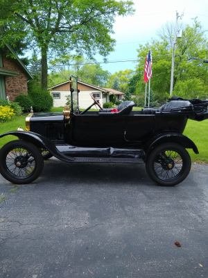

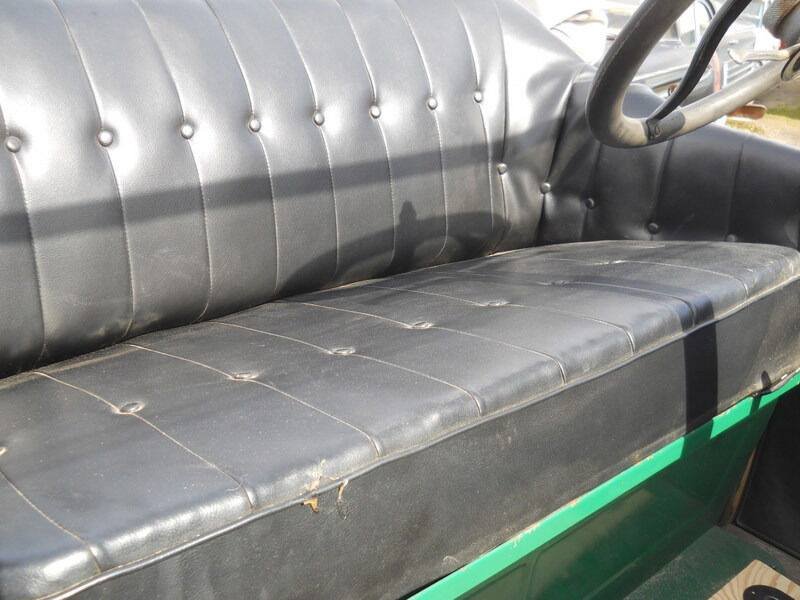

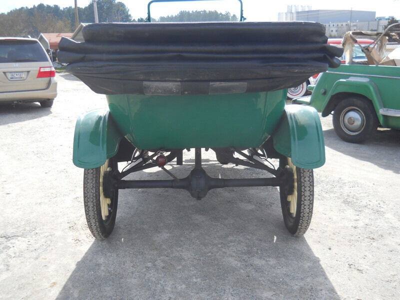

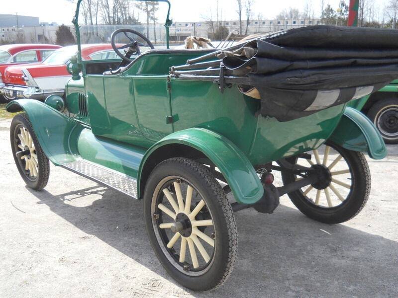

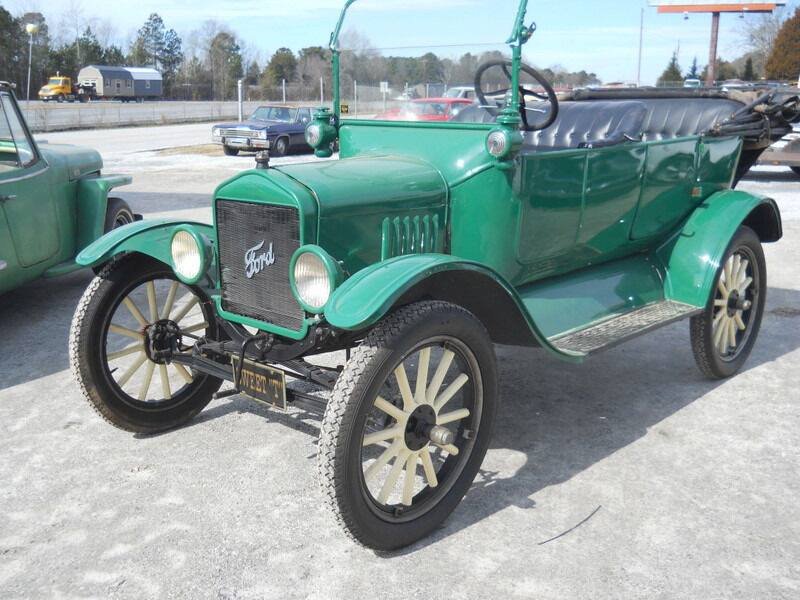

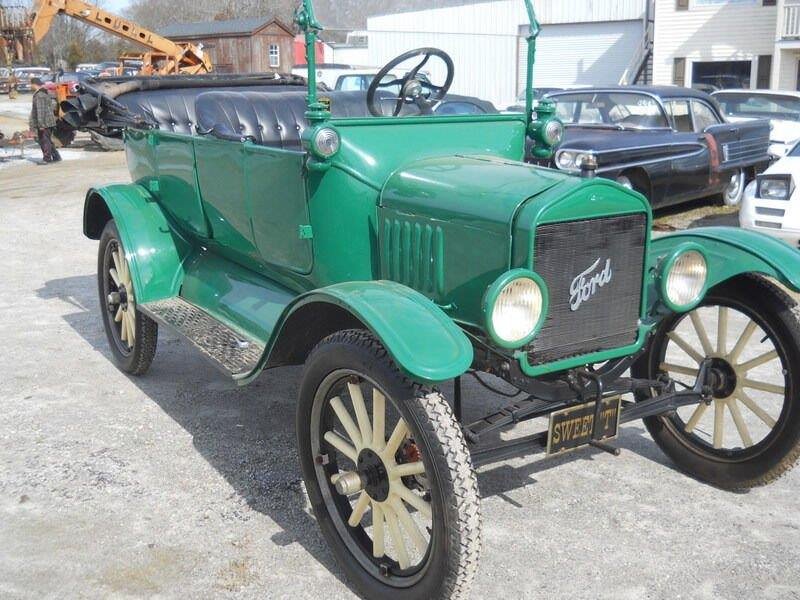

I was wondering if any of y'all could help me put a valuation on a 1919 Ford Model T. Here's the description. He's asking $10,500. Also, any potential pitfalls to be aware of for something like this? I know it is going to need frequent work.
You are looking at a 1919 Ford Model T 3 door touring car! This is a very solid, older restoration, car. It runs and drives very well. Has a very rare speedometer on it. Could stand an new top. Give me a call so we can talk about how we can make my car yours. I feel that my price of $10,500 is very realistic for a collector car like this one with the potential that this vehicle has. Manual transmission.
Thanks for any help you can give on this.

$ 75 to 8500. The Tops going to set you back quite a few quid. Especially if you can’t do it yourself. Some, like me, would use the incorrect color to chew the price down further. I’m going to give you some advice you probably don’t want to hear. First DO NOT buy the car sight unseen and second DO NOT go to look at the car by yourself if you don’t know T’s. The speedometer might be rare and it might not. I leave that to others.

I think $10,500.00 is a little steep. Body looks good. Paint is good but color is not authentic. Tires and spokes look good. Upholstery is rough. With the money you are going to have to invest in a new top, new upholstery, a black paint job and mechanical work that is currently unknown, $8,000.00 would be a more realistic figure. Jim Patrick

Good to know about the top. Charlie, are you saying that the top should match the body color?

No. The color of the body is wrong for the year. Should be all black.

About how much would a new top run me? Also, what kind of labor is involved in installing it? Jim, to be honest, I really like the green. I have a 67 Mustang coupe that was originally dark moss green, and that car has gotten me hooked on green! Black is classic though... Decisions, decisions

While not my first choice for colors, a friend of mine just sold a green 1918 T, their last name is Green! :D

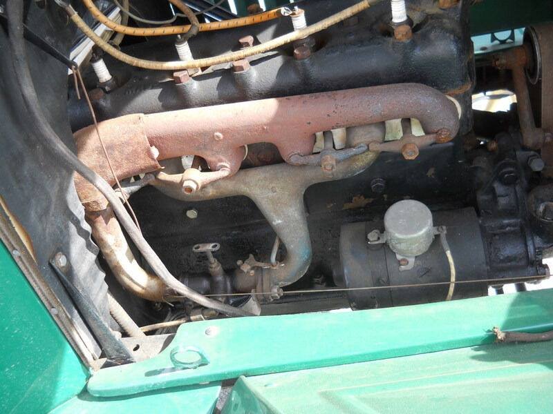

That price is more at the top end and would expect a rebuilt engine, not over hauled, along with proof that the rear end has been rebuilt. The speedometer is not rare, but with the gear not meshed at the front tell me there is binding someplace. It has the stock planetary transmission not manual.
Over all, the car is what I would call ice cream special. Redone on the outside, cleaned up and made to run to do maybe a parade, local car show or wait for it...go get ice cream with the grandchildren. At least that is how I see it without real information on what has done mechanically. Personally I would buy a car more on what has or has not been done mechanically over body and top. If the engine, transmission, magneto, rear end need rebuilt, that is going to run into the $1000's.

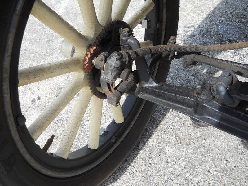

With out being able to see for my self, the wheel wood may be ok or not?

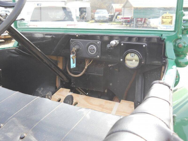

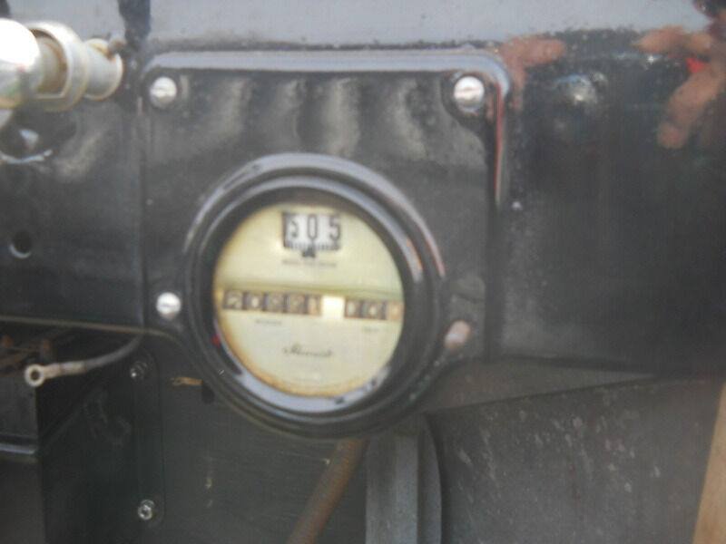

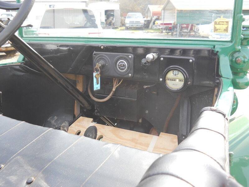

Loose wire under dash - carb mixture control rod missing are little things that scare me because what you can't see may cost a lot.
You asked about top....close to $2,000.00 installed - unless you do the work yourself.
What has been said before...find someone who knows Ts to accompany you when you inspect it and tet drive it.

The color DOES effect the value, whether people like it to or not. The simple fact is, that if a collector car is painted an appropriate/correct color, it will appeal to many thousands of hobbyists and collectors that want their car to be correct. Any collector car painted in a wrong color, will only appeal to the individuals that want THAT incorrect color. The same holds true for many other modifications people make on these cars. Wrong year engines, wrong year wheels, improper upholstery, along with dozens of other things, will have negative impacts on how easy or difficult a car will be to sell, and in turn, its likely sellable value.
If one chooses to buy such a car because they happen to like it? They also assume the future likelihood of difficulties in selling it when that time comes. All too often, a person dies leaving such cars that they personally loved just as they were to families that had been lead to believe in a completely unrealistic value.
Current markets are in a state of flux. Some indications are that prices are heading back up. Many other people fear that prices may crash in the near future. I don't know and will not claim to know the answer to that. However, my personal advice would be to be cautious, but if you can afford it? Buy something (for a reasonable valuation) that you can and would enjoy for some time to come. And then ENJOY IT!
Recent general valuations? A black era (1917 through 1925) touring car in near top condition (not quite 100 point, not Stynoski award worthy) is worth maybe $12,000 tops. A very nice car, paint upholstery, mechanics all basically near top condition, maybe showing a few years of age, should be worth around $10,000. I really do not like knocking other people's pride and joy? However, this car is a step or two below that. Between the wrong color, and the decent and very usable (but not correctly done) upholstery along with a few minor questionable items, makes this car likely worth around what others have already said.

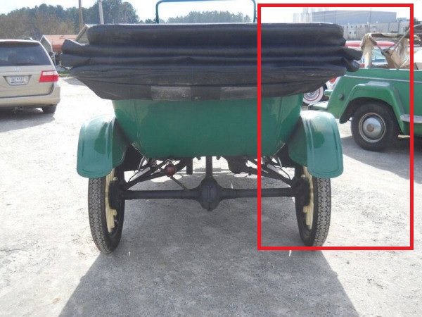

One thing that has not been pointed out (unless I missed it) is that the body on this Model T is not a 1919 body. It is correct for a 1921 through 1923 Model T. They are quite similar to the untrained/uneducated eye. There are also differences in the chassis in the way of the supports for the running boards and possibly holes in the frame rails that I can't see from the photos. The engine serial number could be helpful at least as far a determining the manufacture date of the engine. As noted, the color is incorrect. Plywood floorboards, incorrect. What appears to me to be a cheap, understuffed upholstery job. Any of this matters mostly to the extent that it makes a difference to you. As far as fair market value, my opinion, for what it's worth would be in the $6,000- $7,000 range, assuming that it is mechanically sound.

I would say that the value of the car in no more than 9000.00. For me the color is wrong for the era of the car. Yes I know it’s correct to be black but colors such as wheat, grey and a few others would have been better since they would more era correct.
If the car is a good runner and overall pretty decent it’s worth the asking price to the right guy. BUT the color will be a negative for more than a few people and will be a determining factor for a lower price.

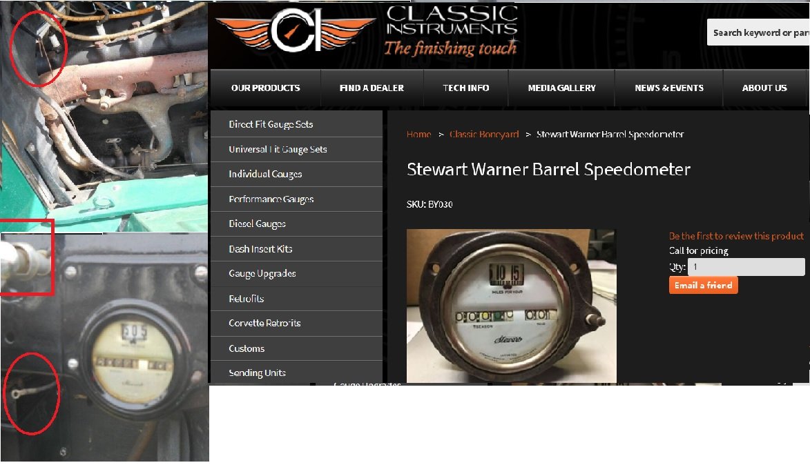

Lets rephrase your question because it isn't about how much the car is worth but how much do you want to invest in this Model T. There may be others available for less. Is the car titled as a 1919 and have you checked the engine serial number to see if its close to a 1919? Remember your buying the car not the speedometer
My first impression is that the car is in a classic car used car lot by the vehicles in the background of the pictures. If the green paint on the T matches the Willies I'd immediately walk away from the deal.
So lets say you budget is $$,$$$t o get the car where you want it and all mechanicals will be 100% perfect after they are taken apart and inspected.
Budget - updates = what the car is worth to you
I'll let the others comment on the cost of the updates.
Inspecting mechanical systems $........
Repainting the T to a color you don't want to explain to 100's of people $.......
New Top $.............
New Seat Upholstery, you install $......
New floor mat $.......
Finishing wood wheel restoration (paint) $....
Labor Cost for what you ill have others do $.......
Contingency for unexpected needs $2000
Other?

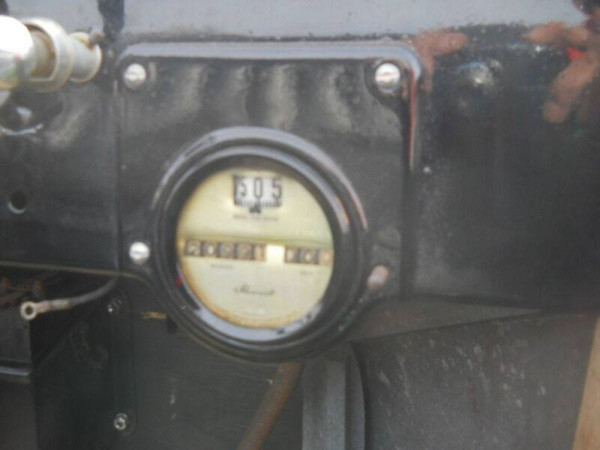

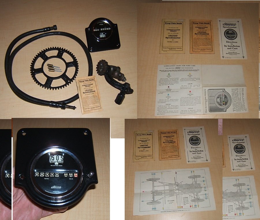

The speedometer may register up to 75mph.
Speedo link (call for price) https://shop.classicinstruments.com/ste ... peedometer
MTFCA Install http://www.mtfca.com/discus/messages/11 ... 1292196239
