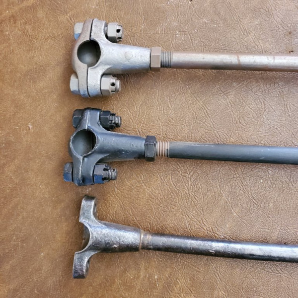

Photo of the 09-10, 11-12, and 13-14 styles

The early 09 had thinner and weaker yokes

Thanks Richard,

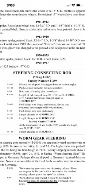

The pin holes drilled in different angles mentioned in the encyclopaedia I cannot see.
The middle one with the course thread would be correct?
Michael A
Michael A
- Posts: 1152
- Last Name: Gould
- Location: Folsom, CA
Re: Early 12 drag link
The middle one is correct for your car. The different placements of the rivets were on the 3rd style shown. The earlier styles did not have rivets.
