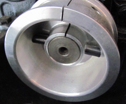

ThreePedalTapDancer
Posts: 1732
First Name: Ed
Last Name: Martin
Location: Idaho
Re: Loose crank pulley repair
Post by ThreePedalTapDancer » Sun Jan 17, 2021 12:12 pm

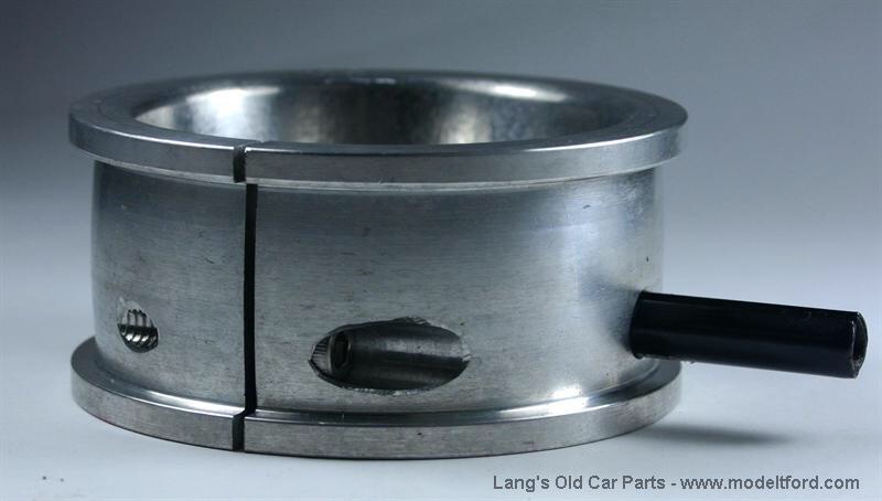

DickC
Posts: 270
First Name: Dick
Last Name: Cruickshank
Location: Angier NC
Post by DickC » Sun Jan 17, 2021 1:17 pm
Since you have a 27 it probably doesn't matter but you may have trouble if you hand crank. If you look at the third picture, notice the distance between the pin through the shaft and the back of the pulley. A lot of times there isn't enough room for the ratchet to grab the pin. Just check it to make sure before you try to crank the engine and have the pawl slip. I had that experience and IT HURTS!!! Dick C.
