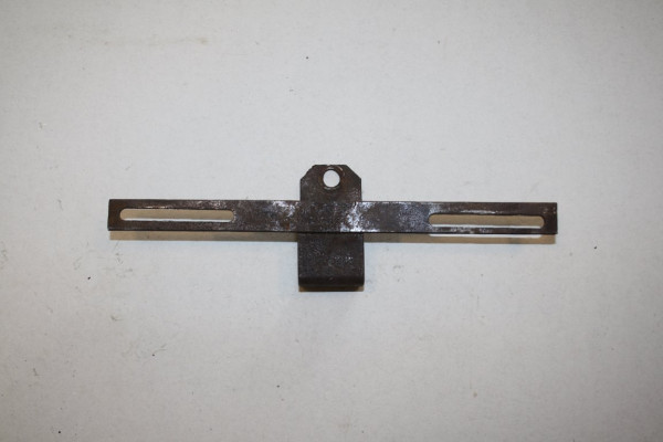

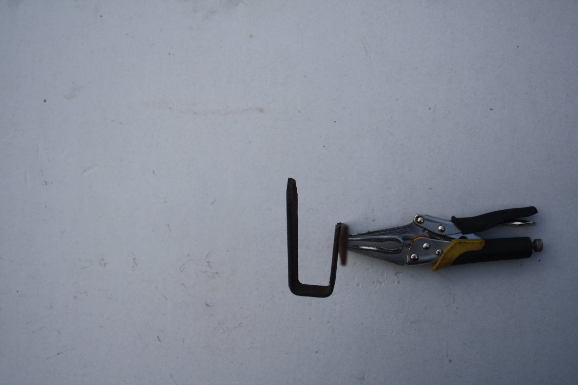

If it was a Canadian car, I had some of those made a couple of years ago that mount the plate just under the left headlight. I might have one available

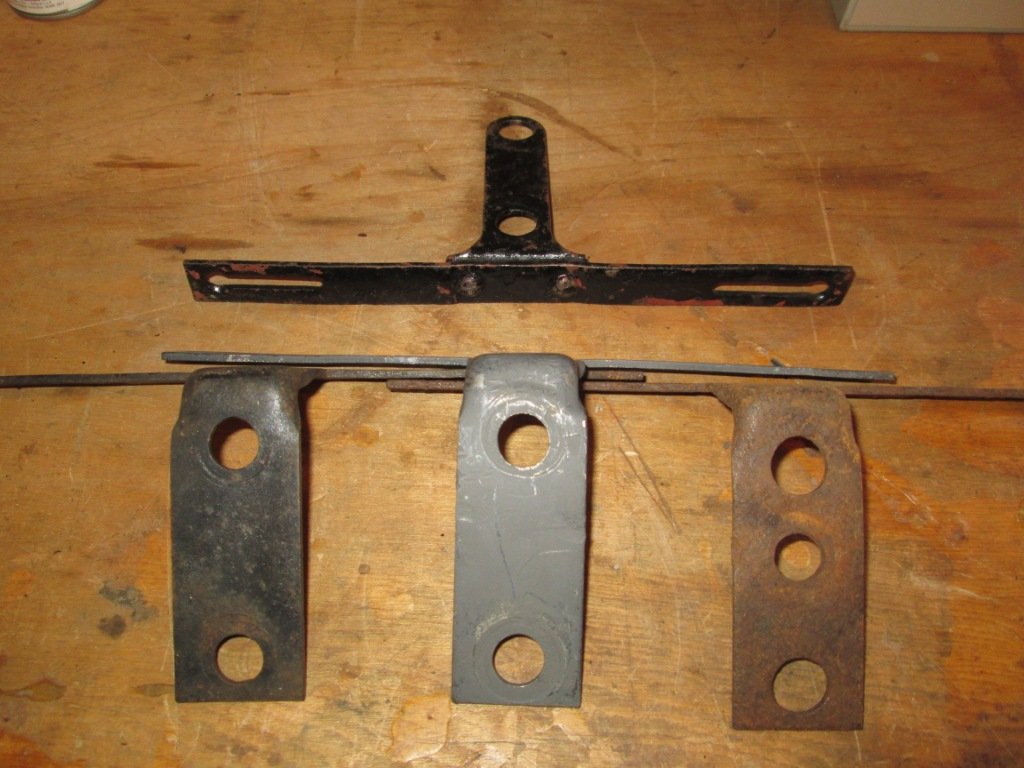

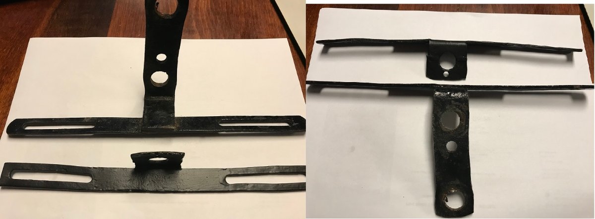

Not sure if the two hole one is correctly constructed
- Posts: 5600
Re: License Plate Bracket on 27 Coupe
These are examples of original Ford front license plate holders sans the early 2 pc. ones. The 3 side by side are stamped '26 - '27 - why the one has an additional hole is puzzling. The single one at top is pre '26.

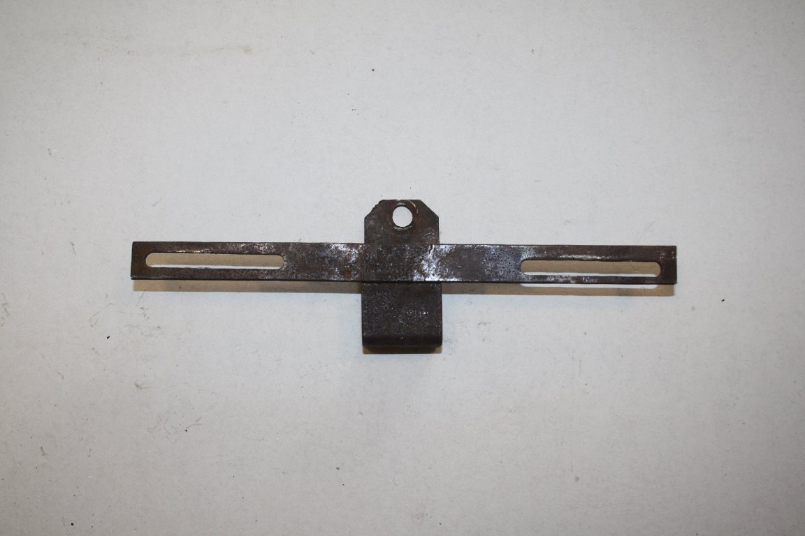

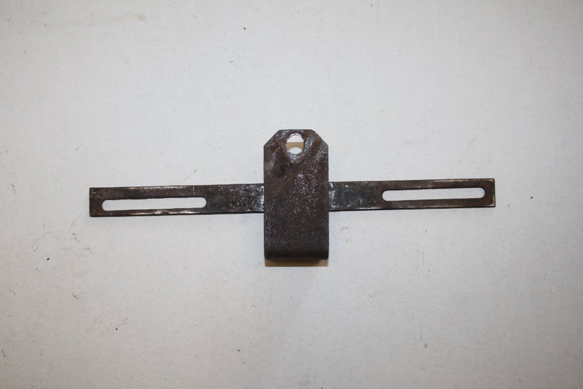

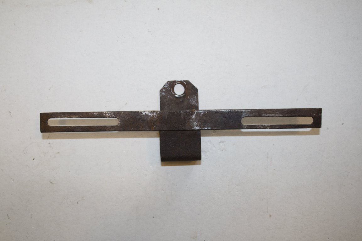

This is my Canadian bracket, if any one would like more detail, I'm here.
